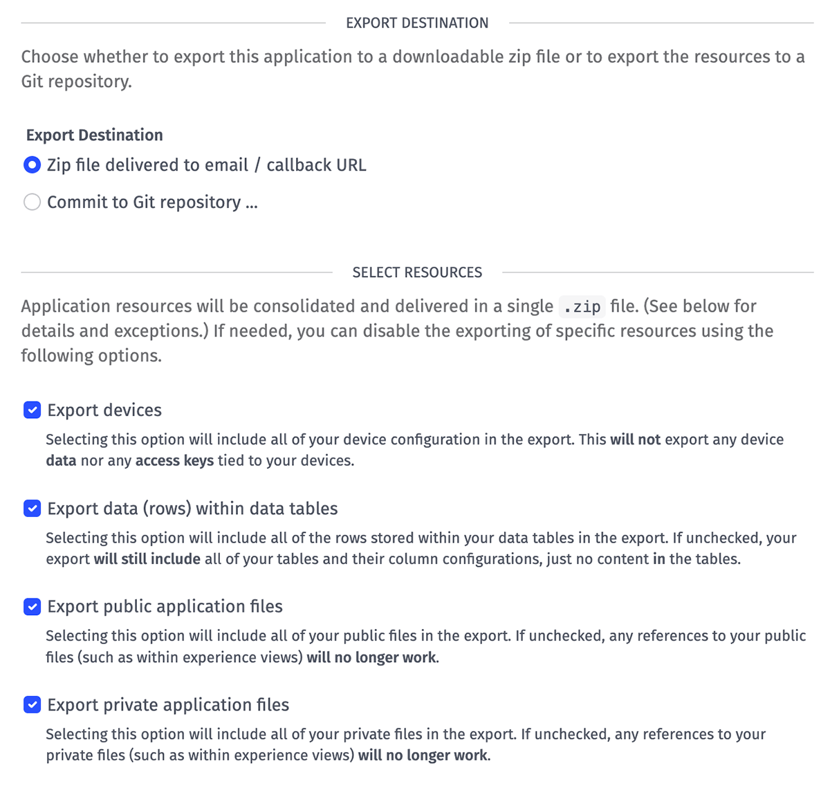

Export Request Settings
Requesting an application export is broken up into the following sections ...
Export Destination
Choose how to deliver the application configuration files generated by the export request ...
- Zip file delivered to email / callback URL: Select this option to deliver a signed URL for downloading a zip file containing the exported application configuration. This is the default selection.
- Commit to Git repository ...: If selected, the resources will be pushed to a Git repository of your choosing. You must provide the following ...
- Credential: Choose one of your application's Git service credentials, which includes the repository to which to commit the resources. If the selected credential includes a Committer Name and/or Committer Email, these will be associated with the export commit.
- Branch Name: Optionally, provide a branch name to which to push the resources. If not provided, this defaults to the repository's default branch.
- Directory in Repository: Optionally, provide a directory within the repository to where the resources should be pushed. This defaults to the root of the repository if not provided.
- Commit Message: Optionally, provide a message to include with the Git commit of the resources to your chosen repository.
Selected Resources
Most application resources are automatically included in the export file. When requesting an export, you may choose whether to include the following resources ...
- Devices: Selecting this option will include all of your device configuration in the export. This does not include any device data nor any access keys tied to your devices.
- Data Table Rows: Selecting this option will include all of the rows stored within your Data Tables in the export. If unchecked, your export will still include all of your tables and their column configurations, but with no content in the tables.
- Public Files: Selecting this option will include all of your public files in the export. If unchecked, any references to your files (such as within experience views) will no longer work.
- Private Files: Selecting this option will include all of your private files in the export. If unchecked, any references to your files (such as within experience views) will no longer work.

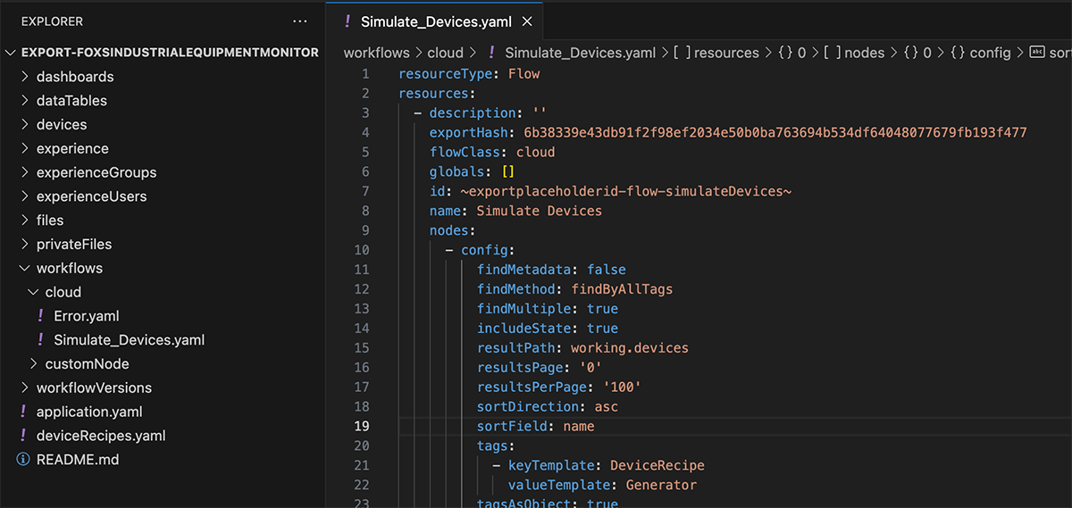

Export Files Format
The export result files are human-readable in YAML format, which makes it easy to independently version control your Losant applications.
Editing the Export Result
You can also directly edit these files if you’d like to make changes manually. A common edit may be to replace actual devices and users with an example set, which can make imported applications a little cleaner.
All exported YAML files, except file resources, will always have two keys resourceType and resources. If you do not have any resources of a specific type, that file will not be exported. If there are multiple files for a specific resource type, there will also be a top-level field called sequenceNumber, which controls the order of importing those files (and the resources in those files).
All IDs are replaced with placeholder IDs, that will be in the format of ~losant-<resourceModelName>-<resourceName>-<number>~.

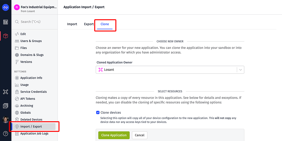

Cloning an Application
If you want to make a near-identical copy of an application, you can clone it. To do so:
- Open the Import / Export screen.
- Select Clone.
- Choose an owner of the application from one of the available options in the drop-down menu. By default this is the organization or Sandbox that currently owns the source application, but this can be changed to any other organization where you have administrator access (or your own Sandbox).
- Optional. Choose whether to clone the following by selecting the checkbox:
- Clone devices: Copies all of your device metadata to the new application. Does not include any device data or access keys tied to your devices.
- Clone data (rows) within data tables: Copies all the data stored within your data tables. If unchecked, your new application will still include all of your tables and column configurations.
- Clone public application files: Copies all of your public files to the new application. If unchecked, links to your public files will stop working.
- Clone private application files: Copies all of your private files to the new application. If unchecked, links to your private files will stop working.
- Click Clone Application.
Cloned applications are still subject to account resource limits, and you are unable to clone an application if the result of the operation causes any of your resources to go over their allowed limits.
