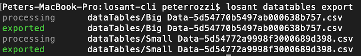

Usage: losant datatables export [options] [pattern]
The export command is used to export you application's Data Tables. To start an export run losant datatables export.
