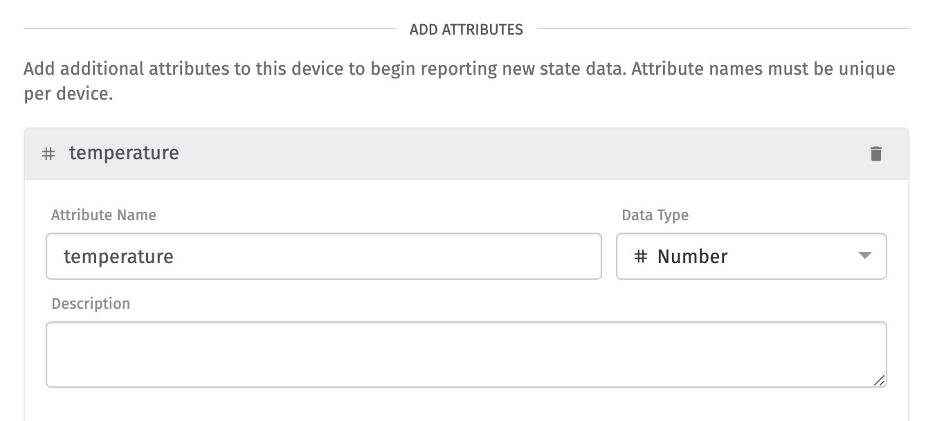

  1. Create a Standalone Device with a “number” attribute called temperature.

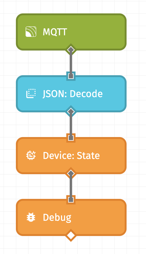

Here is the Application Workflow you will build:
To create this Application Workflow:
  1. Drag the MQTT Trigger onto the workflow canvas. This enables the workflow to listen for custom topics.
  2. Connect a JSON: Decode Node to the MQTT Trigger. This allows you to serialize the MQTT payload properly.
  3. Connect a Device: State Node to the JSON: Decode Node. This allows you to report state from within a Workflow.
  4. Connect a Debug Node to the Device: State Node. This displays the payload in the Debug Panel.

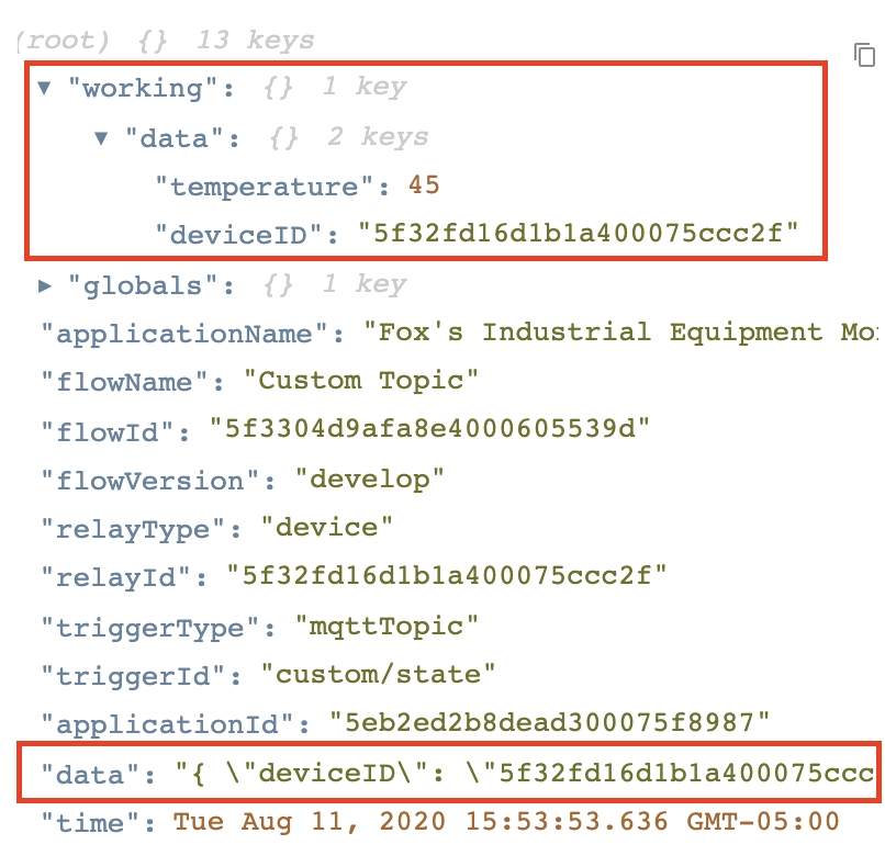

  1. Set the “Source String Path” to data.
  2. Set the “Destination Path” to working.data.
After decoding the value properly, you’ll be able to see the before (data) and after (working.data):

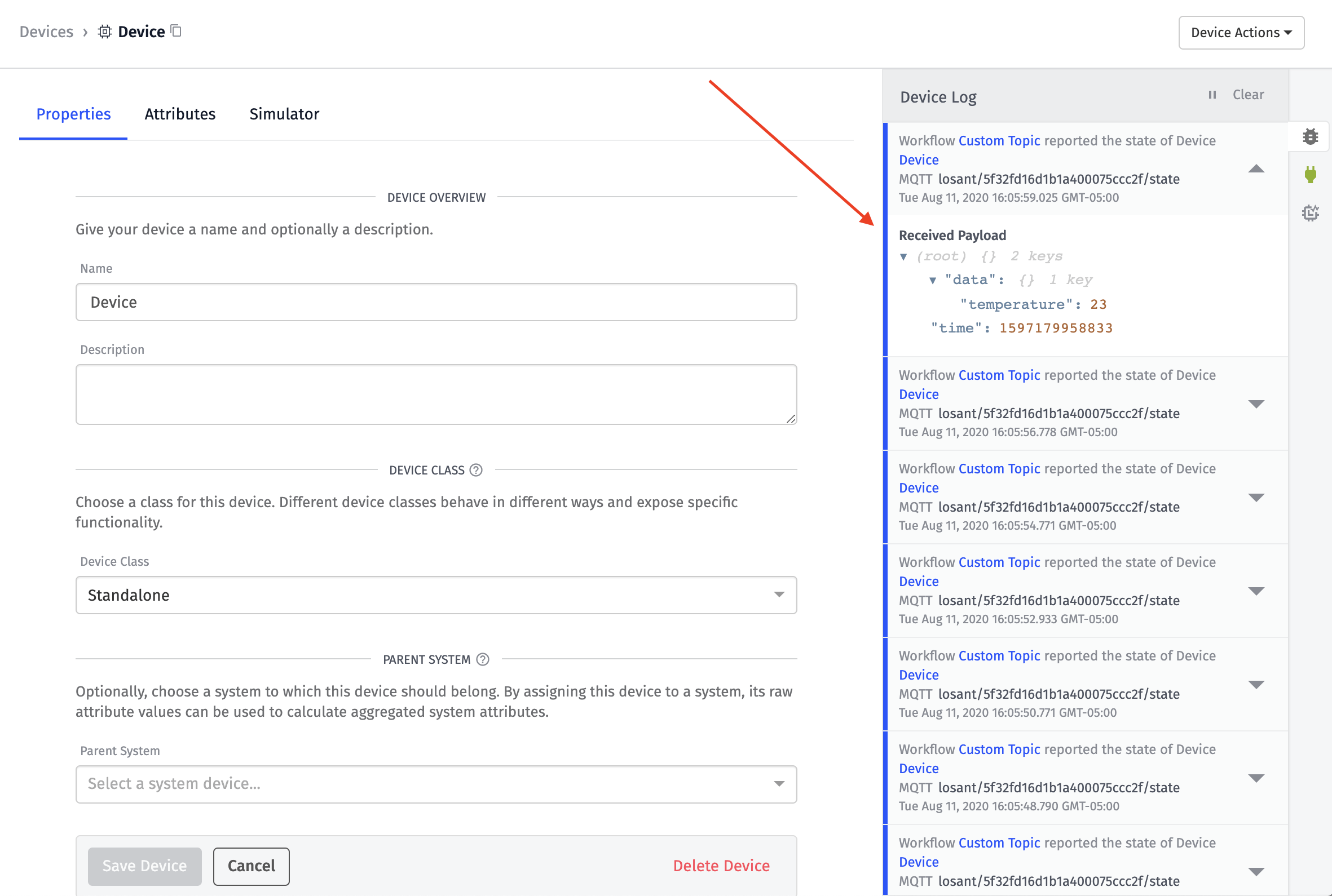

To verify that your workflow is reporting state to your device, look at the Device Log. It displays a real-time stream of events that occur on your device. See below:
Device Log
