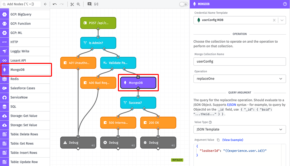

The configuration of the MongoDB Node can be broken down into four major sections - configuring the connection, choosing the operation, setting up the arguments, and choosing what to do with the result.
Connection
Provide the connection URI one of two different ways ...
- Choose a Service Credential ...: When selected, you must provide the name of one of your application's MongoDB service credentials for authentication. For security and ease of use, this is the recommended method.
- Enter connection URI ...: Enter the connection string directly. This must include the host name and database name. It must also include the username and password if the database requires authentication, and it may also require the port.
For Edge Workflows, the connection URI must be entered into the node directly; you may not reference a service credential.
Operation
Next, enter the Mongo Collection Name, which is the name of the collection you wish to operate on. This field supports templates.
Then, choose the operation to perform against the collection. Currently the node has support for the following operations:
- Aggregate (Requires GEA v1.15.0 or higher)
- Count
- Delete Many
- Delete One
- Distinct
- Find
- Find One
- Insert Many
- Insert One
- Update Many
- Update One
- Replace One (Requires GEA v1.15.0 or higher)
- Insert (Deprecated, uses Insert One or Insert Many)
- Remove (Deprecated, uses Delete One or Delete Many)
- Update (Deprecated, uses Update One or - Update Many)
The deprecated methods above will utilize other methods appropriate for your configuration.
Arguments
Depending on the chosen operation, the expected arguments here will change. For example,
with the findOne operation, there are two arguments - the query itself, and any options
for the query. In the above example, we are not passing any options, but we are passing
a JSON template - searching for a document in the collection with a deviceId field that
matches the trigger ID that kicked off the run of the workflow. Most of the arguments for the various operations are expected to evaluate to JSON objects, and the node supports EJSON syntax for specifying things like ObjectIDs.
Both the query argument and the options argument allows users to choose the method by which the value will be set: a payload path, a string template or a JSON template.
Response
Finally, you can optionally choose to store the result of the Mongo operation on the payload. For operations like insert or remove, you might not care about the result, but for an operation like the findOne above, you almost certainly do! In this case the result of the operation is being placed at the payload path working.queryResult.
