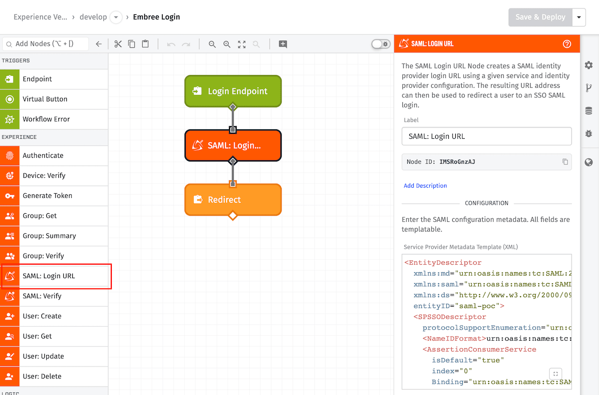

SAML: Login URL Node
The SAML: Login URL Node allows a workflow to create a login URL for a Security Assertion Markup Language 2.0 (SAML) single sign-on (SSO) identity provider.

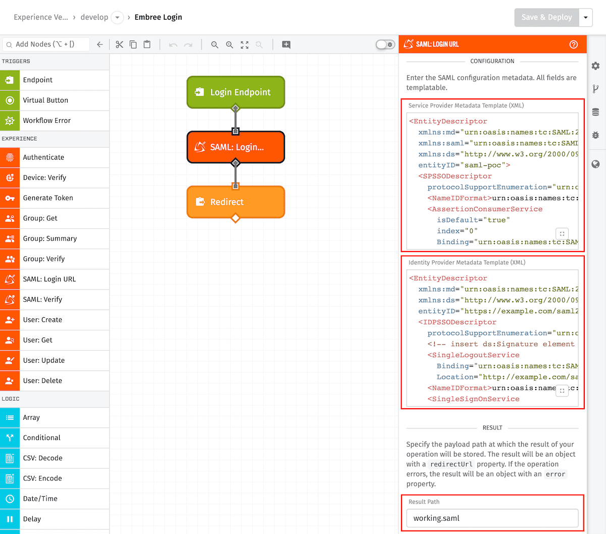

The configuration for the SAML: Login URL Node requires two SAML 2.0 metadata XMLs.
SAML: Login URL Node Configuration
Service Provider Metadata Template​
An XML EntityDescriptor describing the service provider - this field supports templating. Here is an example:
<EntityDescriptor
xmlns:md="urn:oasis:names:tc:SAML:2.0:metadata"
xmlns:saml="urn:oasis:names:tc:SAML:2.0:assertion"
xmlns:ds="http://www.w3.org/2000/09/xmldsig#"
entityID="saml-poc">
<SPSSODescriptor
protocolSupportEnumeration="urn:oasis:names:tc:SAML:2.0:protocol">
<!-- insert ds:Signature element (omitted) -->
<NameIDFormat>urn:oasis:names:tc:SAML:1.1:nameid-format:emailAddress</NameIDFormat>
<AssertionConsumerService
isDefault="true"
index="0"
Binding="urn:oasis:names:tc:SAML:2.0:bindings:HTTP-POST"
Location="http://example.com/saml/assert"/>
</SPSSODescriptor>
</EntityDescriptor>
Identity Provider Metadata Template​
An XML EntityDescriptor describing the identity provider - this field supports templating. Here is an example:
<EntityDescriptor
entityID="https://example.com/saml2/idp/metadata.php">
<IDPSSODescriptor
<SingleLogoutService
Binding="urn:oasis:names:tc:SAML:2.0:bindings:HTTP-Redirect"
Location="http://example.com/saml2/idp/SingleLogoutService.php"/>
<NameIDFormat>urn:oasis:names:tc:SAML:2.0:nameid-format:transient</NameIDFormat>
<SingleSignOnService
Location="https://example.com/saml2/idp/login.php"/>
</IDPSSODescriptor>
</EntityDescriptor>
Result Path​
It is required you specify where on the payload path you want the created SAML login URL to be placed. If the creation is successful it will store the URL in an object with a redirectUrl property at this path. If the URL creation errors, the result will be an object with an error property.
Here’s an example output from running the above workflow ...
