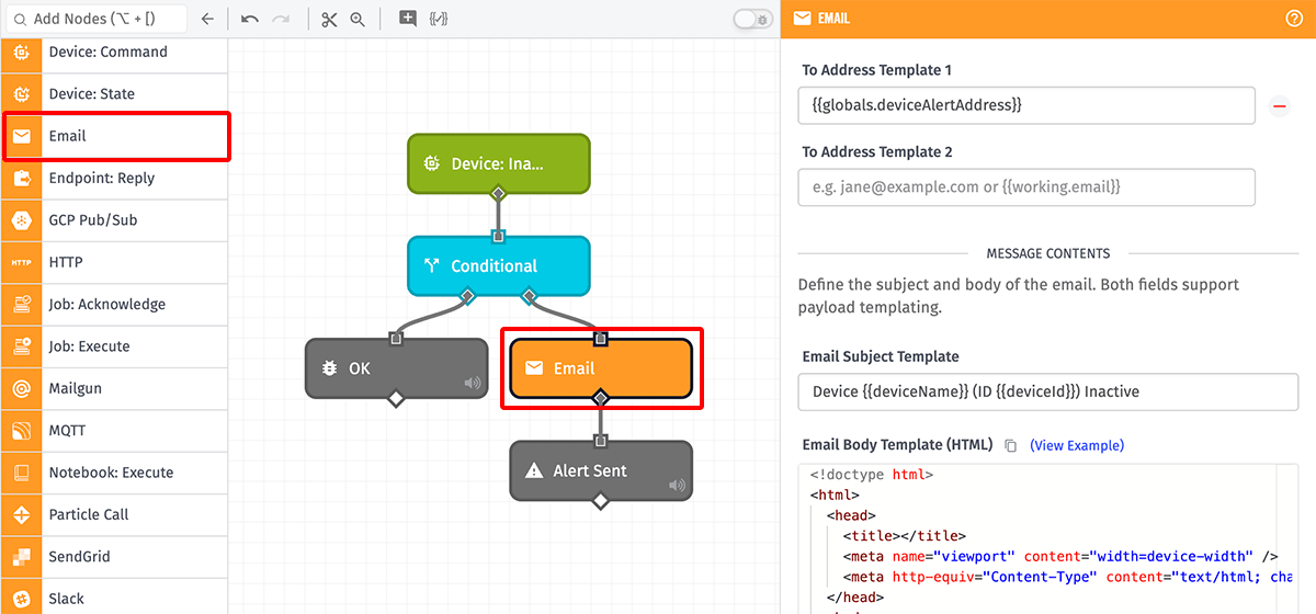

The Email Node allows a workflow to send emails using Losant provided email delivery.
Email Node
The Email Node has three main configuration sections:
Recipient Addresses​
The Email Node supports up to 5 "To" addresses for the email. These address fields support string templates, to use emails on the current workflow payload. The above node is set to send the email to bob@losant.com and hello@losant.com.
Note: The "From Address" cannot be changed when using the Email Node. It defaults to <theWorkflowID>@workflows.losant.com.
Message Contents​
Next, the contents of the email can be configured. There are two items to configure here, and both are templatable.
  • Email Subject: (Required) The subject of the email.
  • Email Body: (Required) The email message to send.
