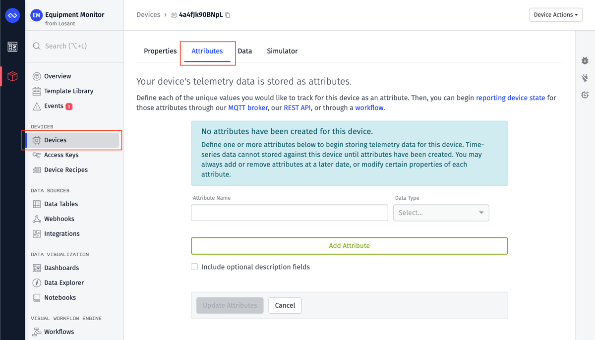

A device's attributes can be viewed, created, and modified by doing the following:
  1. Navigate to a Device page.
  2. Select the "Attributes" tab.
Device Attributes
Creating Device Attributes
Each attribute requires two properties (except system devices and Blobs):
Attribute Name: Must contain only uppercase and lowercase letters, numbers, hyphens (-), and underscores (_).
Many applications will use the same attribute name (such as temperature) across multiple devices. You may perform aggregations on attributes of the same name across devices.
Data Type: Type of data that will be reported against the device. The default value is "Number".
Device Attributes Simple Addition

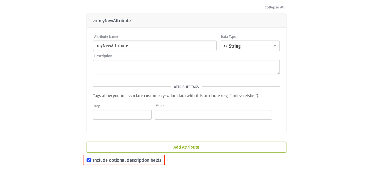

Including Optional Fields
Optionally, you can choose "Include optional description fields" to include an attribute's description and tag fields when creating new attributes.
Device Attributes Include Optional Fields
For system devices, this checkbox is not present and the optional fields are always visible.

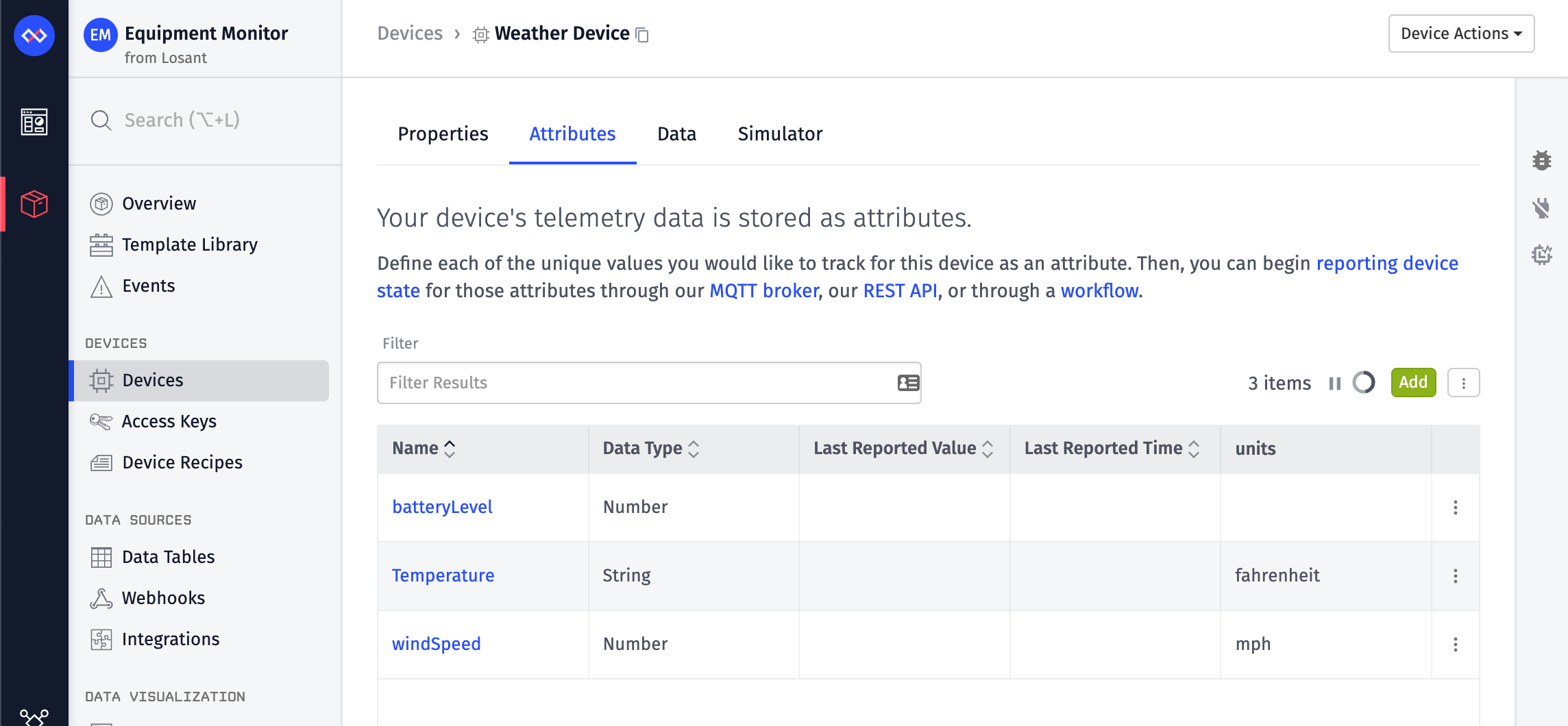

Viewing Device Attributes
After creating an attribute, a device attributes table will be displayed showing the attribute name, data type, last reported value, and last reported time. The attributes last reported value and time will be refreshed every 30 seconds. You may also perform a manual refresh.
Depending on the data type of the attribute, the last reported value may be formatted differently. For example, a boolean attribute will be displayed as either True or False. A number attribute will be displayed as a number, and a string attribute will be displayed as a string. A blob attribute will be displayed as a link to the blob. A GPS attribute will be displayed as a link to Google Maps.
Attributes Table
In the case that you have a large number of attributes, you may filter the attributes that are displayed by entering the name of the attribute in the text input located above the table.
You will also be able to add, edit, and delete existing attributes from this table as long as you have collaborator or higher permissions.

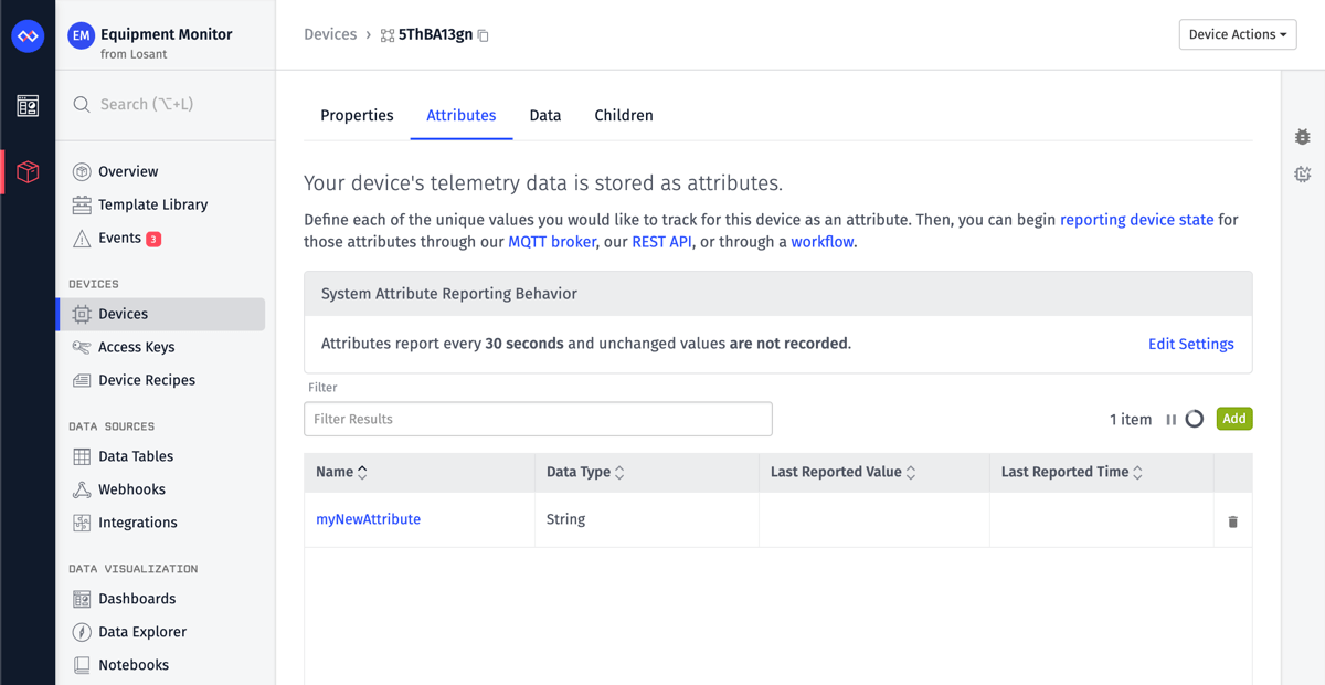

A System device also displays the current "System Attribute Reporting Behavior" setting shown below.
System Device Attributes Table

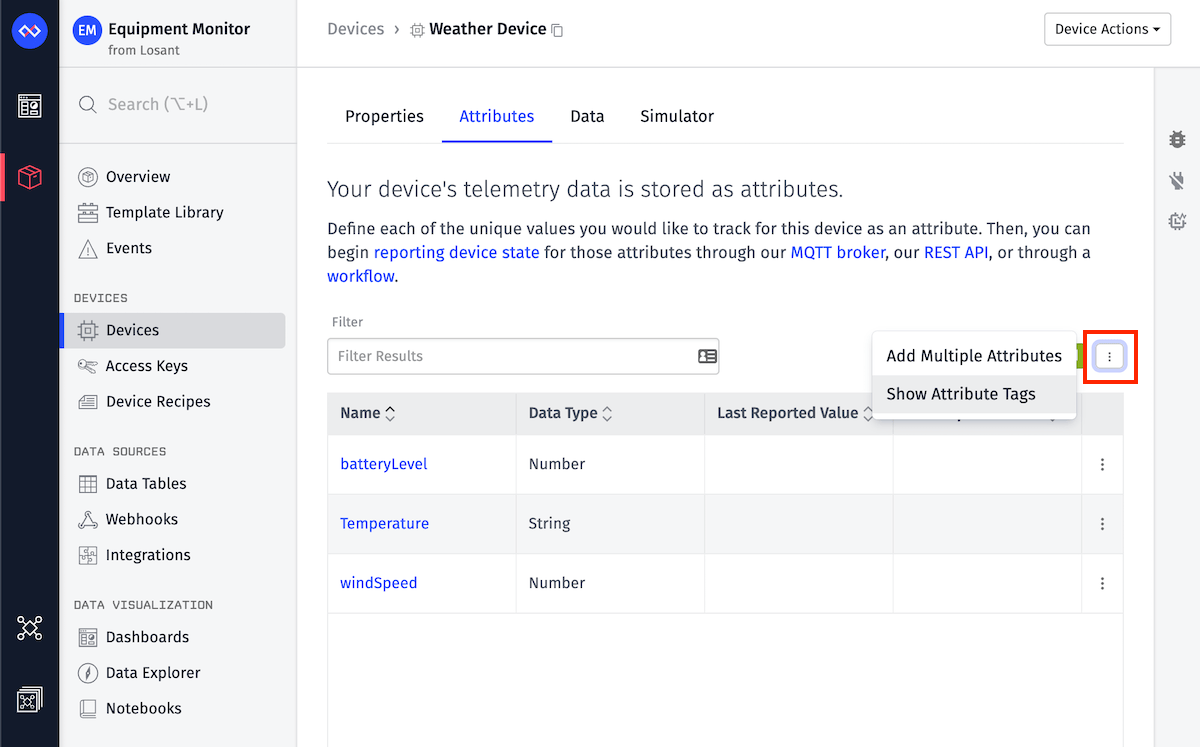

Viewing Attribute Tags
Show Attribute Tags
If you'd like to view all of your attribute tags at once, you can click the dropdown menu icon at the top right of the table and select "Show Attribute Tags".
Attribute Tag Columns
The table will now show columns for each attribute tag key that has been created. If an attribute has a value for a given key, it will show that value in its respective row.
To hide the tag columns, reopen the dropdown menu and select "Hide Attribute Tags".

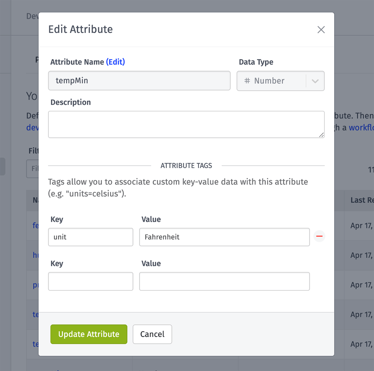

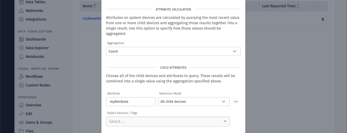

Modifying Device Attributes
Click on the attribute name displayed in the table to view the attribute's details. From here, you may change several properties of the attribute ...
Edit Attribute
  • Name: It is possible to change the attribute's name, but doing so may lead to breaking changes in your application.
  • Description: A description may be added, modified, or removed.
  • Content Type: Blob attributes allow for changing their content type.
  • Attribute Tags: Attribute tags can be added to or removed from the attribute, and existing tag keys and values may be modified.
  • System Attribute Calculation: System device attributes allow for modifying the behavior for calculating an attribute's value, including its Aggregation Method and Child Attributes (the names of the child attributes and the child devices to pull the values from).
Edit System Device Attributes
Note: An attribute's data type cannot be changed after creation.

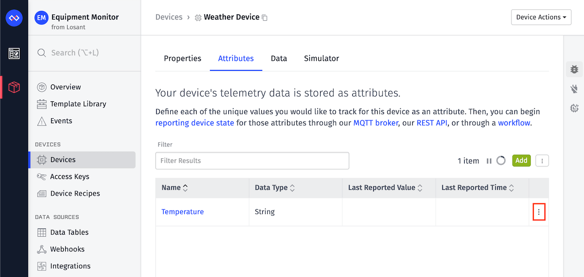

Deleting Device Attributes
Warning: Deleting an attribute from a device removes all data that has been reported against that attribute for the device.
To delete an attribute:
  1. Click the dropdown menu icon at the right edge of the attribute's row.
  2. Click the "Delete Attribute" option. This will display a confirmation modal.
Delete Attribute

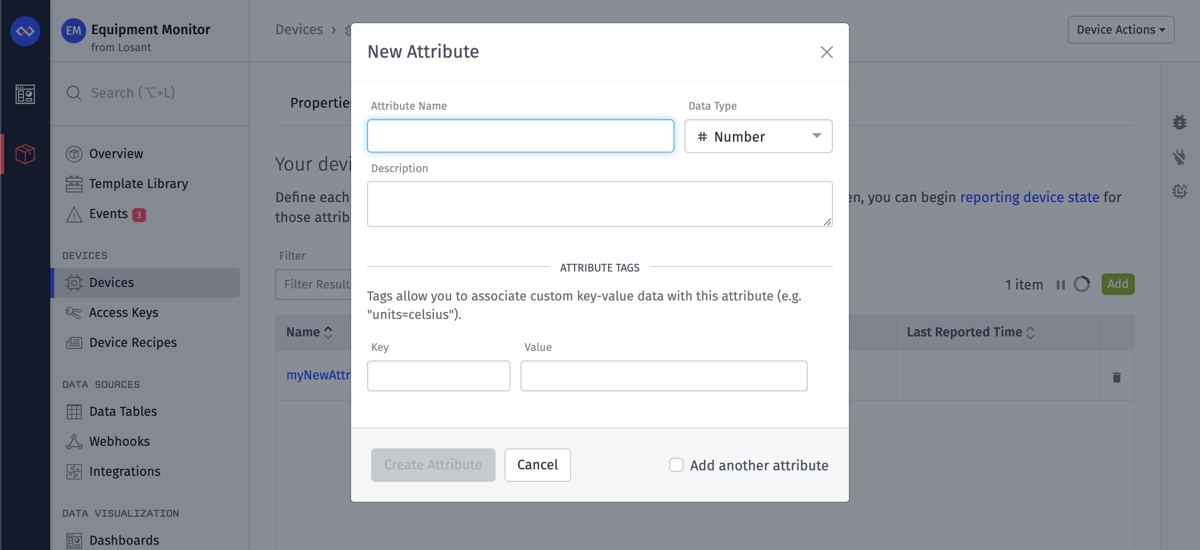

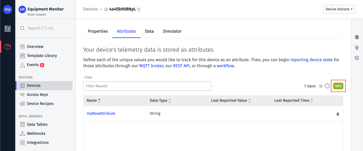

Adding Additional Attributes
Click the "Add" button located above the attributes table over on the righthand side of the screen to add a new attribute.
Add Attribute
A new attribute form will be displayed where you can enter the attribute name, data type, description, and attribute tags. For system devices, you can select the aggregation method for the last reported value of each child device attributes. After selecting the aggregation method, you can to choose which child device attributes to include in that calculation.
Clicking on "Add another attribute" checkbox will allow you to add additional attributes without closing the modal after submission.
Add Attribute Modal

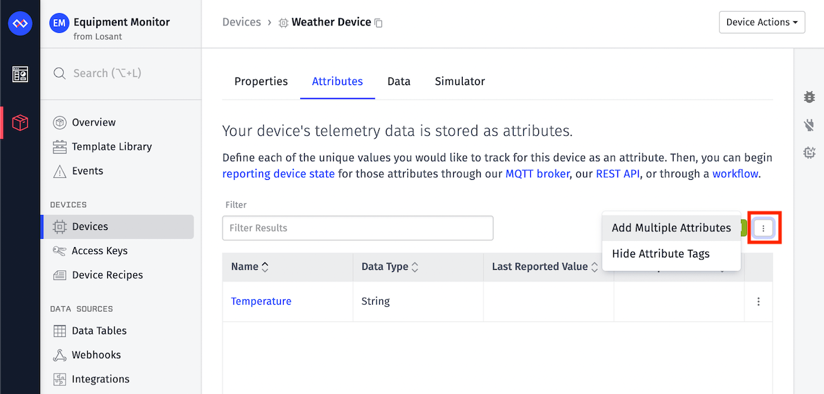

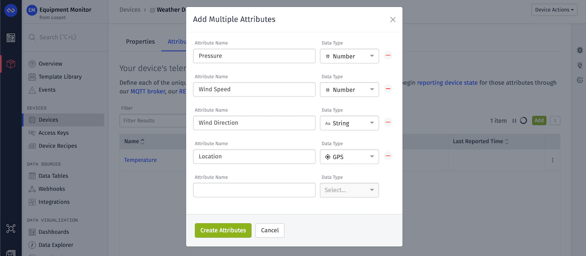

Adding Multiple Attributes
Multiple Attributes Button
If you wish to quickly create multiple attributes at once, click the dropdown menu icon at the top right of the table and select "Add Multiple Attributes". This option is only available for non-system devices.
From here you may define the name and type of each attribute you are adding.
Note: You will not be able to define attribute descriptions or tags via this method; however, you may modify the attributes after submission to add these properties if necessary.

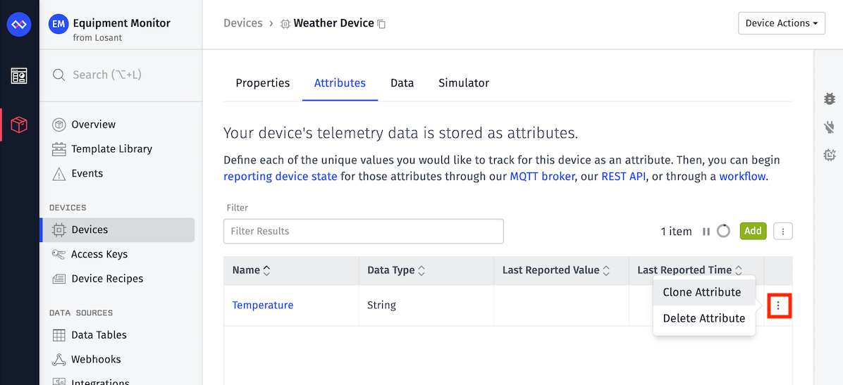

Cloning Attributes
Clone Attribute
To clone an existing attribute, click the dropdown menu icon at the right edge of the attribute's row. From there you may click "Clone Attributes". This will open the "New Attribute" modal with all but the name field prepopulated.
