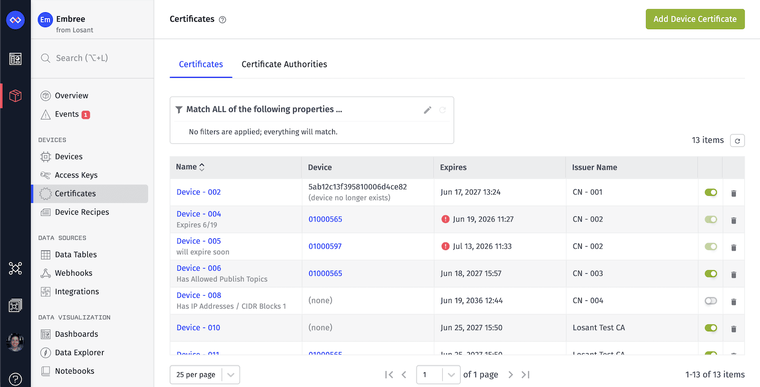

Viewing Certificates
You can view your device certificates for an application by choosing "Certificates" in the application subnavigation. By default, the "Certificates" tab is selected. The list includes each certificate's name (or the "Common Name" if a name is not explicitly set), associated device, expiration date, issuer name, and status (active/inactive). You can click on any certificate to view more details about it.
Certificates support advanced queries for filtering the list by several properties, including issuer name, associated device, topic restrictions, and more. See the Device Certificates advanced query schema for more information.

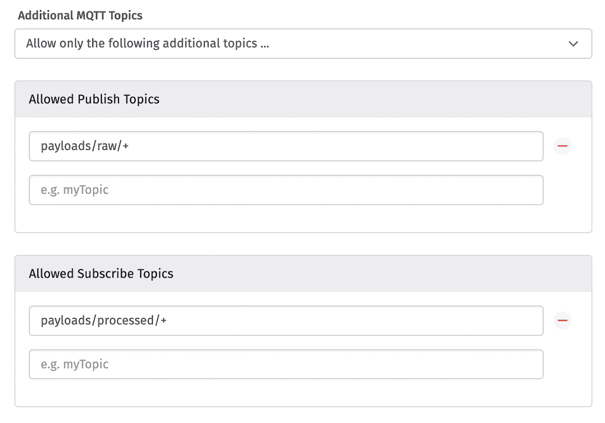

Additional MQTT Topics Access
By default, certificates only allow access to the device-specific MQTT topics (e.g. state and commands) for the associated device. Optionally, you can specify multiple non-device MQTT topics that a client authenticating using the certificate should have access to. Select one of the following Additional MQTT Topics options:
  • Allow all additional topics: Allow access to device-specific topics and all custom topics.
  • Do not allow any additional topics: (default) Allow access to only device-specific topics.
  • Allow only the following additional topics ...: Allow access to device-specific topics and only the listed custom topics.
  • Allow all except the following topics ...: Allow access to device-specific topics and all except the listed custom topics.
If you choose "Allow only the following additional topics ..." or "Allow all except the following topics ...", you will also need to provide a list of allowed/disallowed Publish Topics and/or a list of allowed/disallowed Subscribe Topics. Each value must be a valid MQTT topic, and furthermore, they cannot be MQTT system topics (prefixed with $SYS), or Losant-specific topics (e.g. losant/DEVICE_ID/state).
Additional MQTT Topics Access List

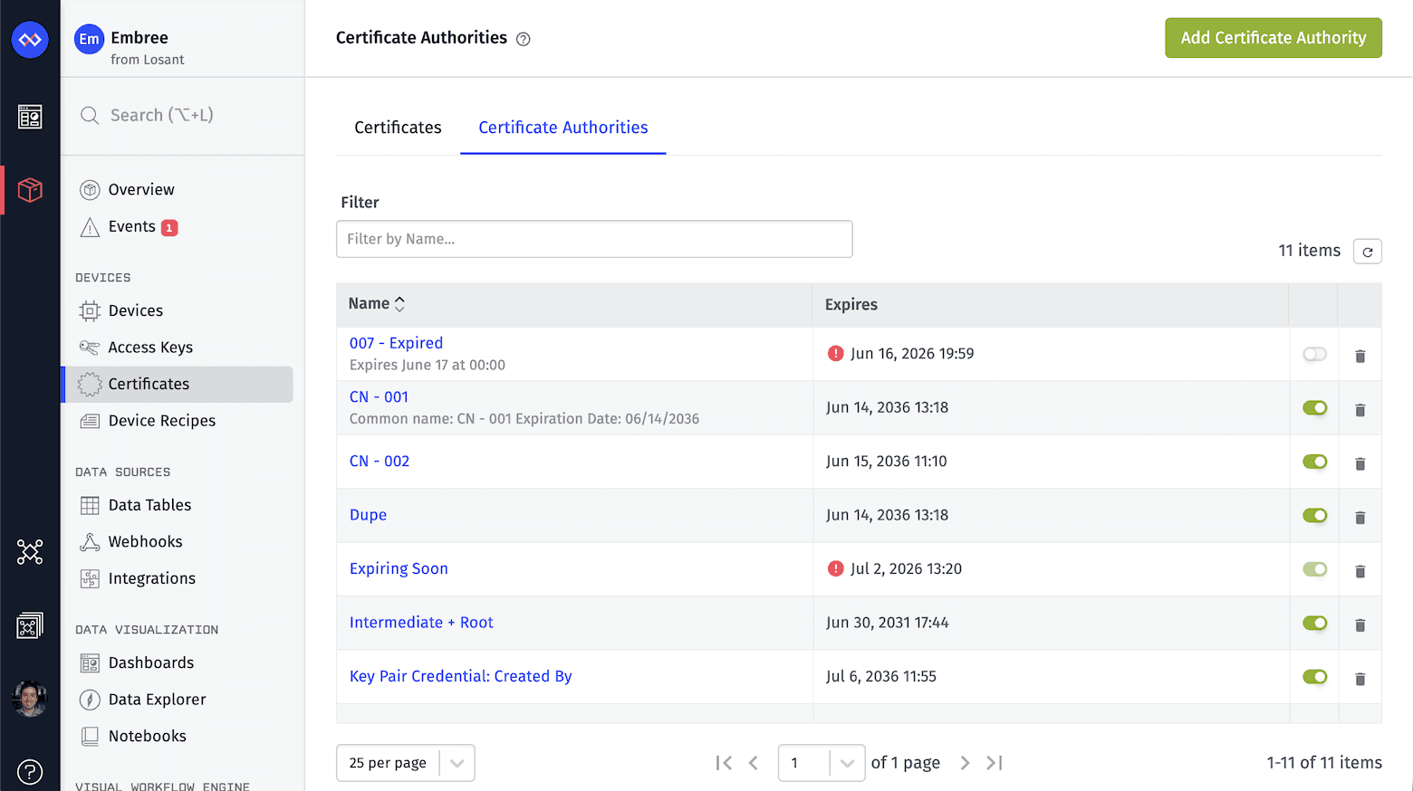

Viewing Certificate Authorities
A list of your application's certificate authorities is available by choosing "Certificates" in the application subnavigation, and then selecting the "Certificate Authorities" tab on the list page.

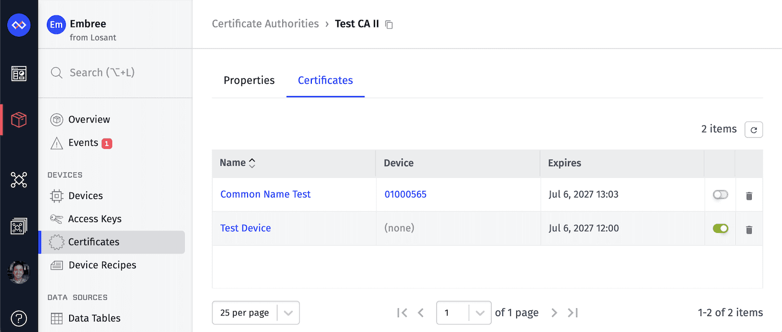

Viewing Signed Certificates
From a certificate authority's detail page, you may view any device certificates that were signed using that authority. This is helpful for quickly identifying affected certificates when, for example, a certificate authority is approaching its expiration date.
Device Certificates Signed by CA
