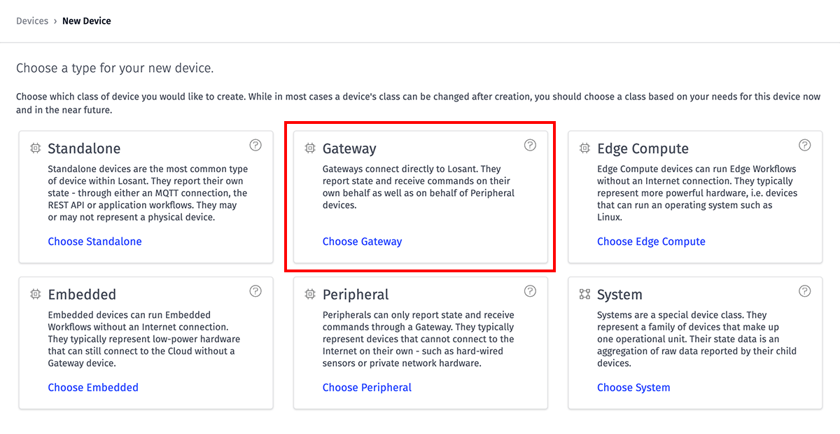

A basic gateway device is created by choosing the Gateway device type when adding a new device. For more advanced use cases, devices of the Edge Compute device type can also function as gateways.
Add Gateway

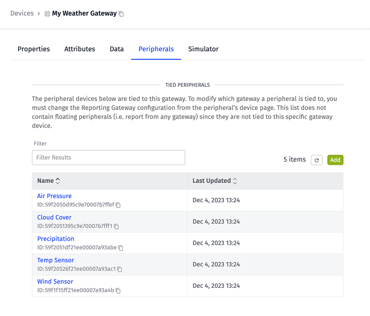

When viewing a Gateway or Edge Compute device, a list of all Peripheral devices associated that device are available under the "Peripherals" tab. This list does not include any "floating peripherals" (those that allow "Any Gateway" to report on its behalf).
Peripherals List

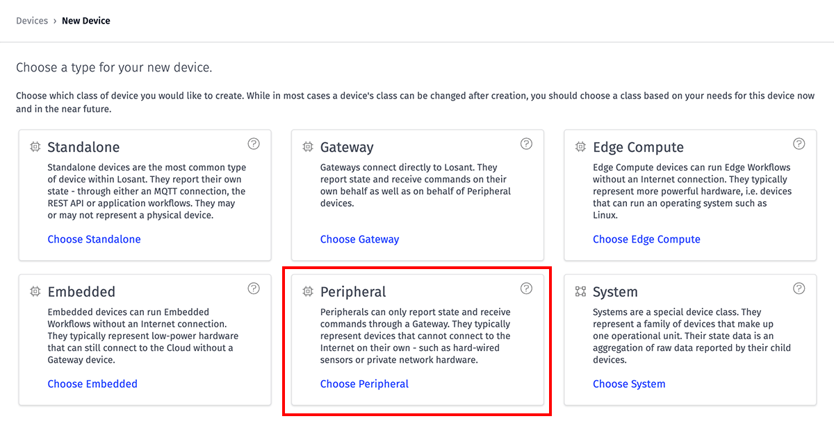

Peripherals are created by choosing the Peripheral device type when adding new devices.

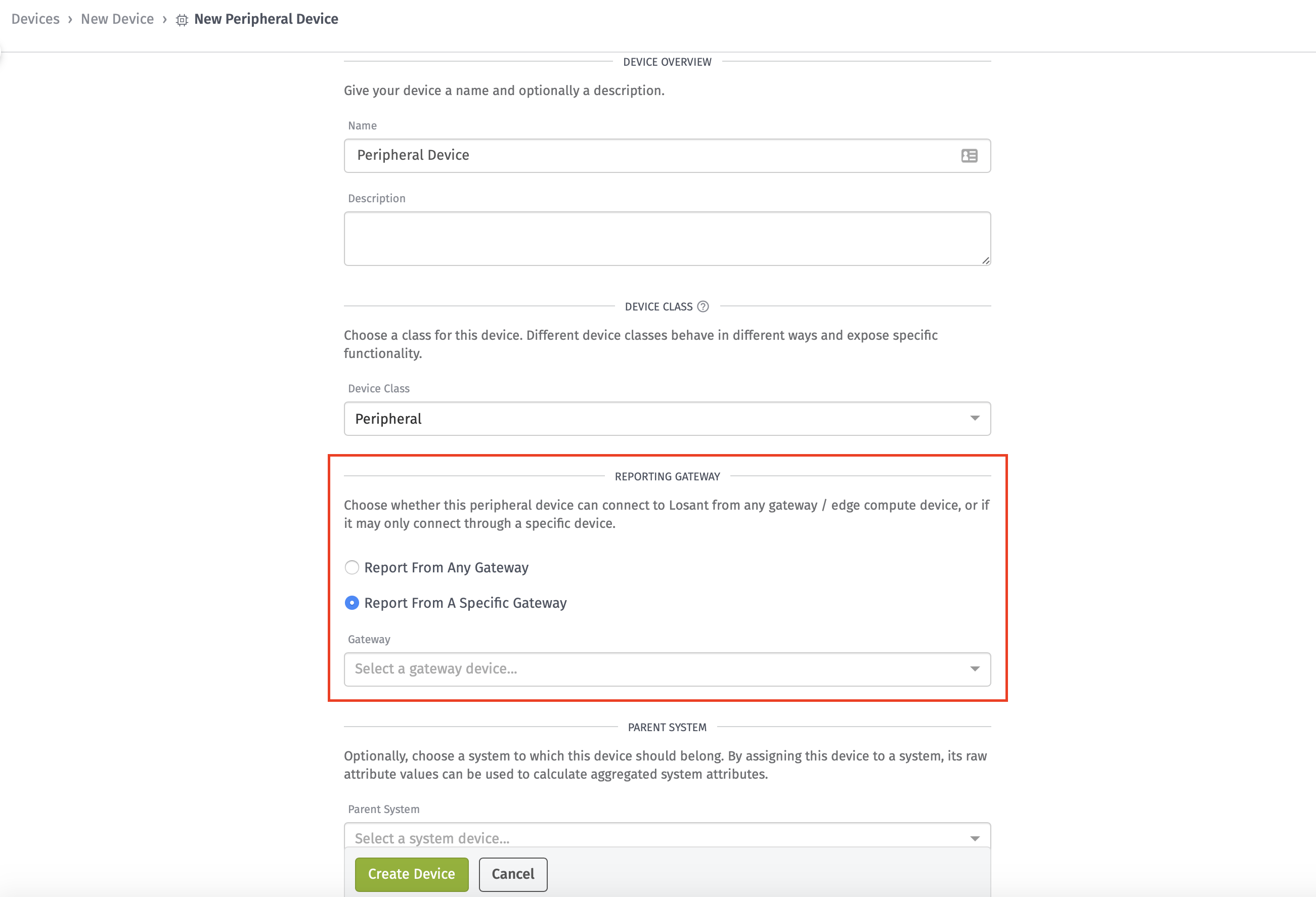

You can then decide if the peripheral device should be allowed to report its state through any gateway within the application, or if state reporting should be restricted to only a particular gateway. "Any Gateway" is generally used for peripheral devices that move, and so might switch between statically located gateways at multiple locations. "Specific Gateway" is generally used for a peripherals that are attached to a single gateway, perhaps even actually physically attached.
Peripheral Configuration
