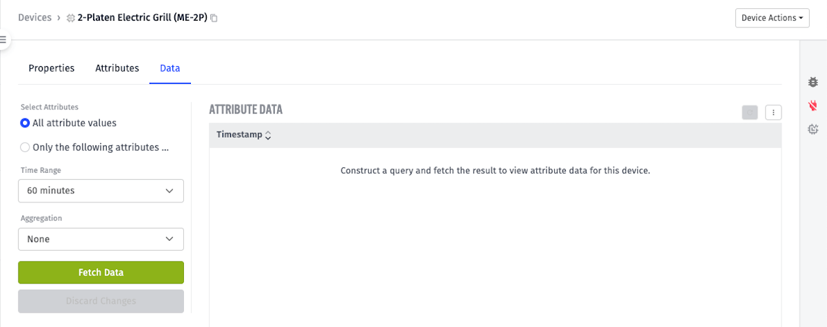

Device Data Tab
Device Data Tab
To quickly view a device's past reported states, you can navigate to the Data tab available in the device's detail page. From here you can construct a data query for specific attributes, time ranges, and optionally an aggregation method. Clicking Fetch Data will display the results of your query in the table, after which you may sort the values, export the data, or delete data.
Data Actions
Device Data Actions
Once you have constructed a query and returned data, you may perform several different actions on the returned data. By clicking the dropdown menu in the top right of the table, you can download the table contents to a CSV file, or you can delete all the data presented in the table.
Clicking the "remove" icon in any one of the table's rows allows you to remove that specific data point. Removing a singular data point is unavailable when querying aggregated data.
Note: If you are querying a subset of the device's attributes, deletion will only occur for those attributes you are viewing (i.e. when viewing a specific subset of attributes a data point may have contained data for other attributes not in the query. The data of those other attributes will not be affected).
