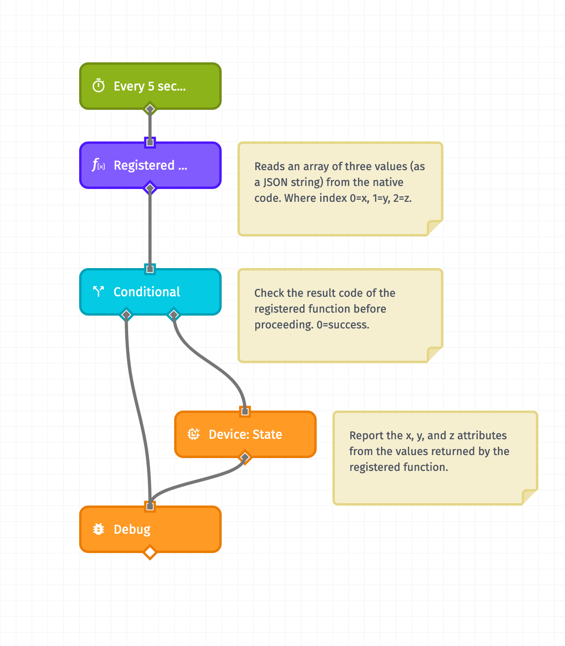

Working with Registered Functions
Registered functions provide a way for your workflows to invoke any custom function defined by your application code. One of the most common uses for registered functions is to receive data from system resources (e.g. files) or attached sensors and peripherals (e.g. an accelerometer).
Registered functions are defined like any other imported function:
def eea_fn_read_accelerometer(
out_ptr_readings_str:int,
str_buffer_len:int,
out_ptr_readings_len:int) -> int:
print("eea_fn_read_accelerometer")
encode_string(
memory, "[0, 1, 1.5]", out_ptr_readings_str,
str_buffer_len, out_ptr_readings_len)
return 0

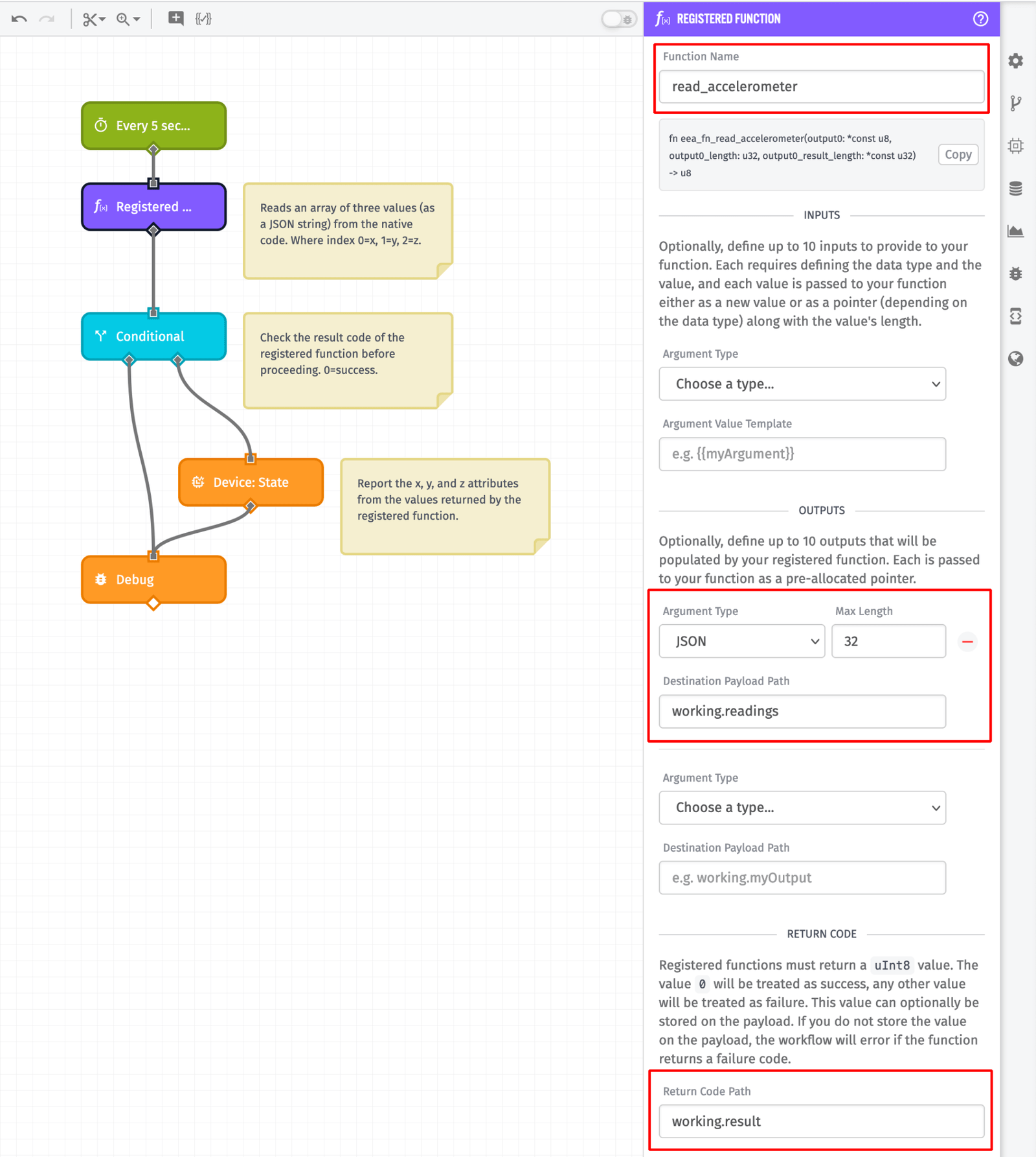

The required signature for a registered function depends on its inputs and outputs. For details, please review the documentation on registered functions. To avoid potential name conflicts, all registered functions must be imported with the prefix eea_fn_. In the workflow editor, when configuring the Registered Function Node, you will not include the prefix, so the function name field would be set to just “read_accelerometer”.
EEA API Bundle workflow with Registered Function configuration highlighted
Registered functions have both inputs (receive data from the workflow payload) and outputs (provide data to add to the workflow payload). Registered functions also have a return code, which can indicate whether or not the function was successfully executed. A return code of 0 indicates success and your application can return any other number (1-255) as a custom error code. (Note: Losant utilizes a set of error codes for internal use, and they should be avoided if possible.)
This registered function has no inputs and a single output. We’re expecting this function to output a JSON string that is no larger than 32 bytes. Let’s look again at the signature of this registered function and how it maps to the node’s configuration:
str_buffer_len:int,
As we described in Understanding the WebAssembly Memory Model, it’s not possible for complex types like strings to directly pass between the EEA and your application code.
To output a string from your code, the EEA provides you a pointer (out_ptr_readings_str) to the location in memory where your code should place the string. The EEA must pre-allocate this memory, and the amount it allocates is defined by the Max Length field in the node’s configuration, which is set to 32 (bytes) in the screenshot above. This length is also provided to your code (str_buffer_len) so your code can ensure it does not attempt to write more bytes than what has been allocated (i.e. a buffer overflow).
For the EEA to decode this string, it also needs to know how many bytes your code actually wrote to the buffer. Even though we allocated 32 bytes, your code is not required to use all 32. To accomplish this, the EEA provides you another pointer (out_ptr_readings_len) which is the location in memory where your code must encode a 32-bit unsigned integer that contains the number of bytes written.

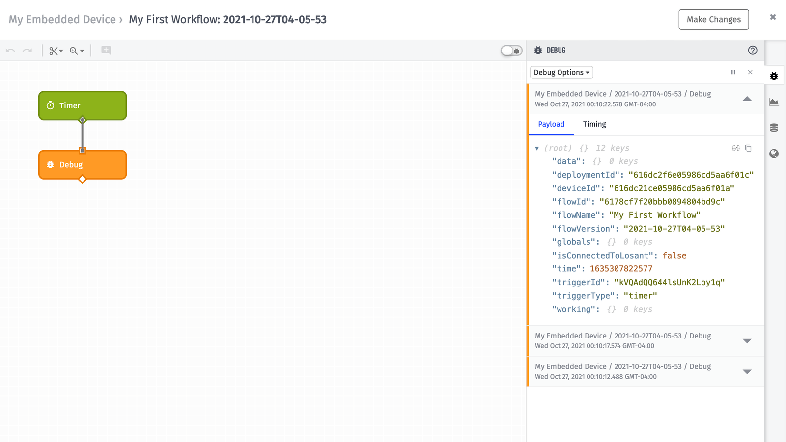

Deploying Your First Embedded Workflow

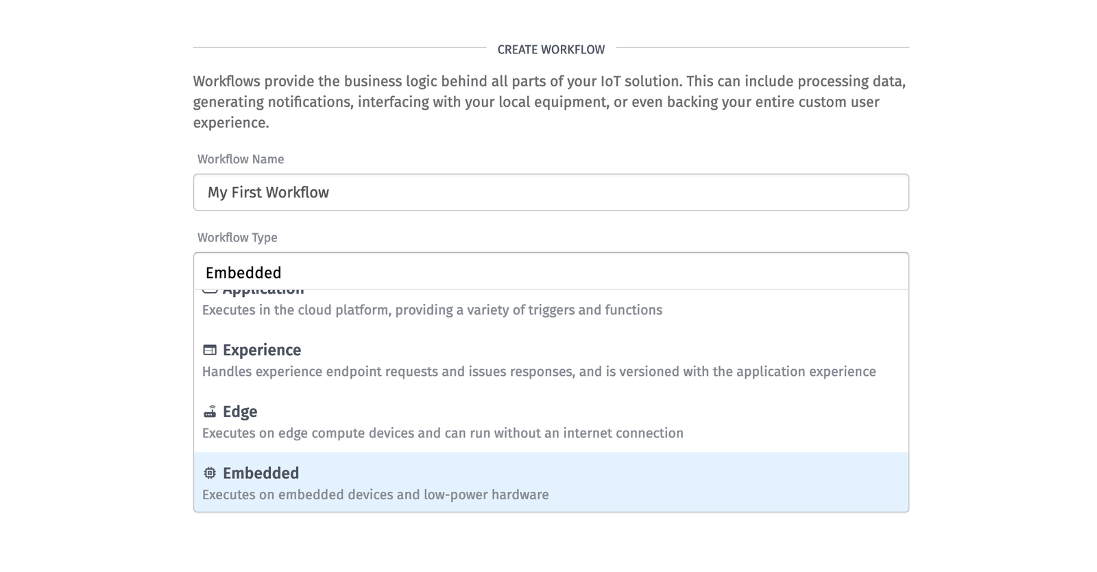

For this step, we recommend starting with a simple workflow and no registered functions. The goal is to make sure the deployments are working with no added complexity. The recommended workflow is only two nodes: a Timer Trigger and a Debug Node.

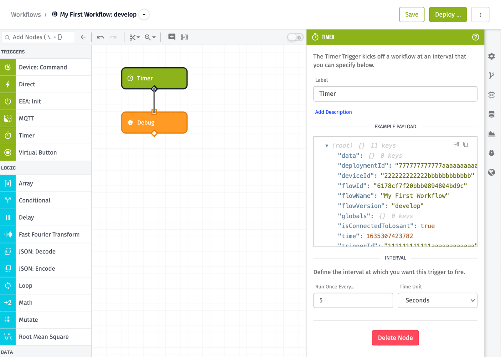

To do this, navigate to the Workflows main menu and click the Add Workflow button at the top right corner. You can name the workflow anything you’d like and make sure Embedded is selected as the workflow type.
Create Embedded type workflow
On the workflow canvas, drag and drop the Timer Trigger and set it to to every 5 seconds. Next, drag a Debug Node on the canvas and connect it to the Timer Trigger.
First Embedded Workflow Overview

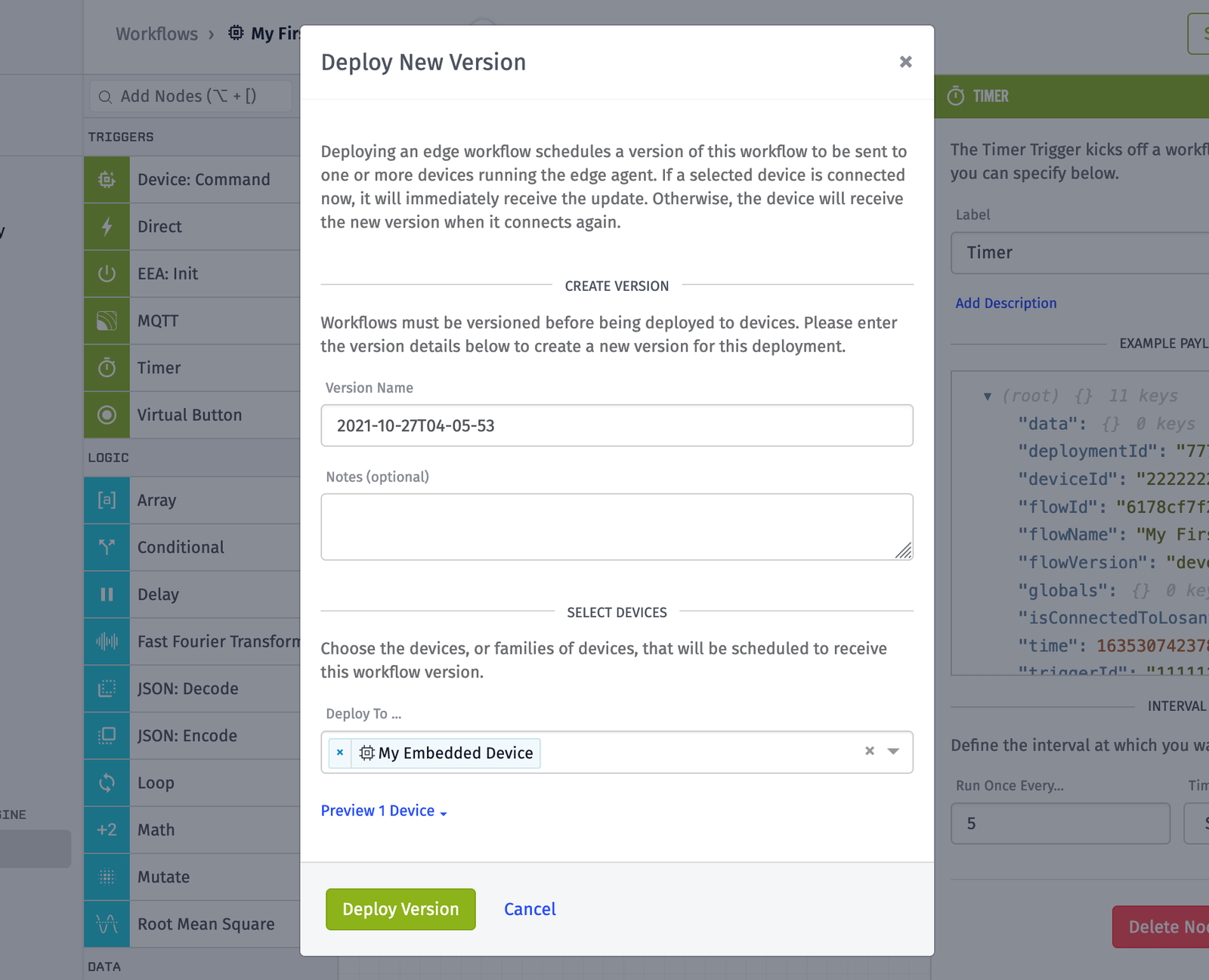

This workflow is now complete, so click the Deploy button at the top right corner of the screen. On the resulting dialog, select your device and click the Deploy Version button.
Deploy first embedded workflow

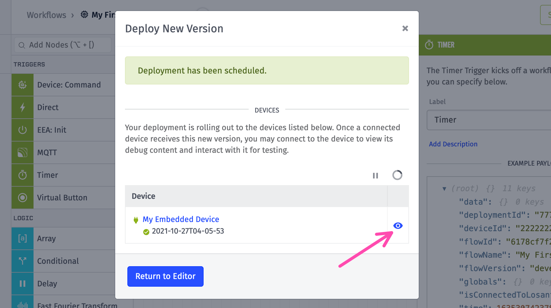

Deploying an EEA bundle can take 20 to 30 seconds due to the WebAssembly compilation process. Once the deploy is complete, you can click the Live Look button to see the debug log entries coming from your workflow back to the Losant platform. You will also see a stream of console output coming from the Python application.
Deploy successfully scheduled, click live look
First embedded workflow live look with debug payload
