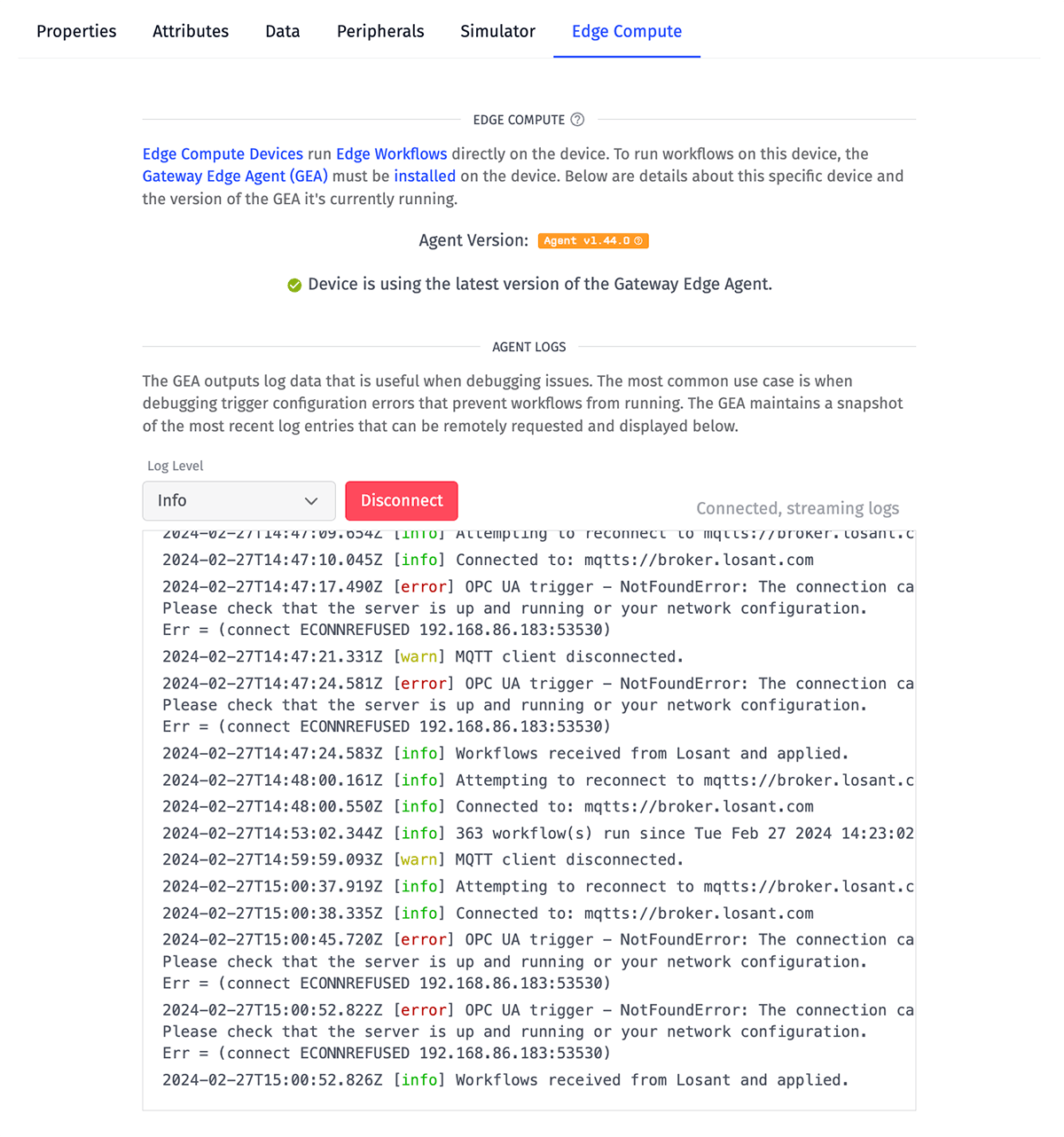

Viewing Container Logs Remotely
Starting with GEA version 1.44.0, Docker container logs can be remotely retrieved and streamed through the Losant interface. On the device's "Edge Compute" tab, select a logging level (Error, Warning, Info, or Verbose) and click "Connect".
If the Edge Compute device is running the agent and is connected to the MQTT broker, the panel will immediately return the most recent 256 messages of the selected log level and will continue streaming new messages in real time so long as the device remains connected.
Note: The interface can only return logs for the Docker container instance that is currently running the GEA - not other containers on the device, or containers that previously ran the GEA and were deleted.
