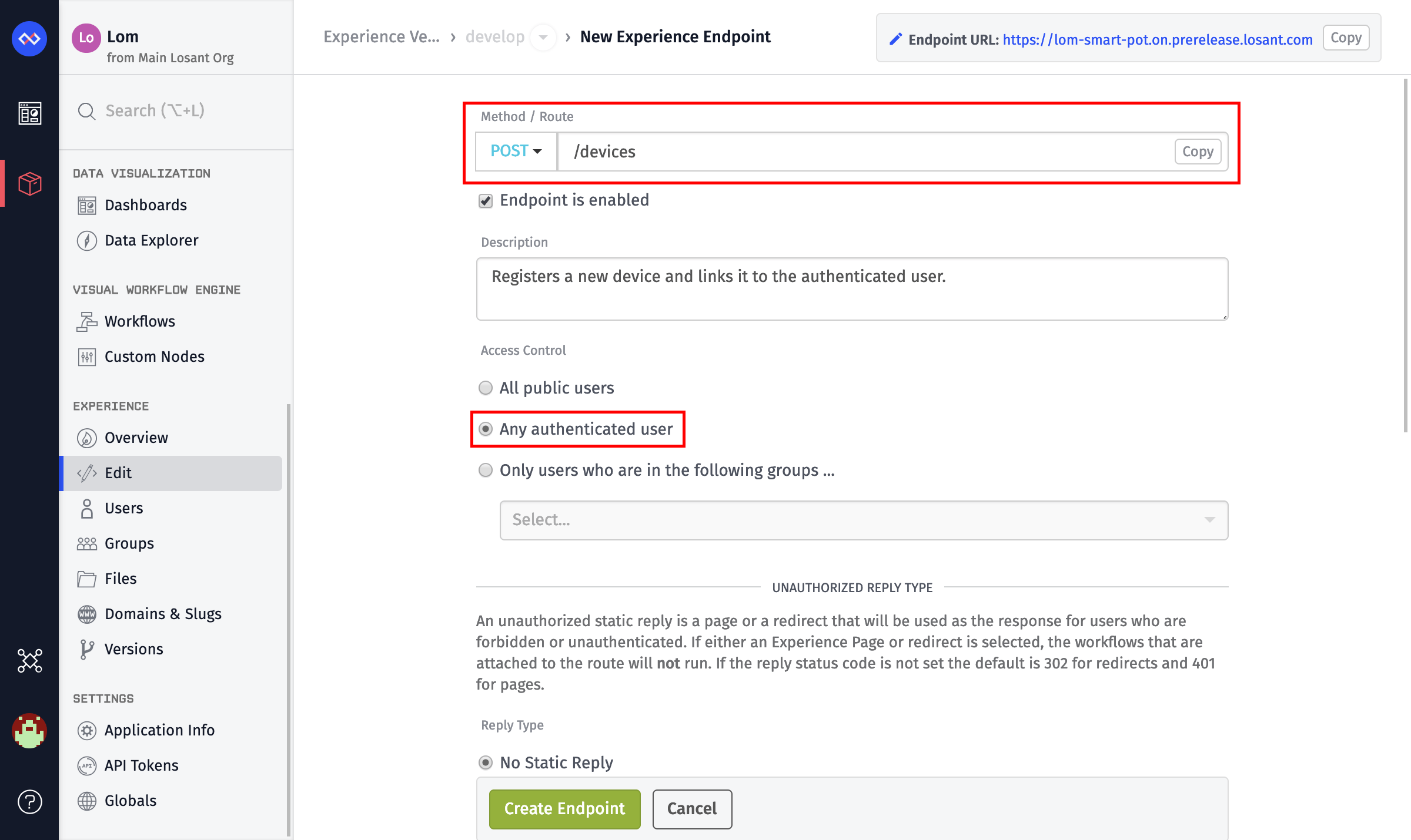

Step One: Create the POST /devices Endpoint​
The first step is to create the POST /devices endpoint that your device can use to register itself:
Register Endpoint
  1. Set the Method to POST.
  2. Set the Route to /devices.
  3. Add a Description.
  4. Set the Access Control to Any authenticated user.
Unlike the /users and /auth endpoints, this endpoint requires a valid user token. The lōm app does not require the use of user groups, so any authenticated user is allowed to request this endpoint. User groups allow you to granularly define access to specific endpoints for subsets of your Experience Users.

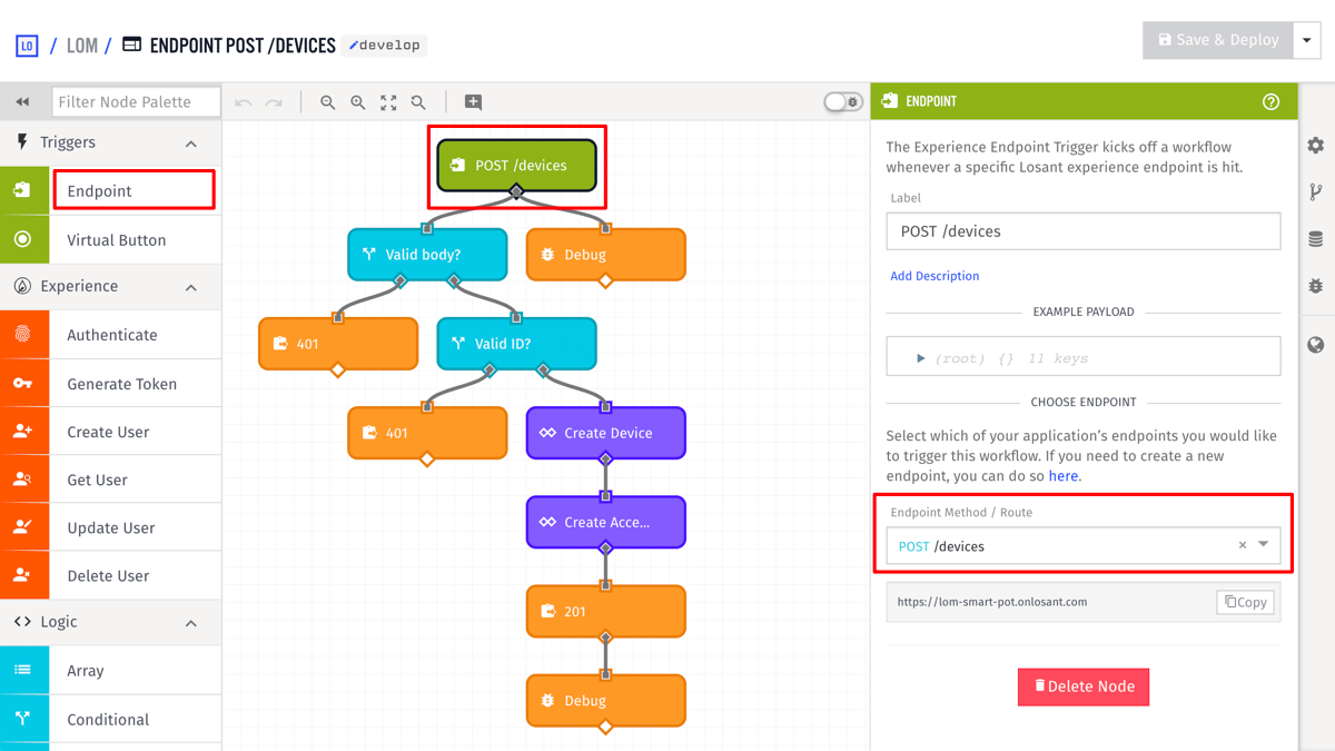

Like all endpoint workflows, start by adding an Endpoint trigger to the canvas.
Endpoint Trigger
The only required configuration option is to set the Endpoint Method / Route to POST /devices. This workflow triggers whenever the POST /devices endpoint is requested.

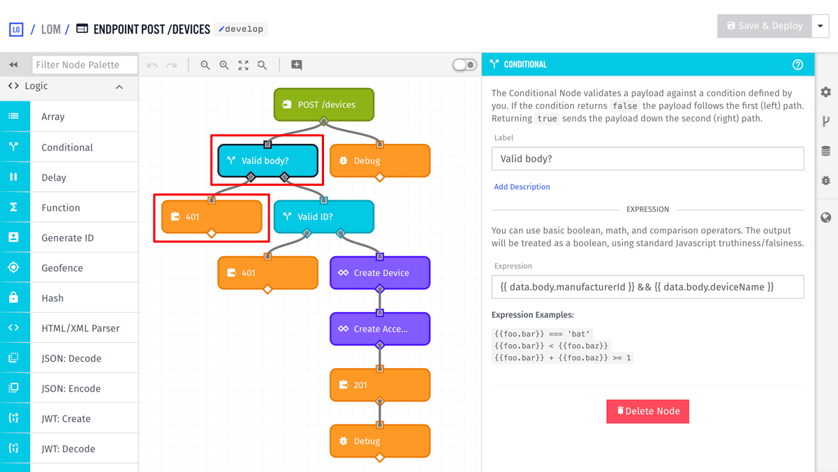

Step Three: Add Validation​
The next step is to add some validation to ensure the client provides the manufacturer ID and the custom device name. Add a Conditional node and an Endpoint Reply node to the canvas.
Validate Input
  1. Set the Expression on the Conditional Node to {{ data.body.manufacturerId }} && {{ data.body.deviceName }}. This verifies that both "manufacturerId" and "deviceName" are present on the POST body.
  2. Set the Response Code Template to 400 on the Endpoint Reply node. 400 is the HTTP status code for Bad Request.
  3. Set the Response Body Template on the Endpoint Reply node to { "error": "manufacturerId and deviceName are required." }.
Now if a client makes a request against the lōm API to register a device and does not provide all required fields, the API will respond with a 400 (Bad Request).

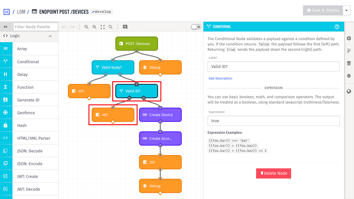

Step Four: Check Manufacturer ID​
The next step is to check that the manufacturer ID that was supplied is valid.
Validate ID
Since this check is so specific to each use-case, this workflow simply adds a representative conditional node that always returns true. In practice, this is the place you'd query some collection of valid IDs. What represents a valid ID is up to you. If the ID is invalid, the API returns a 400 (Bad Request) back to the user.

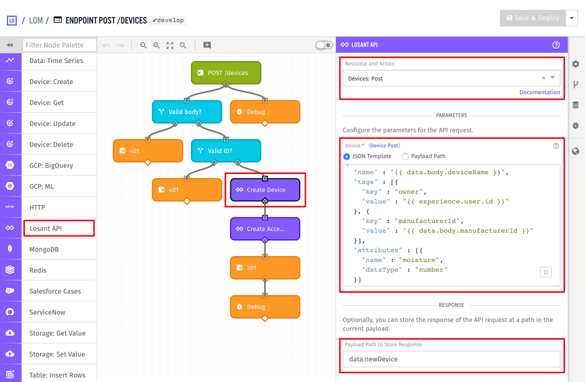

Step Five: Create a New Device​
The next step is to use the Losant API node to create a new device.
Create Device
The Losant API node allows you to manage all resources within your Losant application. In this case, we're using it to create a new Losant device.
  1. Set the Resource and Action to Devices: POST.
Note: This Devices: POST is not your devices endpoint. This calls the devices endpoint for Losant's API.
  1. Set the device to the following:
"name": "{{ data.body.deviceName }}",
"tags": [
"key": "owner",
"value": "{{ experience.user.id }}"
"key": "manufacturerId",
"value": "{{ data.body.manufacturerId }}"
"attributes": [
"name": "moisture",
"dataType": "number"
This object is what Losant expects when creating a new Device. The name field is set to {{ data.body.deviceName }}, which is what was passed into this endpoint as part of the POST body.
Device tags are used to organize devices and provide a way to easily query them from the Losant API. In this example, we're setting two tags: "owner" and "manufacturerId." By setting the "owner" tag, we can query the Losant API for all devices owned by this user, which we'll see in part 4 of this walkthrough. Losant automatically adds the Experience User to the payload on every authenticated request, which is why the current user ID can be obtained at experience.user.id.
The "manufacturerId" tag is not used in this guide, but it can be used to map the device back to the underlying ID at a later time.
Attributes describe what kind of data this device reports. For lōm, each device reports its moisture as a number.
Set the Payload Path to Store Response to data.newDevice. This puts the result of this Losant API request back onto the payload at this location. The result is the newly created device object.

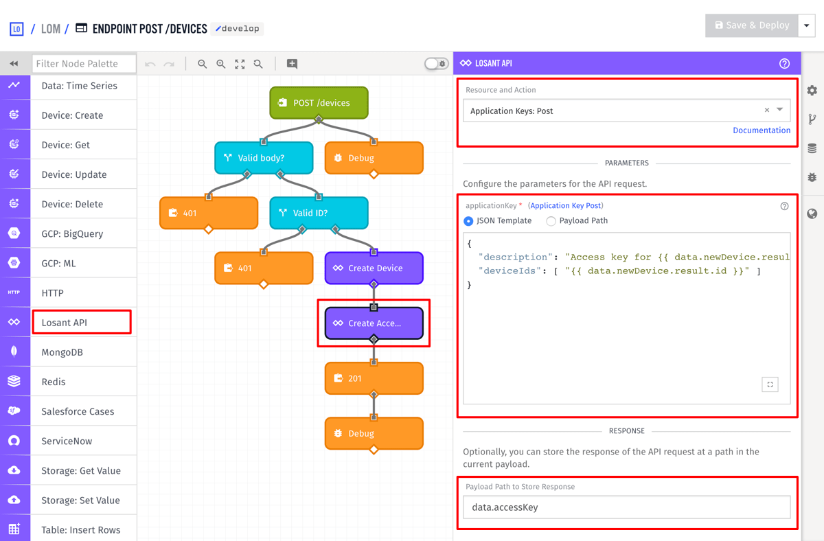

Step Six: Create an Access Key​
Now that we have a device, we can use another Losant API node to create an access key for it.
Access Key
Access Keys allow devices to authenticate against the Losant MQTT broker or REST interface to report state or receive commands.
  1. Set the Resource and Action to Application Keys: POST, which creates a new access key within your Losant application.
  2. Set the applicationKey to the following:
"description": "Access key for {{ data.newDevice.result.id }}",
"deviceIds": ["{{ data.newDevice.result.id }}"]
This creates an access key that's only valid for the device we created in the previous node.
  1. Set the Payload Path to Store Response to data.accessKey, which puts the result of this Losant API request back onto the payload. This includes the access key and secret that we need to send back in the endpoint reply.

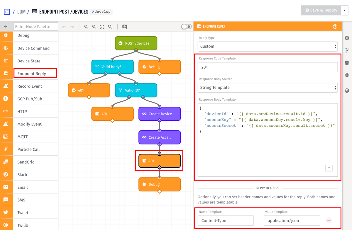

Step Seven: Reply to the Request​
The final step is to reply to the request with the newly created device ID, the access key, and the access secret.
Endpoint Reply
  1. Set the Response Code Template to 201, which is the HTTP status code for Created.
  2. Set the Response Body Template to the following:
"deviceId": "{{ data.newDevice.result.id }}",
"accessKey": "{{ data.accessKey.result.key }}",
"accessSecret": "{{ data.accessKey.result.secret }}"
  1. Add a Content-Type header and set the value to application/json.
We can now test this endpoint and see that it successfully creates a device and access key.

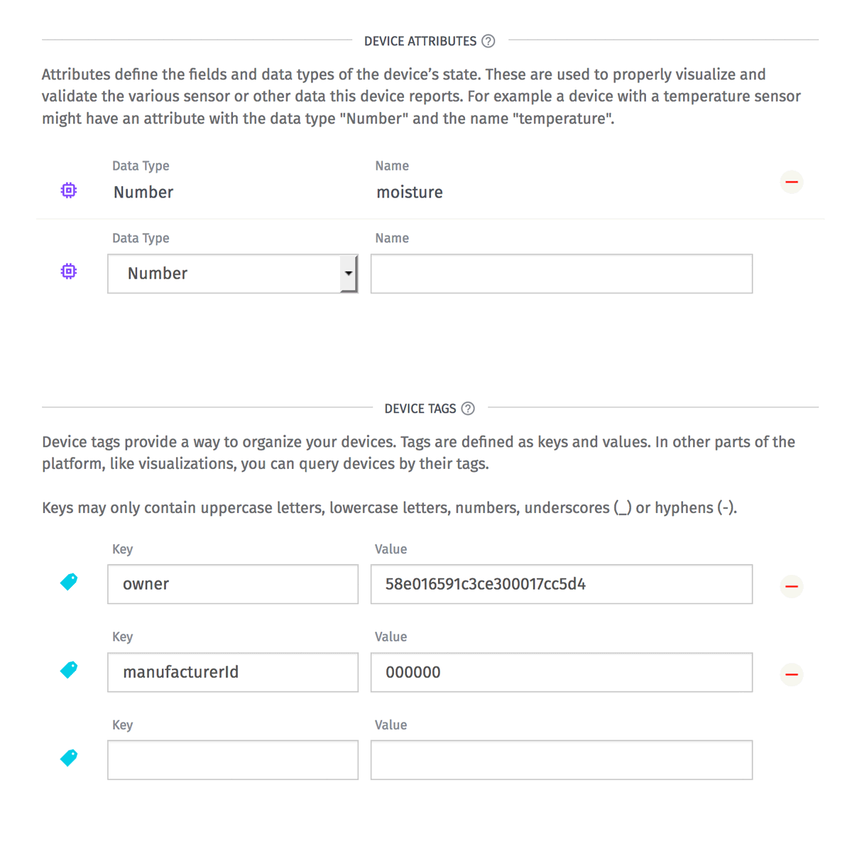

If you navigate to your Losant application's device list, you'll also see the new device with the attributes and tags properly configured.
