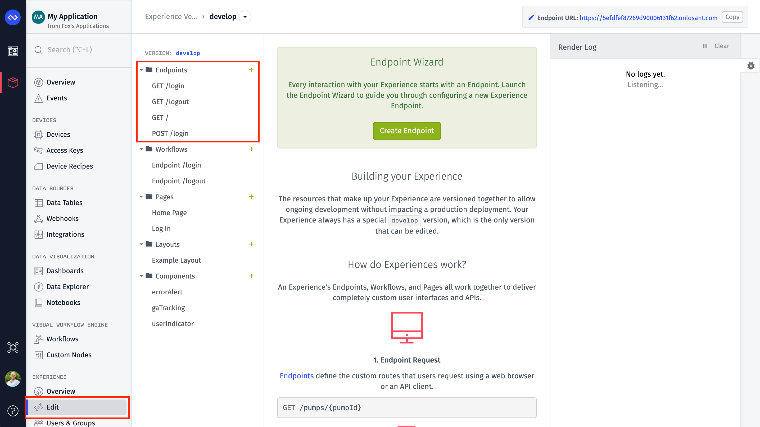

Define two endpoints that allow users to log in to your experience. The first, GET /login, returns the form with the email and password fields. The second, POST /login, accepts the credentials from the form, authenticates the user, and sets a cookie in their browser for future requests.
You can define endpoints under "Endpoints".
Endpoints

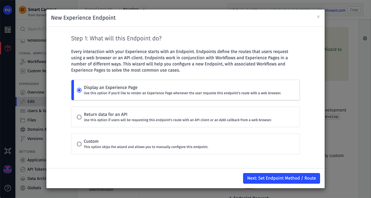

Losant provides an Endpoint Wizard to create and configure your new endpoint as well as any new pages or workflows necessary to utilize it:
Endpoint Wizard
The purpose of this guide is to walk through all of the steps. The instructions to follow assume that you select 'Custom':
Endpoint Wizard Page One

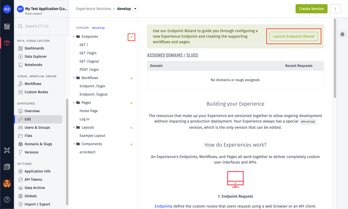

  1. Click the "Add" button on the top right of the endpoints list to add the new GET /login endpoint.
Log in Endpoint

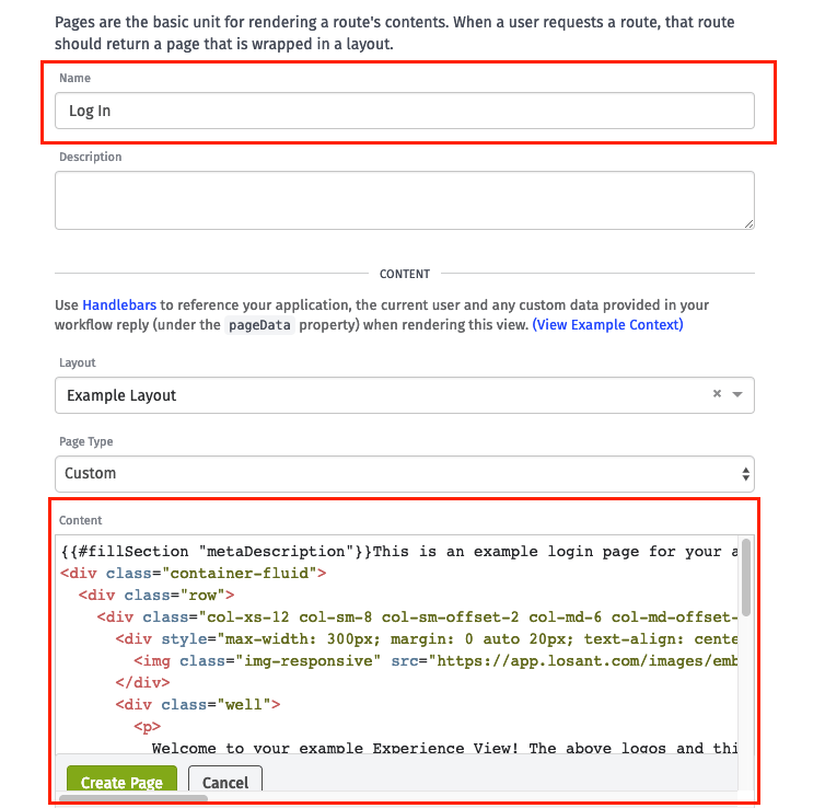

Add Page
Page Content
Pages work similarly to the layouts and components you've already seen. Each one requires a name and content. Unlike layouts and components, however, pages also accept a layout. When this page is requested, this is the layout that it will be rendered into.
The content for this example is here:

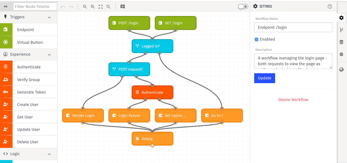

First, download the example workflow and import it as a new experience workflow.
Workflow

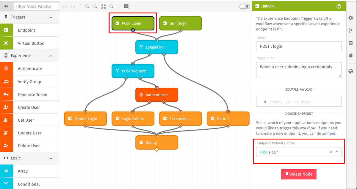

You'll notice that the workflow is disabled. Before you can use this workflow, you need to enable it and configure a few settings in various nodes to use your newly created endpoints and login page.
  1. Click the two endpoint triggers at the top and set the Endpoint Method / Route to the corresponding endpoints you created earlier.
Edit Triggers

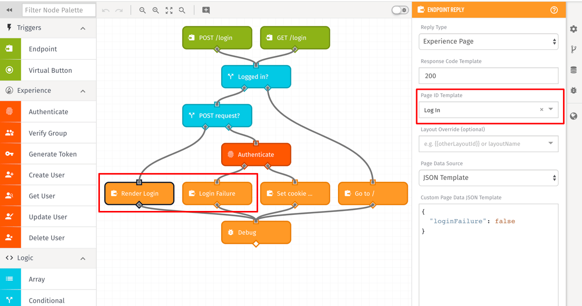

  1. Edit the two Endpoint Reply nodes and set the Page Template field to your newly created Log In page.
Edit Replies
This workflow triggers for both the GET /login and POST /login endpoints. Once triggered, this workflow does the following tasks:
  • Checks to see if a user is already logged in. If a user is logged in, the experience.user payload path will be automatically filled in with the user's details.
  • If a user is logged in, the workflow replies with a redirect to /, which is the home page that's created in the next part of this walkthrough.
  • If the user is not logged in, the workflow then checks whether its handling the GET or POST request.
  • If it's the GET request, the workflow replies with the Log In page you just created.
  • If it's the POST request, the workflow uses the Authenticate node to check if the email and password provided by the user are valid.
  • If the authentication fails, the workflow replies with the Log In page again, but this time it sets the loginFailure and email fields. These are used to display an error to the user and prepopulate the email field so the user doesn't have to retype it.
  • If the authentication succeeds, the user is redirected to the home page. The reply node also sets an authorization cookie set to the user's authentication token, which was obtained from the previous Authentication node. The browser automatically sends this cookie with each subsequent request, so Losant can keep the user logged in during their session.
