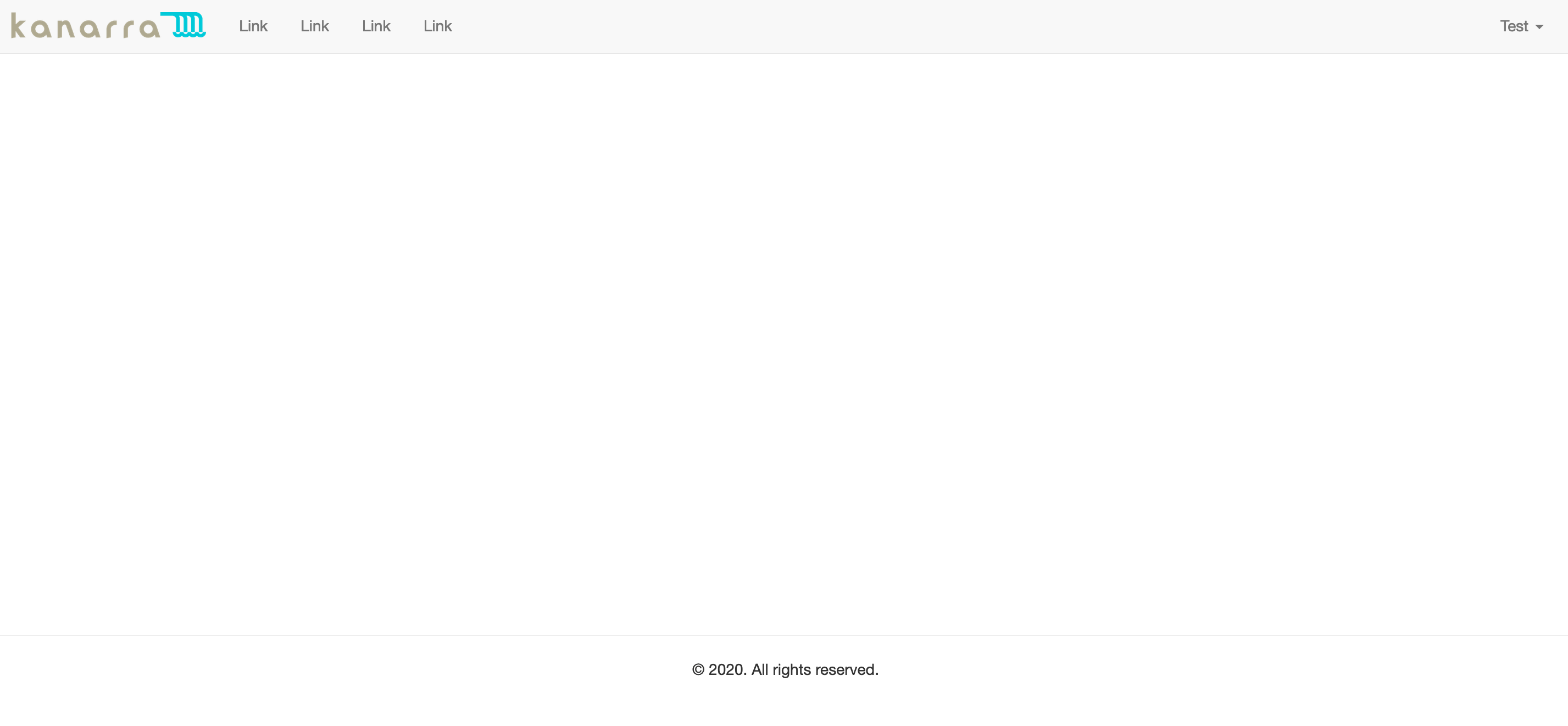

For this walkthrough, the layout that you'll be building looks like the following:
Blank Layout
This layout includes a header and a footer. The header includes a logo, a few placeholder navigation links, and a "Log In" link. The footer includes a copyright statement. The blank space in the middle is where individual pages will be rendered within this layout.

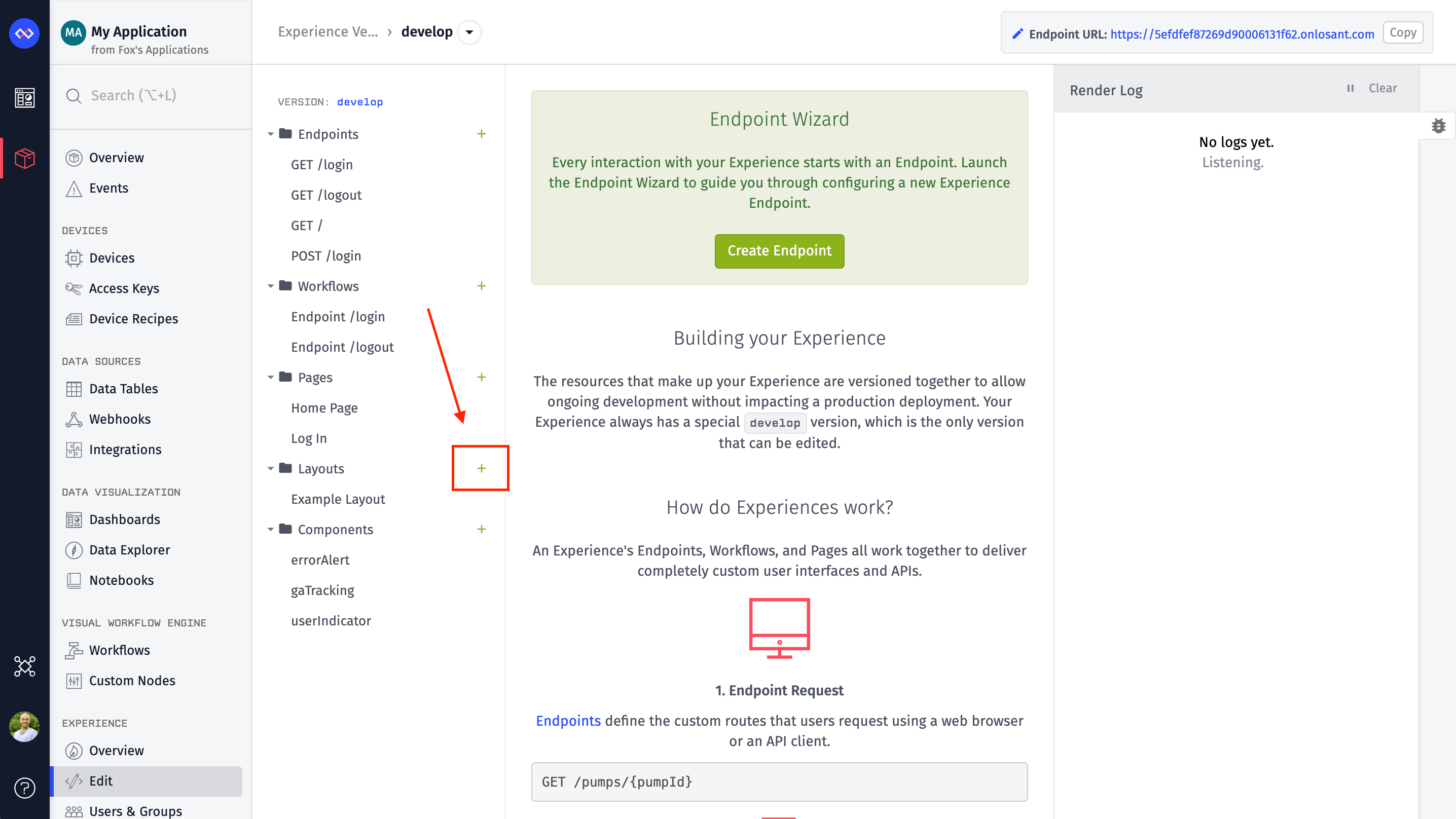

In the Edit section, you'll see multiple types of resources, including: Layouts, Pages, and Components. To create your Layout, click the Add button next to the Layouts folder.
Add Layout

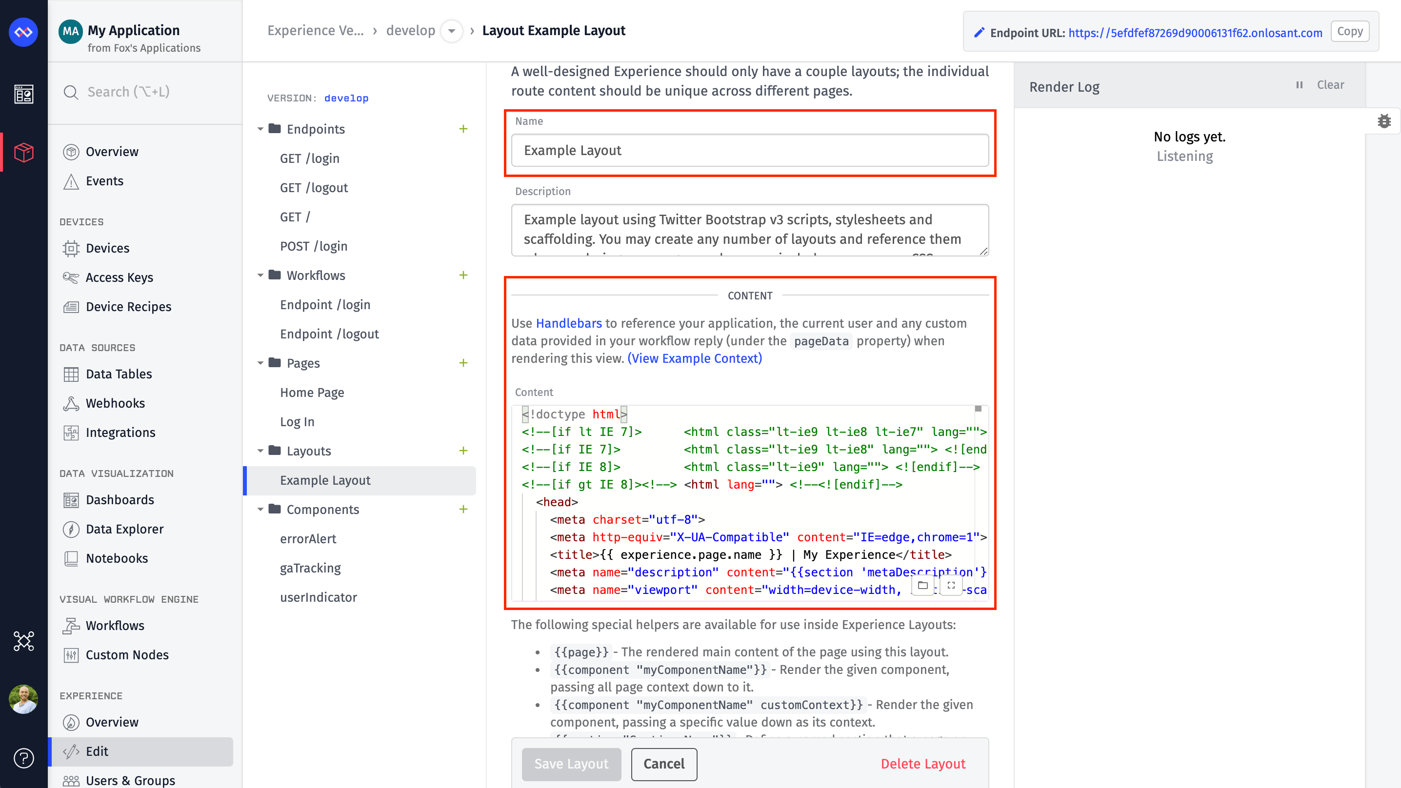

After you click the Add button, you'll be presented with a blank layout. Every layout requires a name and some content.
Layout Content
The HTML code for the example content can be found on GitHub. Feel free to copy/paste that into your newly created layout.
Layouts are defined as HTML and Handlebars templates. You can define a layout with any content you'd like. In this example, Twitter Bootstrap is used since it provides responsive scaffolding and common elements found on most web pages. Bootstrap, however, is not required.
Note: The remainder of this walkthrough is written assuming you are using Bootstrap as your framework.

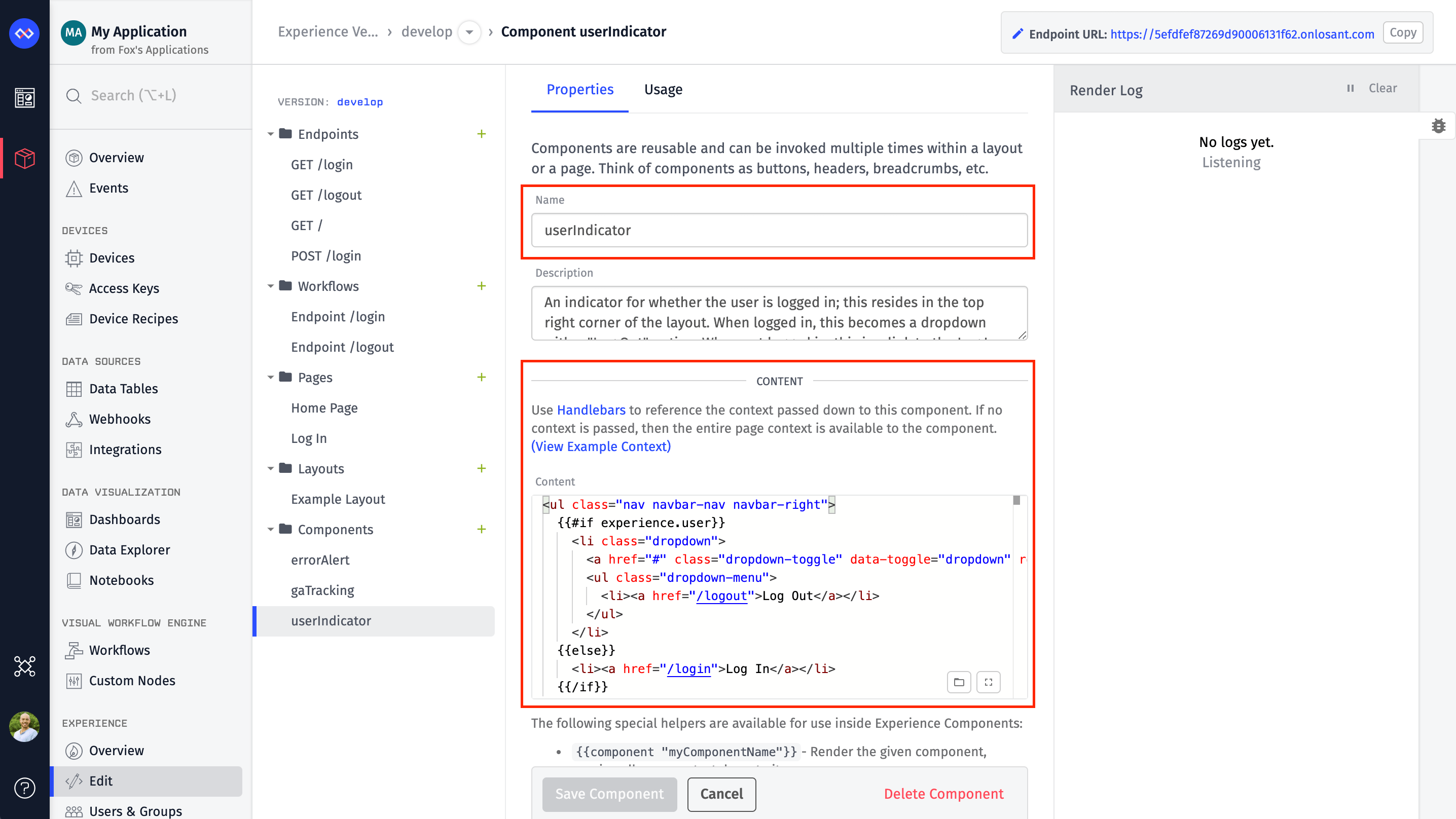

The next item is the userIndicator component, which provides the "Log In" link in the top right corner of the page. This toggles between a "Log In" link and a dropdown menu displaying the user's first name based on whether a user is logged in.
{{component "userIndicator"}}
Components provide a way to group and reuse page elements. Components are added to a page or layout using the component Handlebars helper. The name of the component is then used to control which component should be placed on the page. In this example, the component's name is "userIndicator". To create that component:
Click the "Add" button at the top of the Components list.
Add Component
Just like with layouts, components require a name and some content.
Component Content
You can get the content for this example from GitHub. Since this component is fairly small, its content is also below. Copy/paste this into your new component. Click 'Create Component' at the bottom of the page.
<ul class="nav navbar-nav navbar-right">
{{#if experience.user}}
<li class="dropdown">
<a href="#"
class="dropdown-toggle"
data-toggle="dropdown"
role="button"
aria-haspopup="true"
aria-expanded="false">
{{experience.user.firstName}}
<span class="caret"></span></a>
<ul class="dropdown-menu">
<li><a href="/logout">Log Out</a></li>
</ul>
</li>
{{else}}
<li><a href="/login">Log In</a></li>
{{/if}}
</ul>
If the user is logged in, a user object is automatically placed on the context for you. This component checks for that object to determine what to display. If there is no user object, it displays a "Log In" link. If the user object does exist, it displays the user's first name using the experience.user.firstName property and adds a menu item to log out.

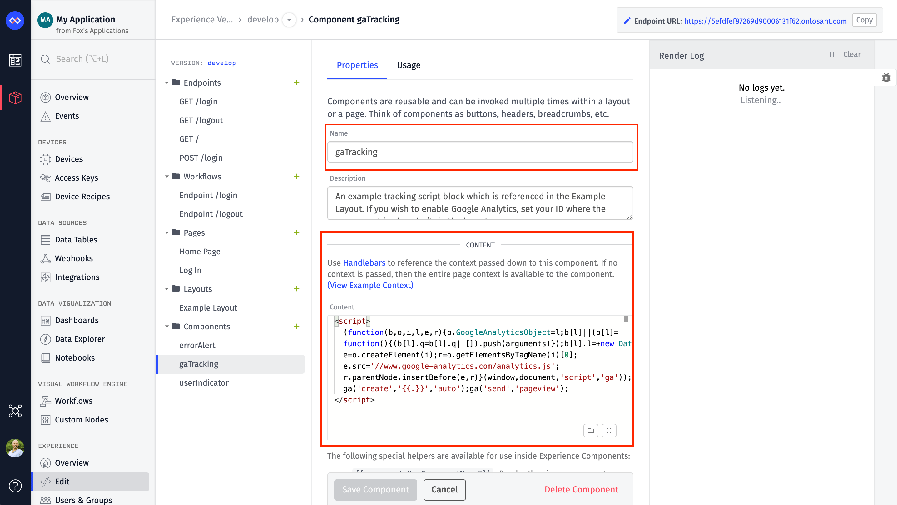

Google Analytics​
The last component on the page, gaTracking is used to add Google Analytics tracking to this custom web experience.
{{component "gaTracking" "UA-XXXXX-X"}}
As we did with adding the userIndicator, create a new component and name it gaTracking. The contents of this component can be found on GitHub and are also displayed below. To use this component, replace UA-XXXXX-X with your specific tracking ID that is provided by Google Analytics.
Google Analytics Tracking Component
<script>
(function(b,o,i,l,e,r){b.GoogleAnalyticsObject=l;b[l]||(b[l]=
function(){(b[l].q=b[l].q||[]).push(arguments)});b[l].l=+new Date;
e=o.createElement(i);r=o.getElementsByTagName(i)[0];
e.src='//www.google-analytics.com/analytics.js';
r.parentNode.insertBefore(e,r)}(window,document,'script','ga'));
ga('create','{{.}}','auto');ga('send','pageview');
</script>
This code is provided by Google Analytics, so it is outside the scope of this walkthrough. The important thing to notice is the following line and the {{.}} template.
When this component was used in the page layout, the tracking ID was provided as a second argument to the component helper. If you provide any data this way, the entire context for this component is replaced by whatever value you supply. This means you can now reference the tracking ID by using the {{.}} template. In Handlebars, a dot refers to the entire context object, which in this case is a string representing the tracking ID that was passed in.
