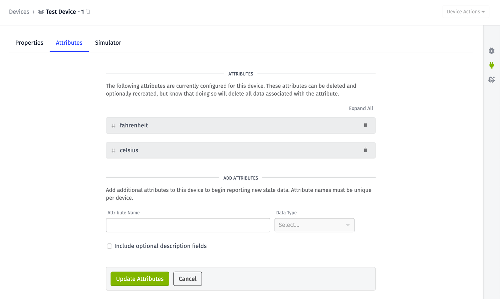

In this example, we have a device that has been configured with two number type attributes:
  • fahrenheit
  • celsius
Device Attributes

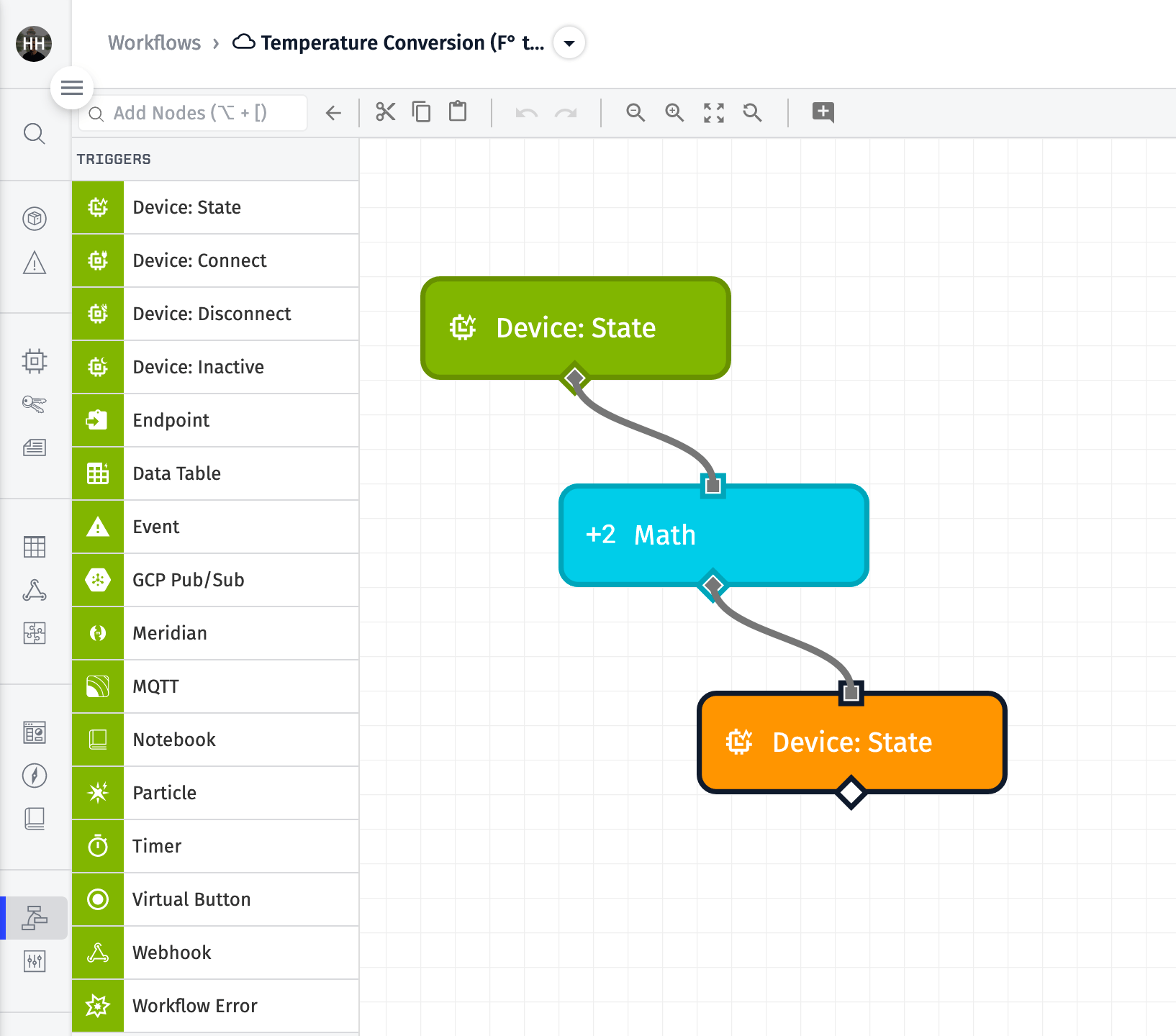

  1. Create a workflow within your application.

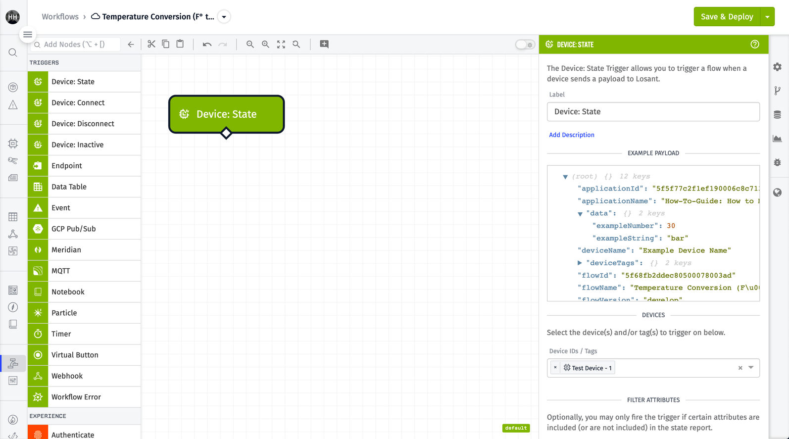

  2. From your blank workflow canvas, drag a Device: State Trigger onto the canvas.
Device State Trigger
  1. In the “Devices” section, select the device that will report the data converted within this workflow.
  2. In the Filter Attributes section of the node configuration, select “Any but the following” from the Allowed Attributes drop down menu.
  3. Select celsius from the Select Attributes drop-down menu. When the device selected reports state to Losant, it will trigger the workflow when any attribute but the celsius attribute is reported. Using this filter allows the workflow to not invoke an infinite loop error by only triggering if certain attributes are included or not included.
Device State Configuration

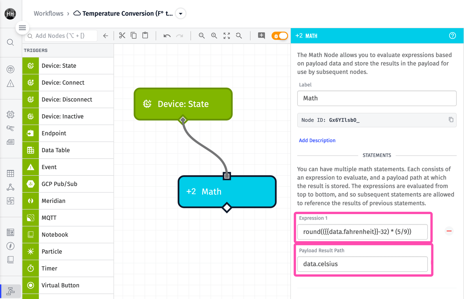

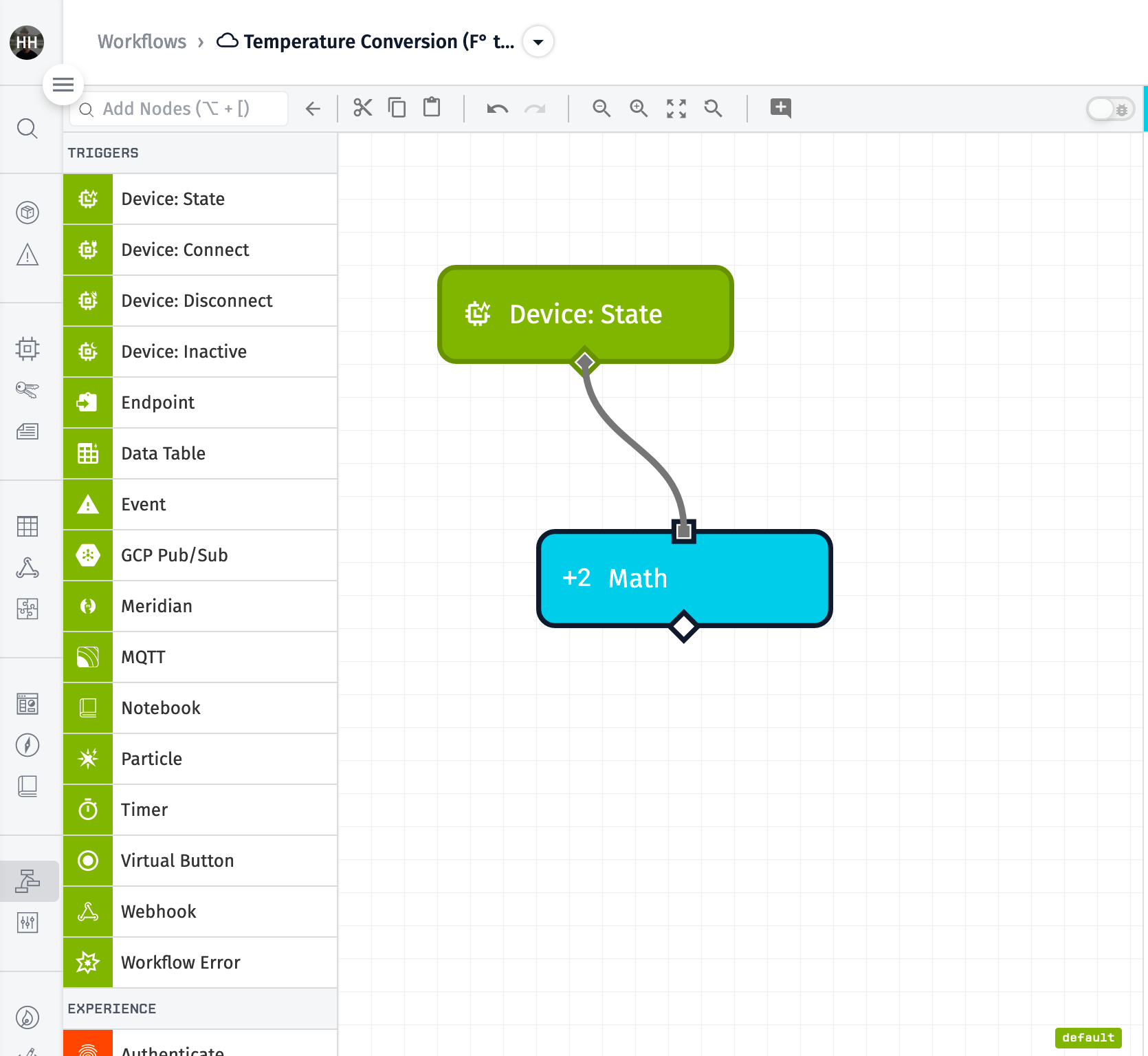

  1. Drag a Math Node onto the canvas and connect it to the Device: State Trigger. The Math Node will contain the formula to calculate the temperature in Celsius using the reported temperature in Fahrenheit.
Math Node Configuration
The formula to convert Fahrenheit to Celsius is: (Temperature (F°) - 32) * (5/9)

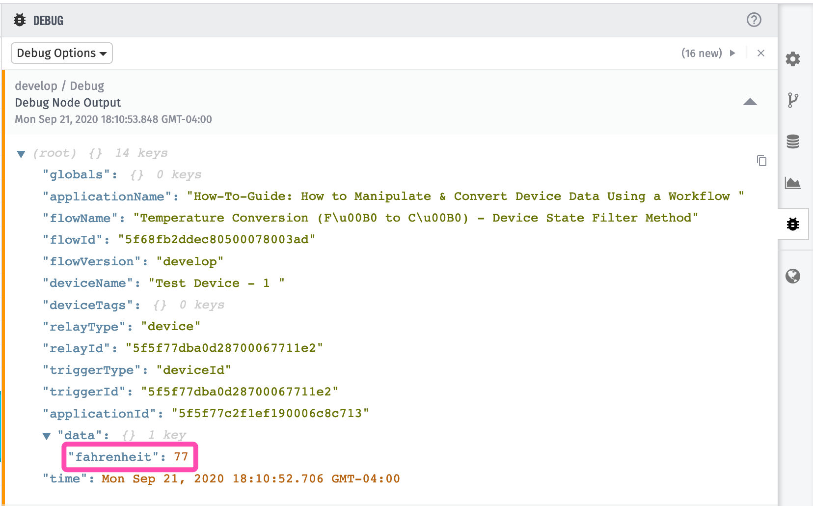

When you report state, the Device State Node will be triggered and will place the data on the payload at data.fahrenheit. Now that it’s within the workflow engines payload:
Debug Node
Accessing values on the payload is done through the use of Handlebars templates. The value for the temperature in Fahrenheit in this example is found on the payload at the path data.fahrenheit, and thus the conversion formula to place into the expression area of the Math Node configuration is:
round(({{data.fahrenheit}}-32) * (5/9))
More information on accessing payload data and available expression support can be found in the Accessing Payload Data Documentation.
  1. Complete the configuration of the Math Node by specifying a payload path of data.celsius to store the result of your expression.
Math Node Expression

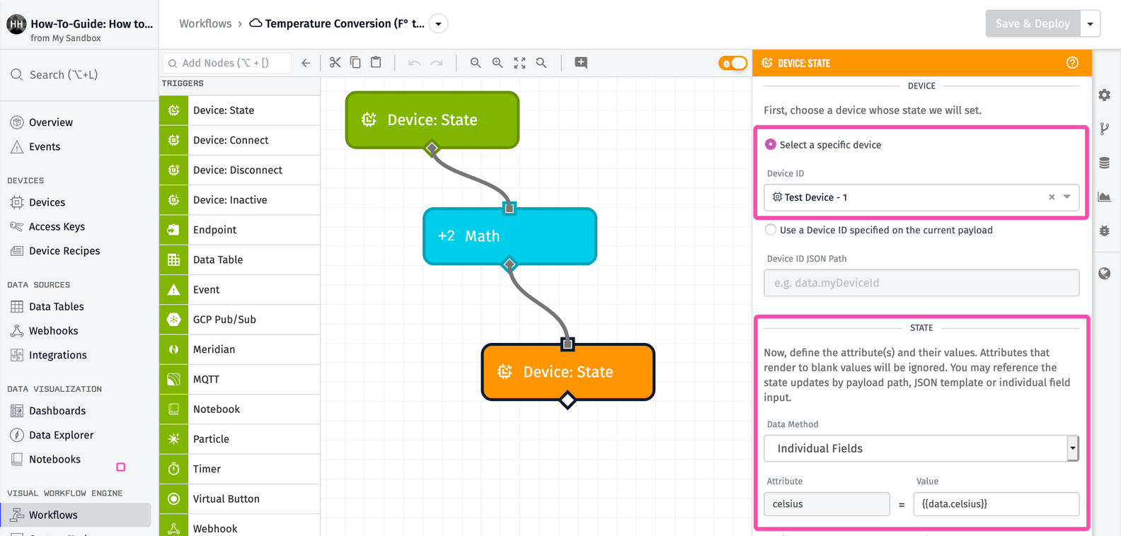

  1. Drag a Device: State Output Node onto the canvas, and connect it to the Math Node.
Device State Output Node
  1. In the ‘Device’ section of the Device: State Output Node configuration, specify the device that will have its state updated. This can be done be selecting the Device ID from the drop-down menu after selecting the “Select a specific device” radio button or by providing the payload path to the Device ID after selecting the “Use a Device ID specified on the current payload” radio button.
  2. Under the “State” section of the configuration window, set the value of the attribute celsius to the payload path where the stored result of the expression is located, data.celsius.
Device State Output Node Configuration

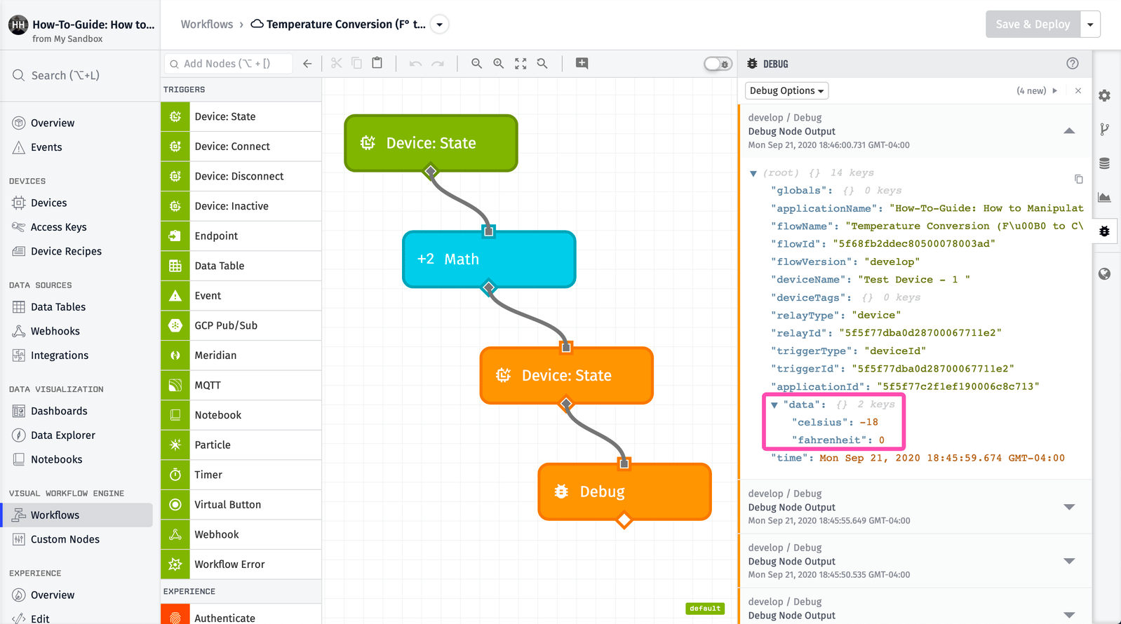

Losant Workflow Debug Panel
This attribute data can now be utilized throughout the Losant platform, including use in:
