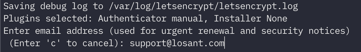

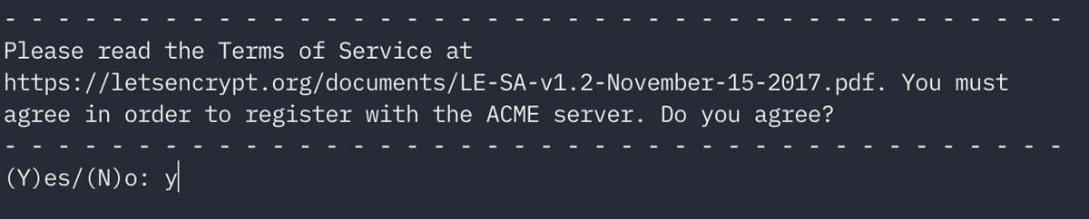

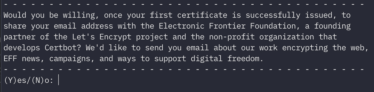

Once you press Enter on the Docker command, you will be walked through creating your SSL certificate.
Certbot Step 1
Certbot Step 2
Certbot Step 3

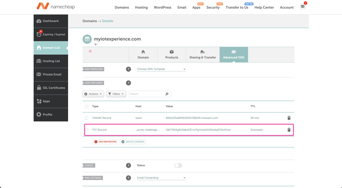

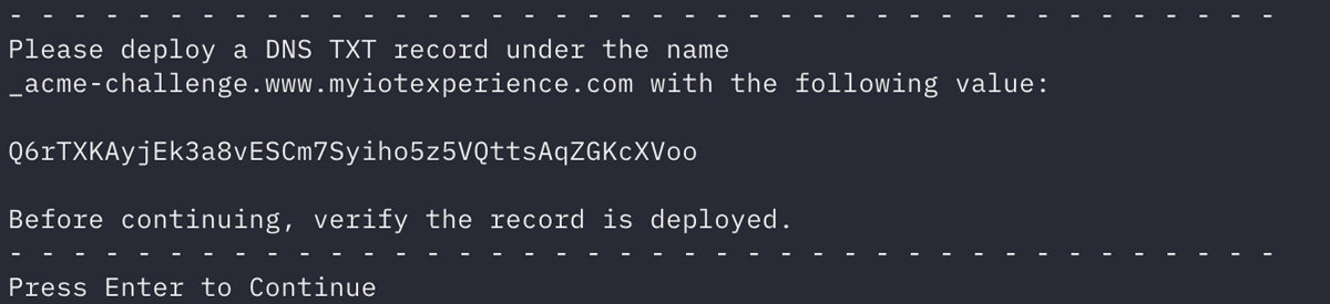

Then, you will be prompted to add a DNS TXT Record in your domain registrar to verify you have control of this domain. Create a new DNS TXT Record ...
  • Set the "host" to _acme-challenge.YOUR_SUBDOMAIN, where YOUR_SUBDOMAIN is the subdomain used when pointing a CNAME record to your experience (i.e. "www" or "my-iot-application").
  • Set the value to what is provided in the prompt (i.e. "Q6rTXKAyjEk3a8vESCm7Syiho5z5VQttsAqZGKcXVoo").

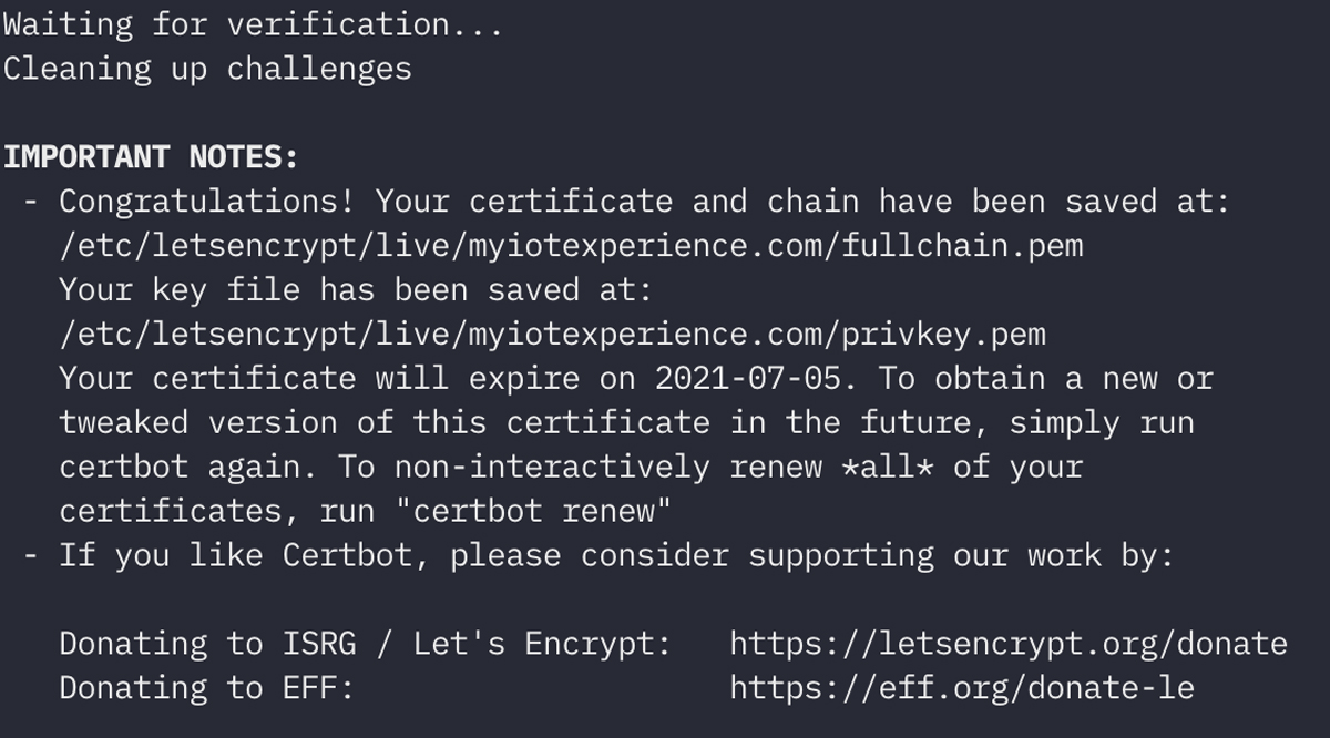

After you save the new TXT Record in your domain registrar, wait a few minutes (up to 24 hours) for the record to propagate, and then press Enter in your terminal.
Certbot Step 5
Create new TXT DNS Record
Certbot Step 6

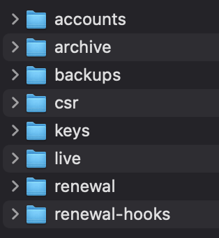

In Step 1, you referenced a directory on your computer with $PWD/my-ssl-certificates, or a different directory. Go to the directory you used, and you’ll find a series of directories, including one called 'live':
Directory Step 1

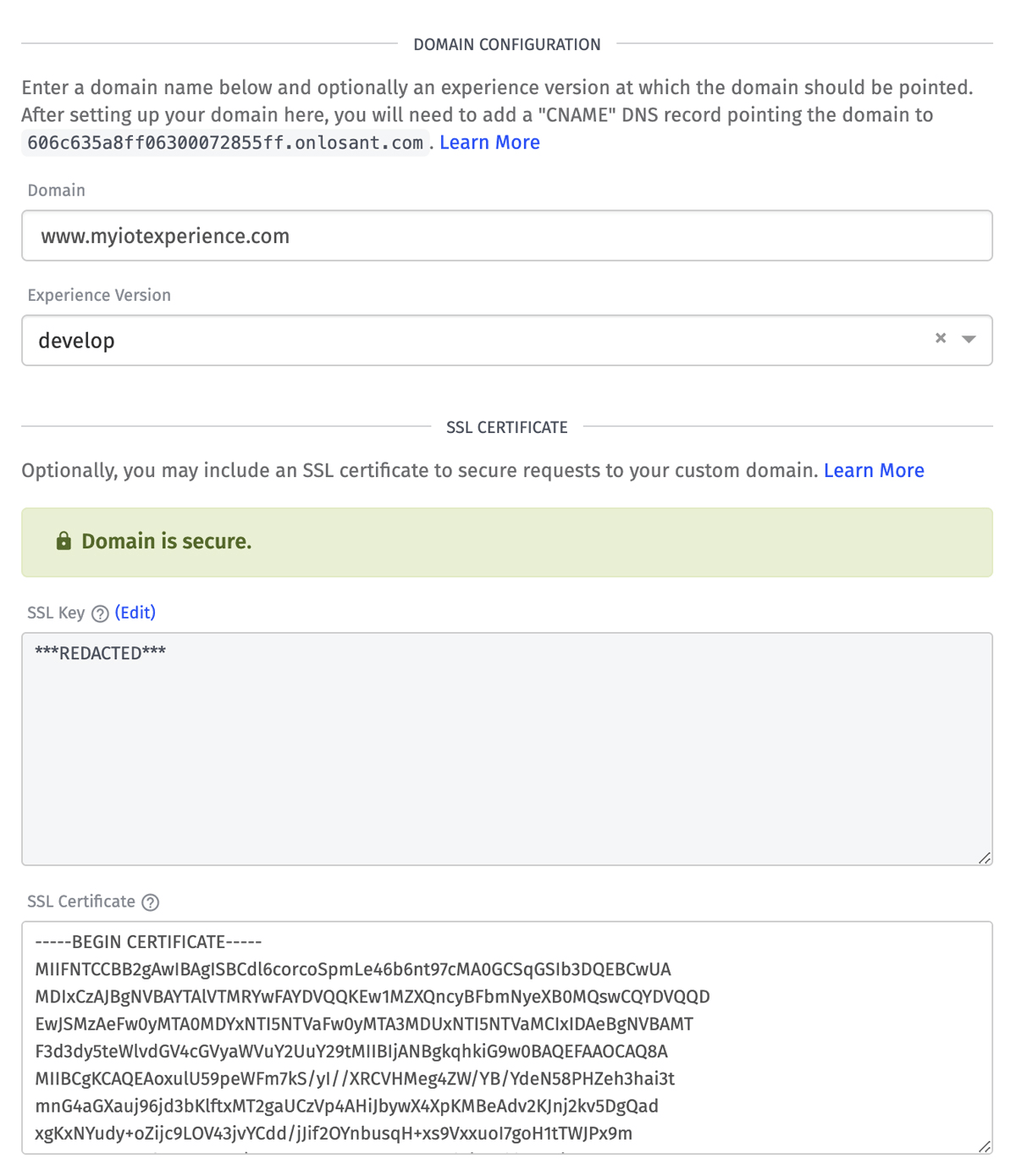

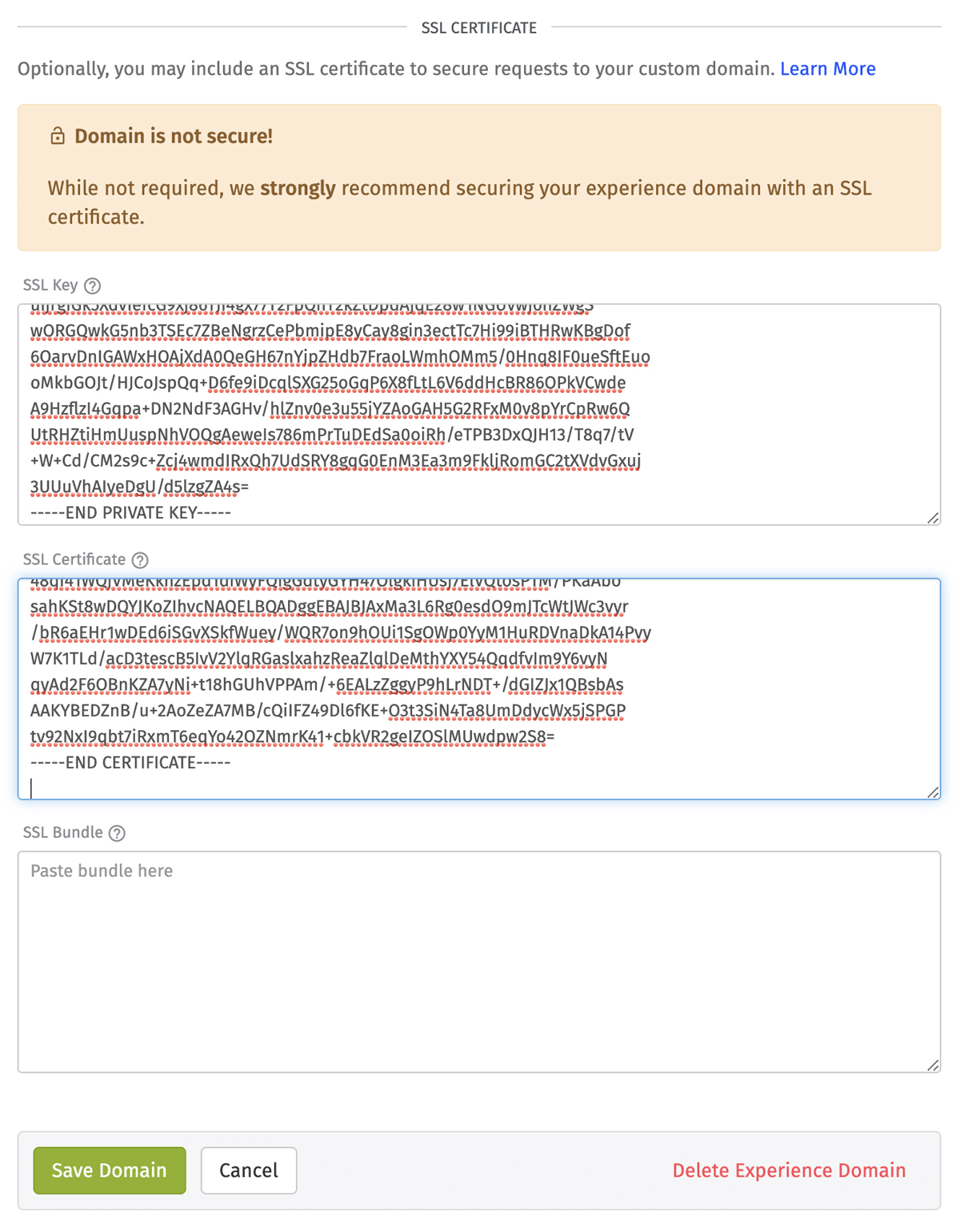

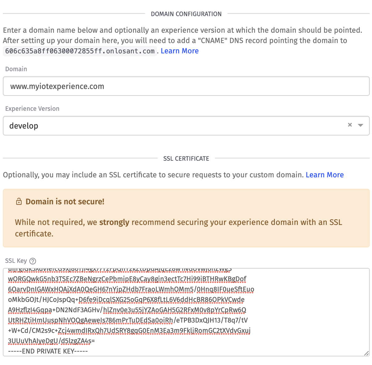

Open the privkey.pem file in a text editor of your choice, copy the contents of privkey.pem and paste them into the SSL Key section on the domain configuration page (including the BEGIN KEY line and END KEY lines):
Paste SSL Key
Then do the same for the cert.pem file. Open the file in a text editor of your choice, copy and paste the contents of the cert.pem file into the SSL Certificate field, then press “Save Domain”. In this guide, it is not necessary to put anything into the SSL Bundle field.
Paste SSL Certificate

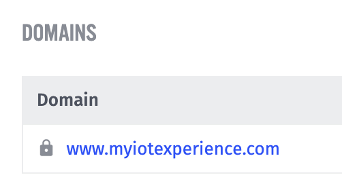

You will be redirected back to the Domains page of your experiences, where you will notice a latched lock next to your domain:
Domain Locked
If you click on your domain, and go to the domain configuration page, you will see a green box that says your domain is secure:
Domain Secure

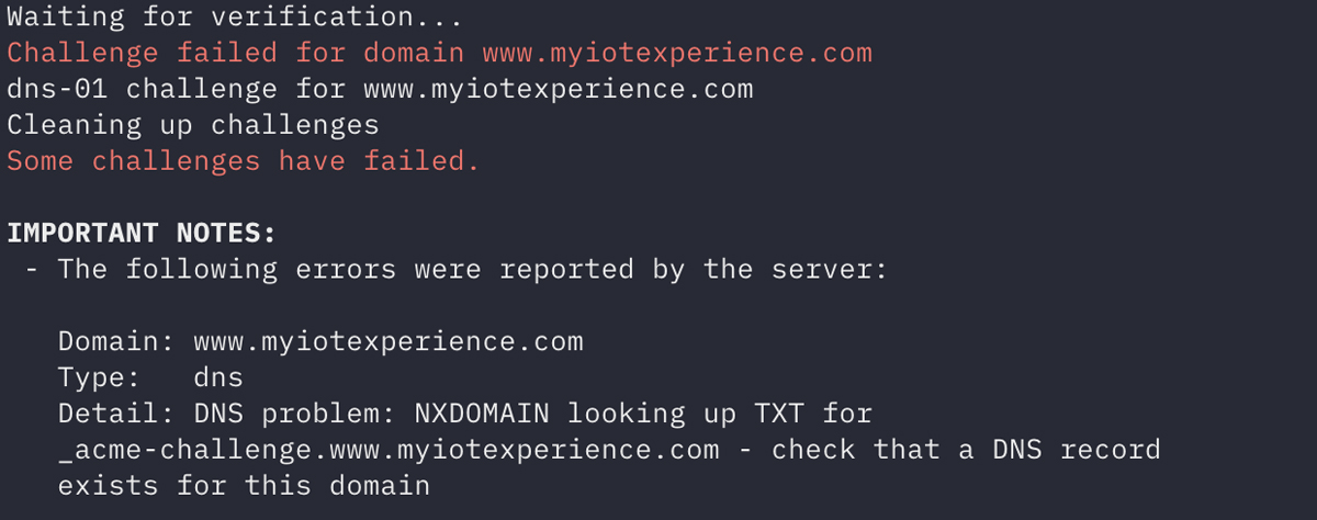

Certbot Challenge Failed​
When attempting to verify that you have control of the domain name, and have created a TXT record with the correct information, you can get the following error:
Certbot Error
This can mean a few things:
  • The host for the TXT record is not correct
    • For example instead of _acme-challenge.www for the host, you entered _acme-challenge or _acme-challenge.www.myiotexperience.com
  • The DNS hasn’t propagated yet. DNS propagation can take up to 24 hours.

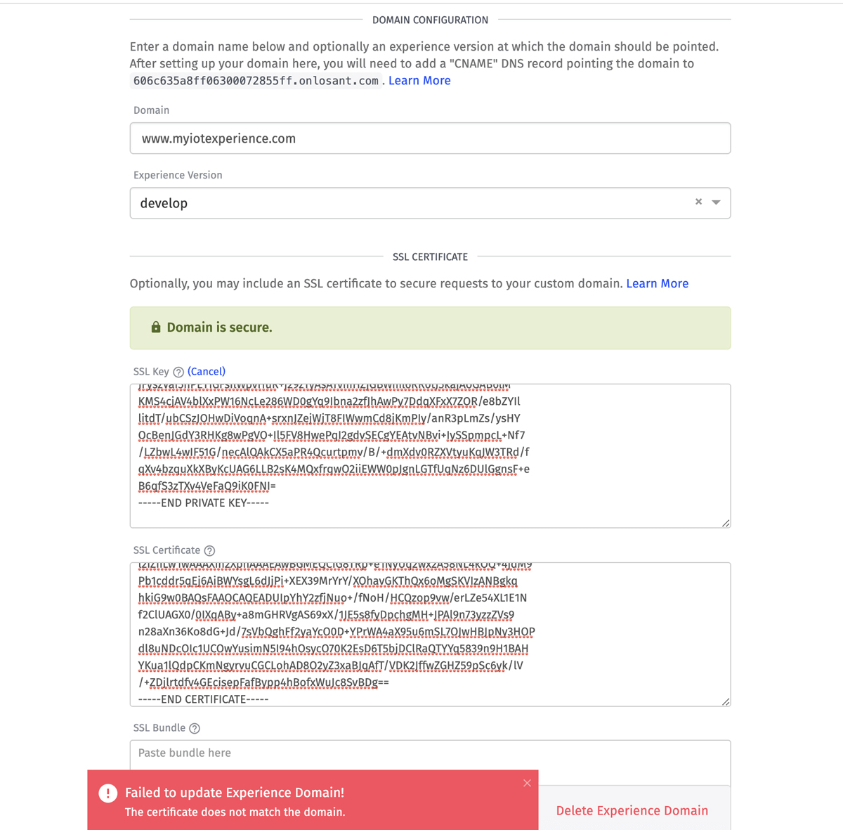

Certificate Doesn't Match Domain​
When attempting to save your domain in Losant, you get an error that the certificate does not match the domain you’ve provided.
Certificate Doesn&#39;t Match Domain
In this case, you will need to ensure that you copied and pasted the certificate correctly. Once you have confirmed that you have, you will need start over at Step 2 and ensure that you enter the domain name into your terminal correctly.
