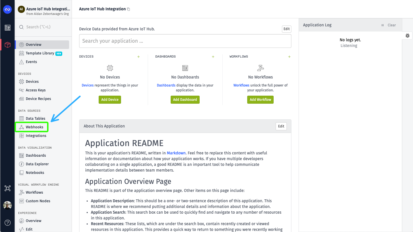

  1. Navigate to "Webhooks".
Create Webhook

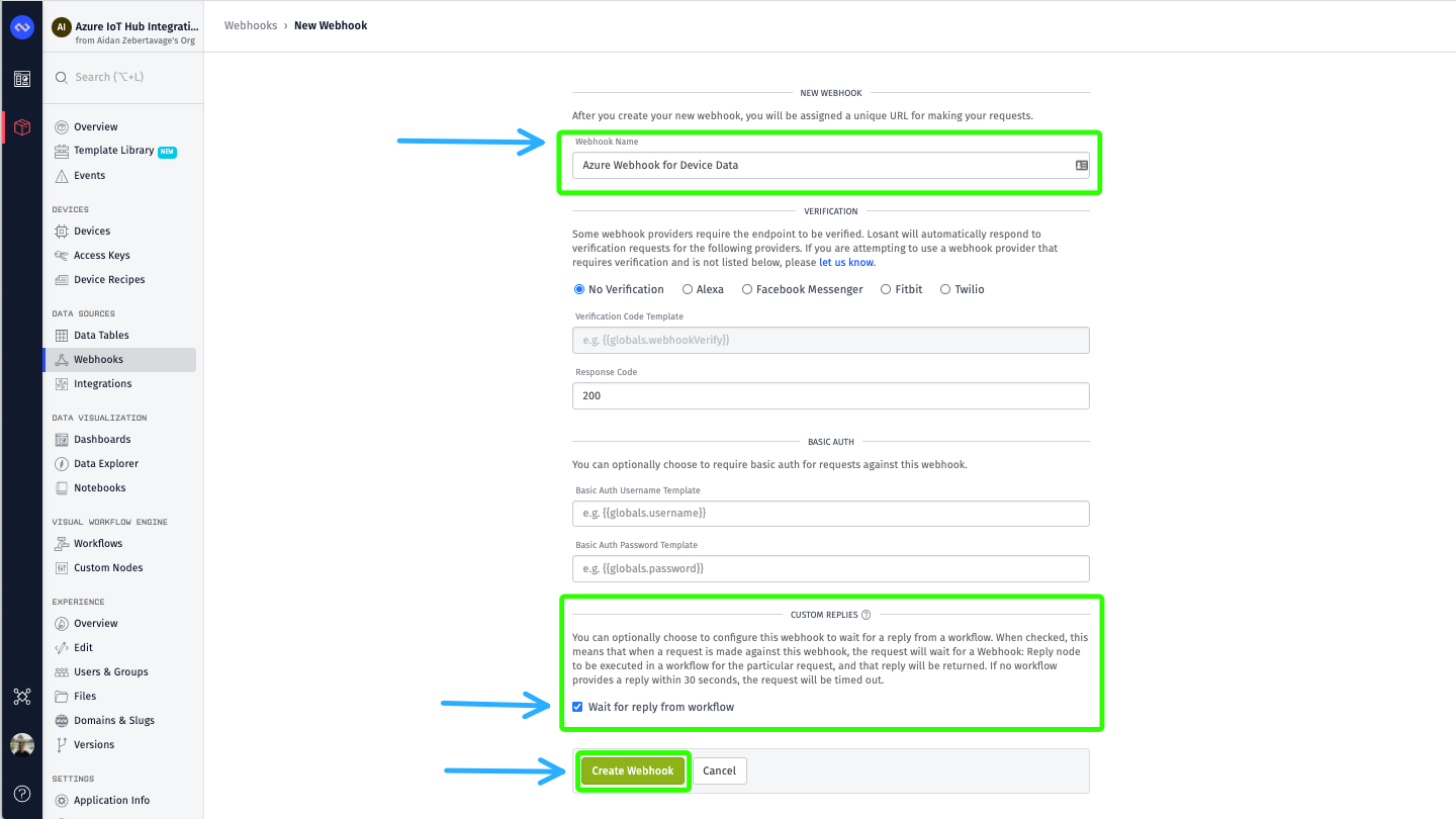

  1. Select "Add Workflow" and give your Webhook a friendly name.
  2. Select "Wait for reply from workflow"
  3. Select "Create Webhook".
Create Webhook

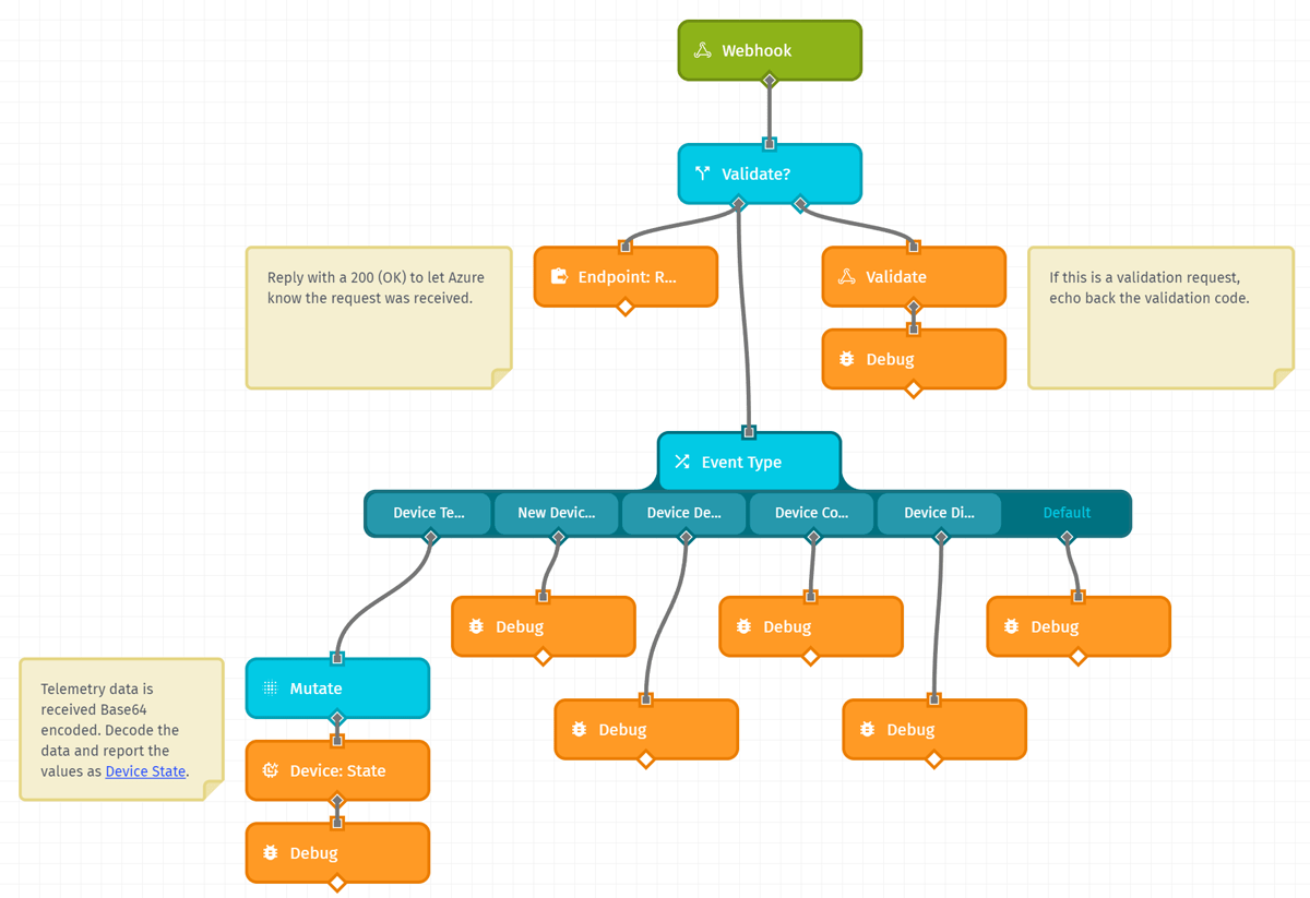

Once done, you will have imported a workflow that looks like the following:
Losant Workflow for Azure Webhook

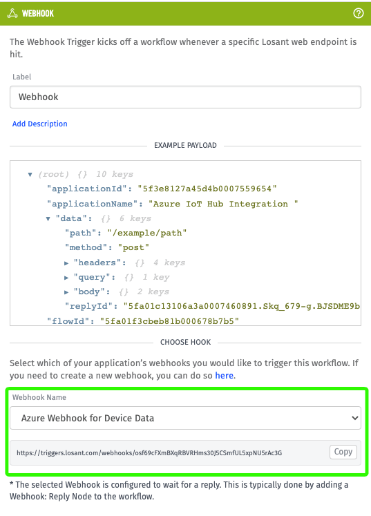

  1. Update the Webhook Trigger to select your newly created Webhook as the "Webhook Name".
Webhook Trigger Editor

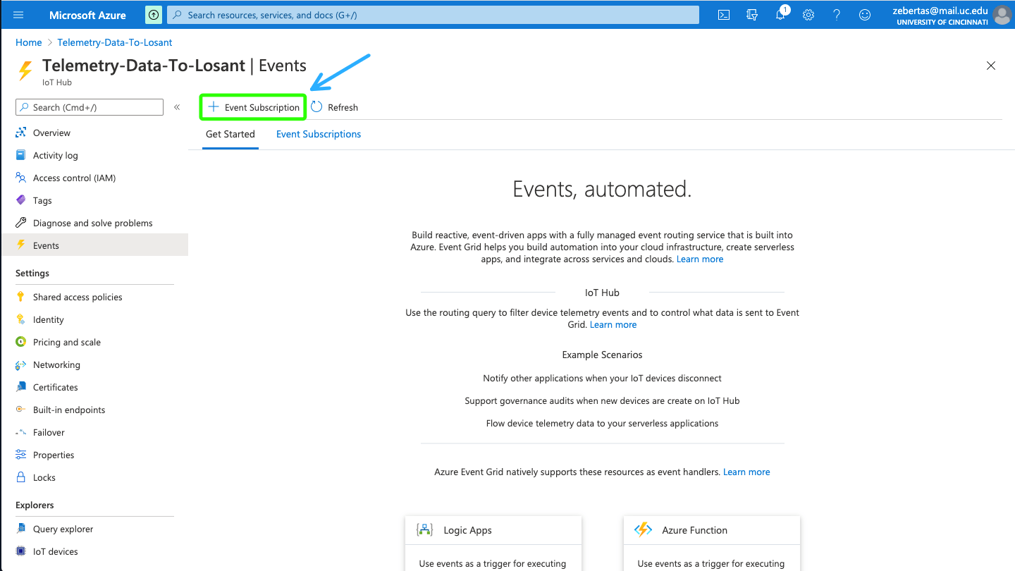

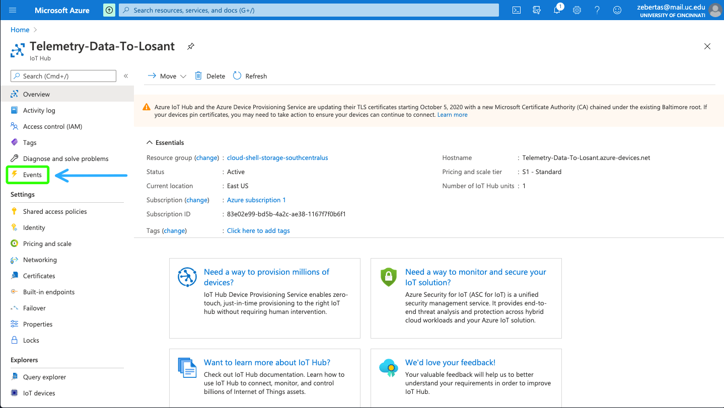

  1. Within IoT Hub, select "Events".
Azure IoT Hub Events
  1. Create a new Event Subscription.
Event Subscription

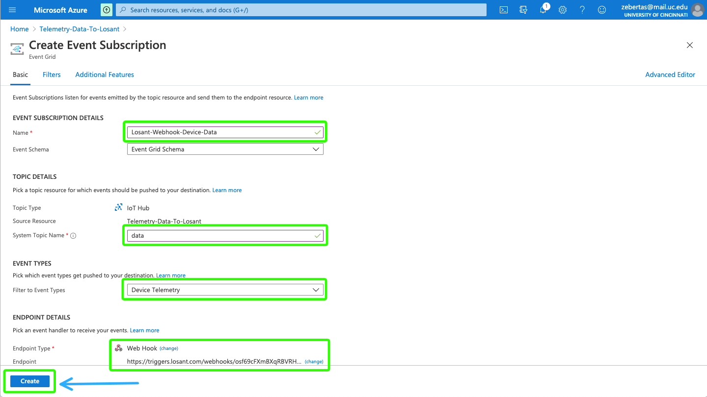

  1. Configure the following properties for the new Event Subscription:
    1. Name the Event Subscription.
    2. Configure data as the "System Topic Name".
    3. In the "Event Types" configuration, Select at least "Device Telemetry" and any other event you'd like to forward to Losant.
    4. Select "Web Hook" as the "Endpoint Type"
    5. Place the URL for the Losant Webhook created in the previous section as the "Endpoint".
Configure Event

Now, let's go through the Workflow to see how it's functioning.

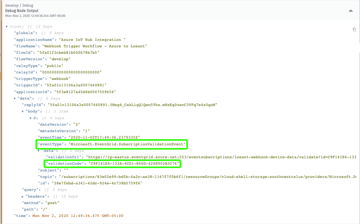

When you first create your EventGrid subscription, the first message sent to your Webhook URL by Azure is a request for validation.
In order to successfully validate the Webhook, Losant must reply back to Azure with the validation code contained in this initial subscription validation event.
If the Event Subscription was created properly in Azure, the very first message to Losant contains a payload that resembles the following:
Azure Verification Response
The string found under validationCode is what Losant needs to reply back to Azure with, along with a HTTP 200 OK response status code.
The reply happens in the Webhook: Reply Output Node.
In the "Reply Body" configuration, we provide a response that contains the validation code from the initial payload:
"validationResponse": "{{data.body.[0].data.validationCode}}"

Handling Event Types​

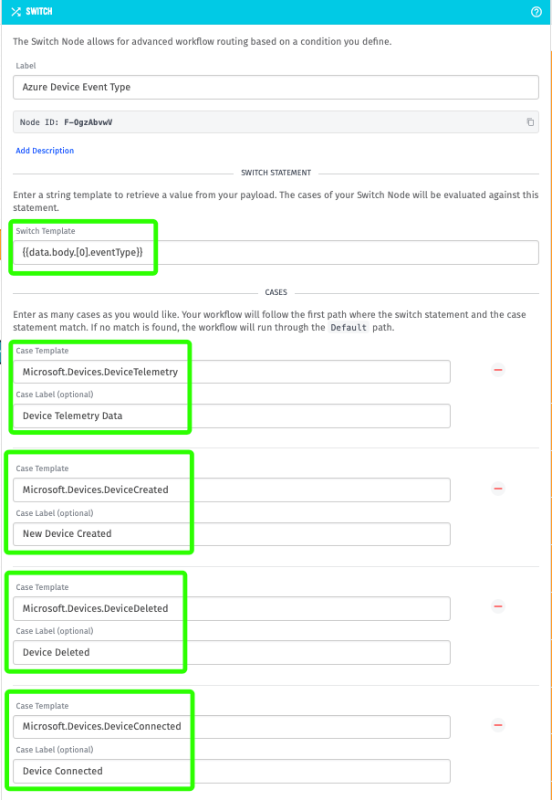

When the Event Hub subscription was created in Azure, five options existed for event types: Device Created, Device Deleted, Device Connected, Device Disconnected and Device Telemetry.
In the example workflow, you can use the Switch Node to handle each event type in Losant.
Switch Node Editor
At the payload path {{data.body.[0].eventType}} we will find the event type for the current request.

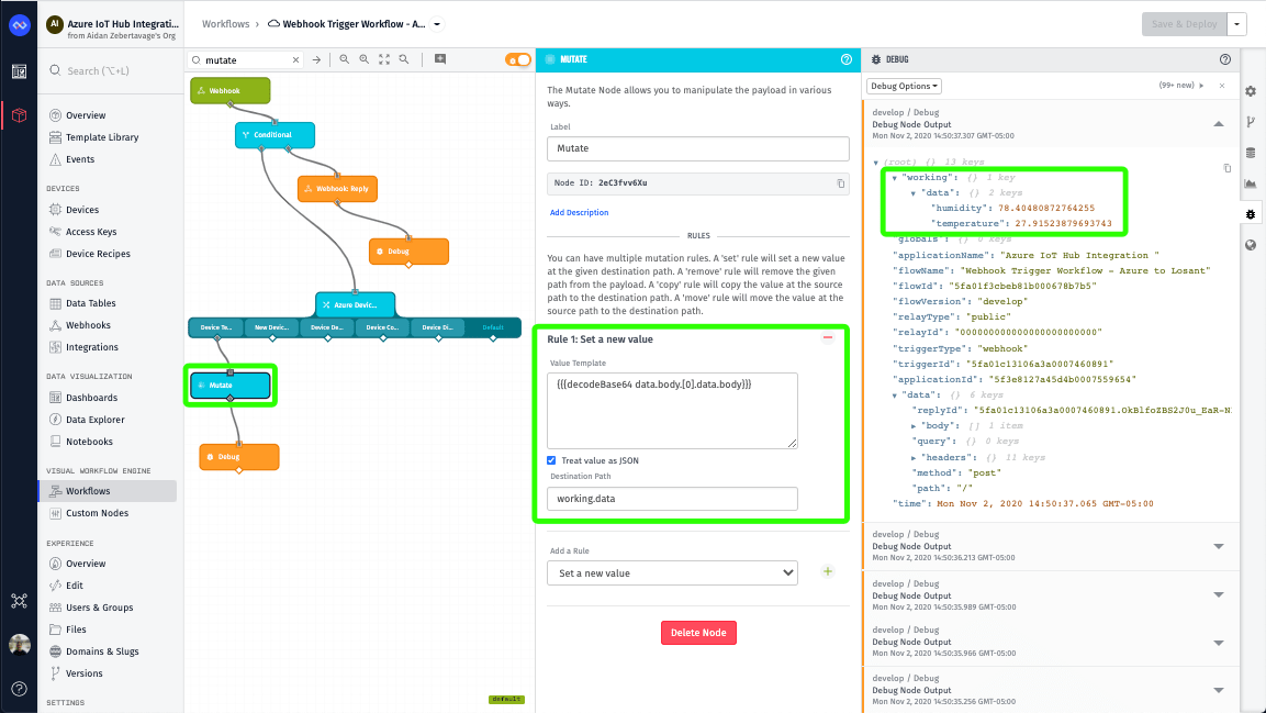

The device telemetry data from Azure for our simulated device is delivered to Losant as a Base64 encoded string, this will need to be decoded for use by our Losant device.
Using the Mutate Node, you can use templating to decode Base64-encoded payload value:
{{{decodeBase64 data.body.[0].data.body}}}
Mutate node

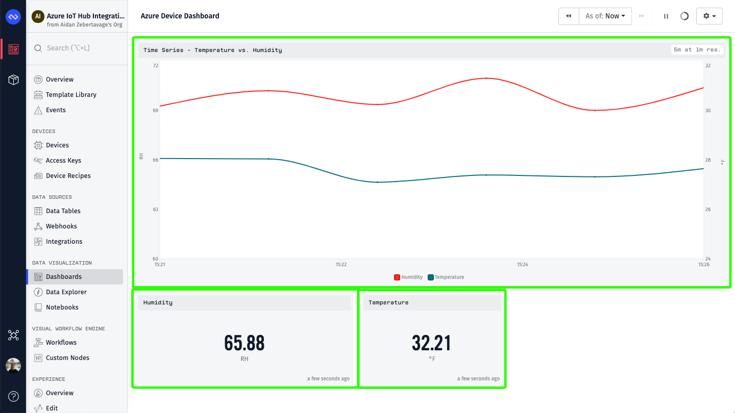

Upon completion of this workflow, device data from Azure is successfully being reported to Losant and is available for use across the Losant platform - use in other workflows, or the development of data visualization through a dashboard, as seen below:
Final Workflow
