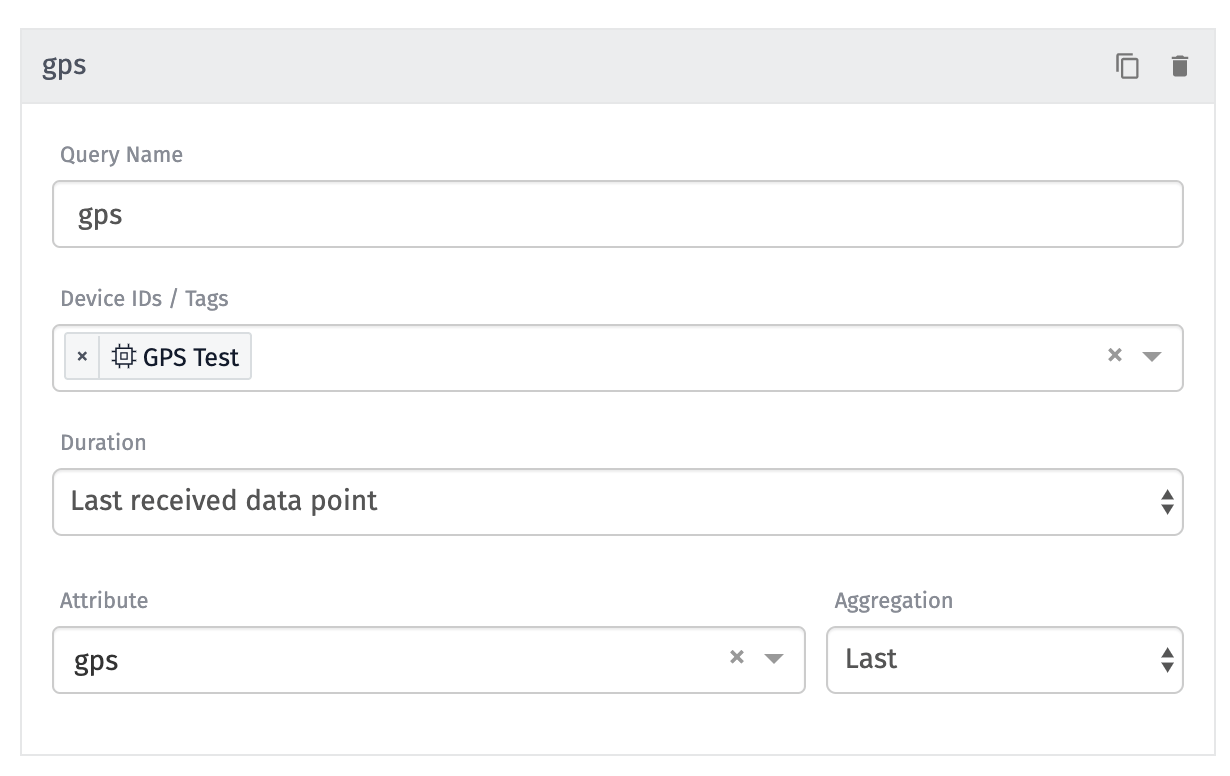

In the Custom HTML Block, you must access data by subscribing to events. You can configure which data to query using the "Queries" configuration:
GPS Data Attribute Query
For this guide, configure the block using a Gauge Query and set the following:
  • Query Name: Use gps as the query name (This will be used later.)
  • Device IDs / Tags: For this guide, select one device.
  • Duration: Select "Last received data point."
  • Attribute: Select a valid GPS Attribute.
  • Aggregation: Select "Last."
The above returns a single value of the last received data point of the selected device. After configuration, the Block Input will look like the following:

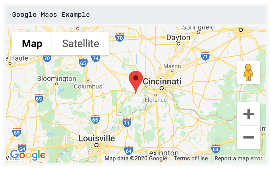

Once done, you will have a block that visualizes assets in a Losant Dashboard using Google Maps.
Google Maps in Custom HTML Block
To explore what's possible with Google Maps, see Google Maps Examples.
