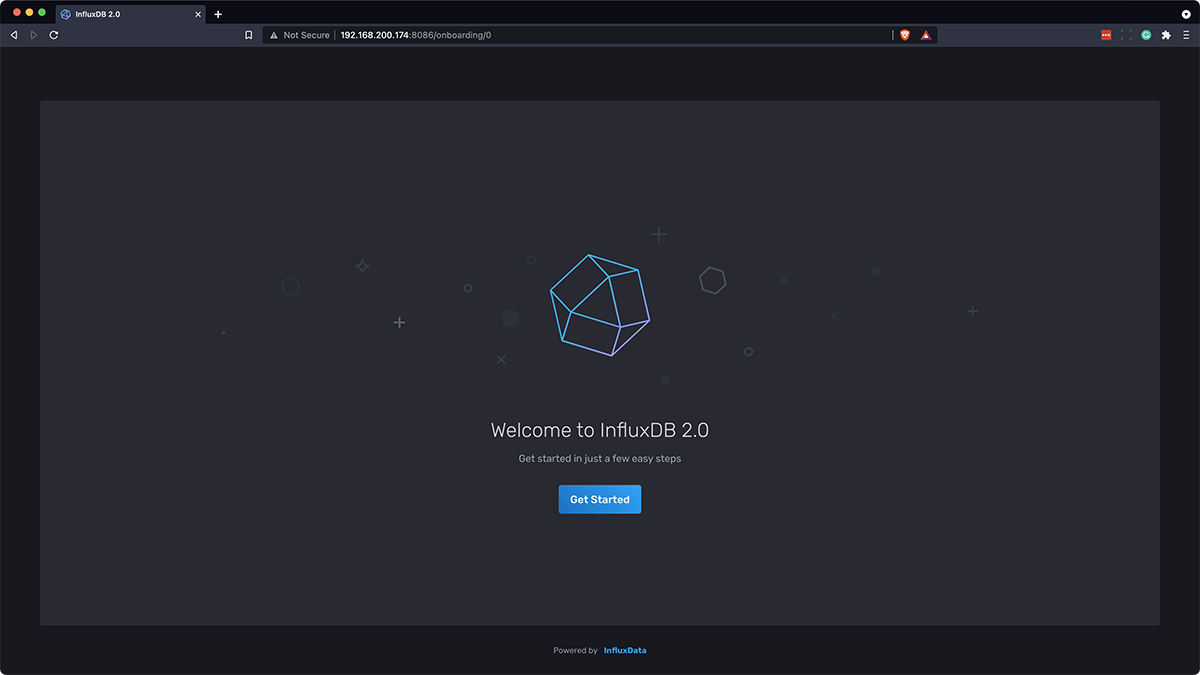

Now, you can navigate to http://<ip-address-of-gateway>:8086 and will be greeted with this screen:
InfluxDB Landing Page
So now, we’re ready to set up InfluxDB.

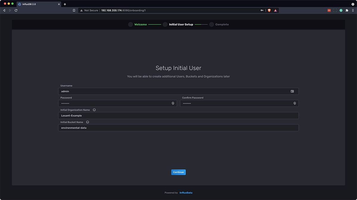

Next, click “Get Started”, and fill out the username (i.e. "admin"), password, organization name (i.e. "Losant-Example", "My Great Company"), and initial bucket name (i.e. "environmental-data" or something similar), and click “Continue.”
Initial InfluxDB Setup

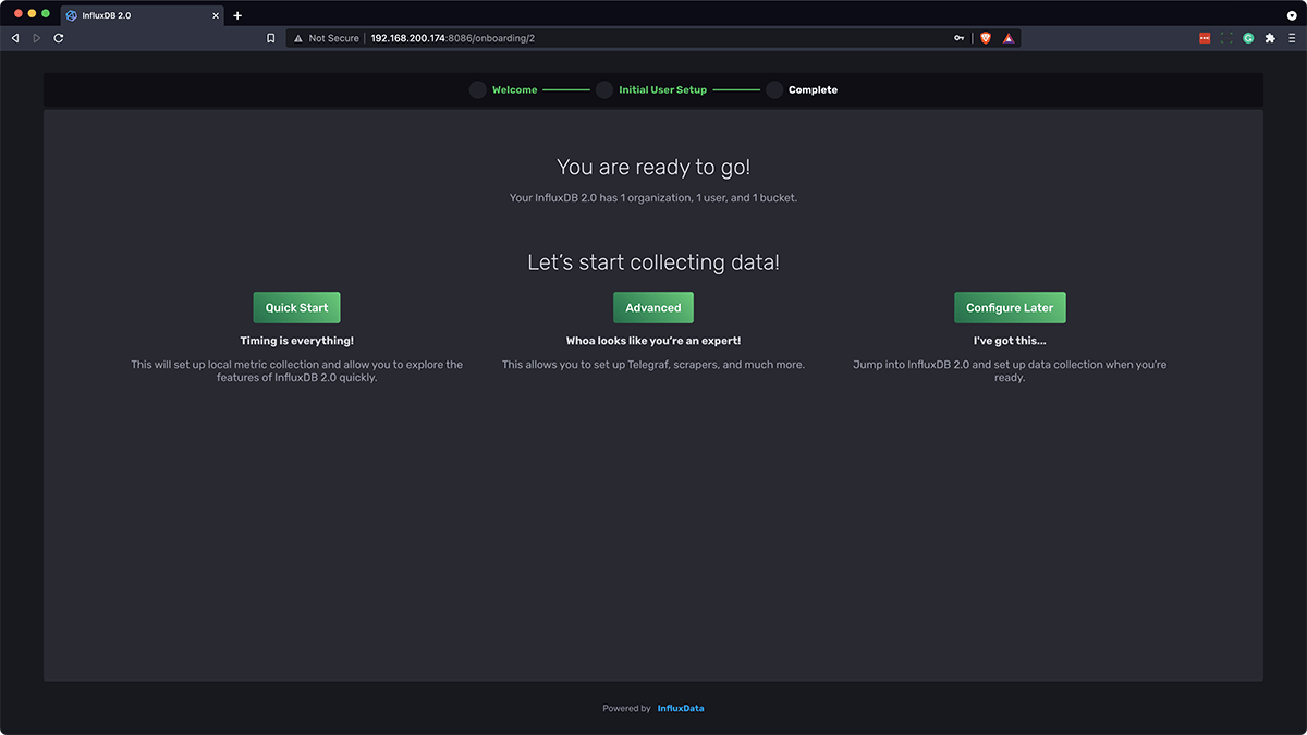

Then, on the right side, click “Configure Later”:
InfluxDB First Setup Options

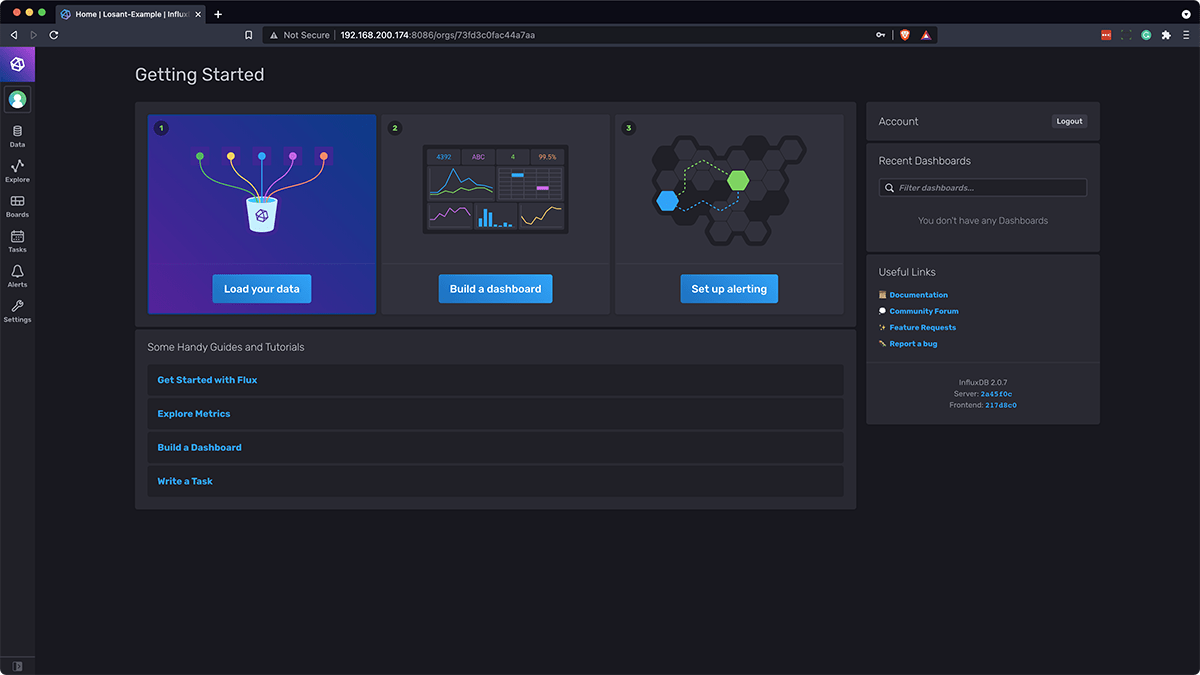

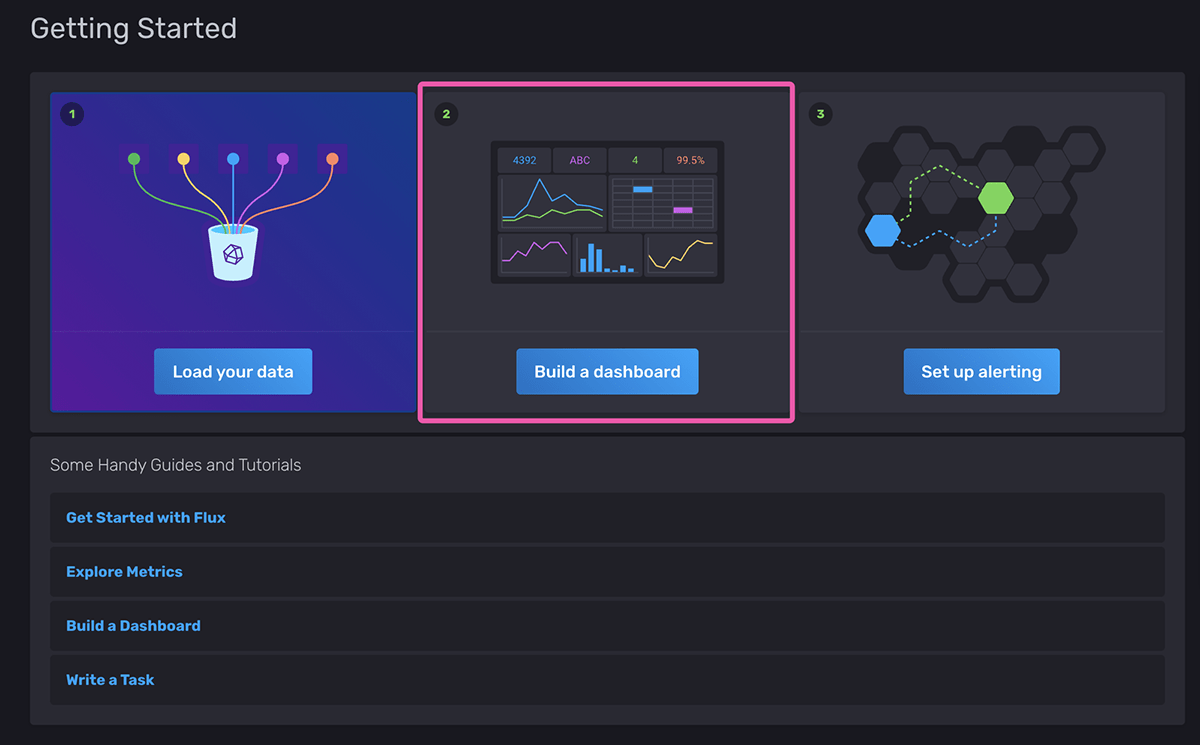

Finally, you should be greeted with this screen:
InfluxDB Homepage
And that’s it! You’ve created an InfluxDB database with an admin user and an initial bucket and are now ready to start getting data from your Gateway Edge Agent to your InfluxDB container.

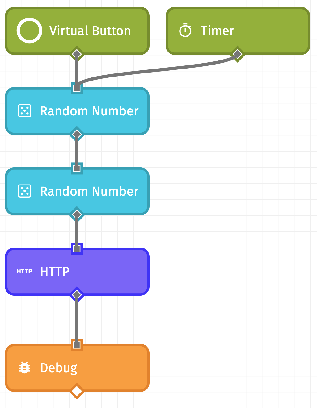

Now, let’s make a simple Losant Edge Workflow that looks something like this:
Losant Edge Workflow for sending data to InfluxDB
As you can see, this workflow consists of a Virtual Button Trigger, a Timer Trigger set to a simple timer of 10 seconds, two Random Number Nodes (both with minimum values of 0 and maximum values of 100), an HTTP Node, and a Debug Node. The first Random Number Node is going to be our simulated “Temperature”, so we put the value at data.temperature, and the second Random Number node is our simulated “Humidity”, which we place at data.humidity. This workflow does not send device state up to the Losant Cloud, but if you would also like to report your data to the Cloud for further analysis and other business logic, you can do so by adding a Device: State Node.

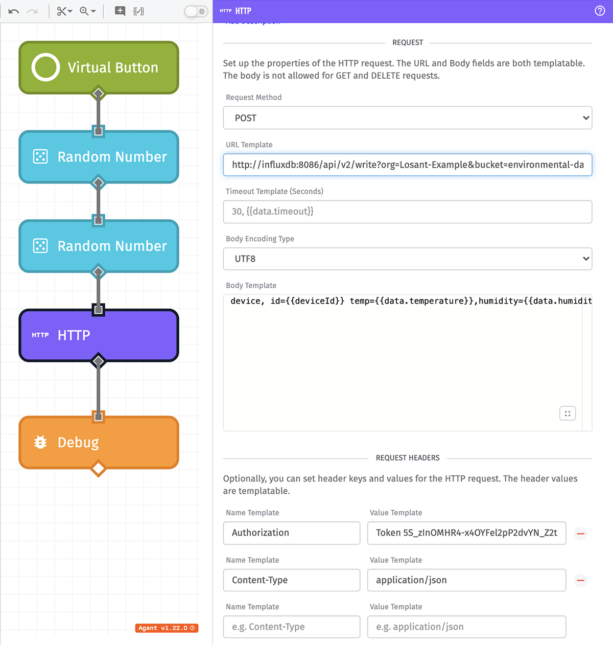

Next, we have the HTTP Node. It requires the most configuration, so let’s walk through it.
Losant HTTP Workflow Node Configuration
Let’s break down the HTTP Node configuration. We’re making a POST request to the address:
http://<name-of-influx-container>:8086/api/v2/write?org=Losant-Example&bucket=environmental-data
  • <name-of-influx-container> is the name of the InfluxDB container that you used in Part 2 with the --name flag in the Docker run command. In this case, --name influxdb was used so our address is http://influxdb:8086
  • org is the name of the org we created in Part 3, or “Losant-Example”
  • bucket is the name of the bucket we created in Part 3, or “environmental-data”
Note: For more information about the InfluxDB API, check out their documentation, specifically the Write Data API.

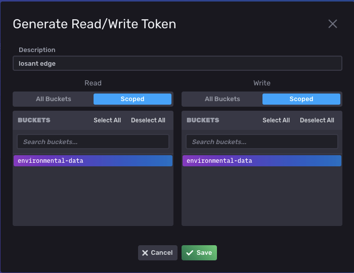

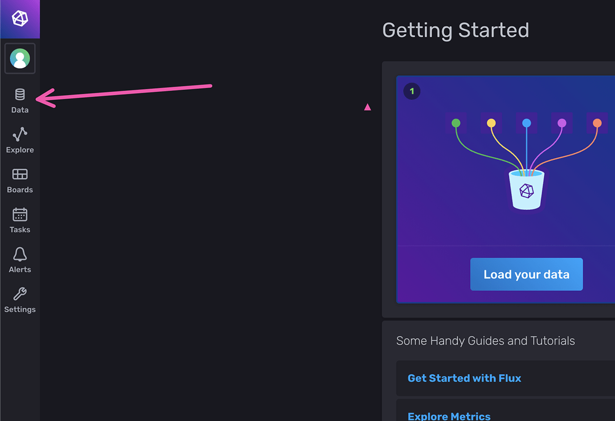

In the Request Headers, we need an Authorization token, which you can create by going back to the InfluxDB UI and clicking Data:
InfluxDB navigation menu with the Data tab highlighted

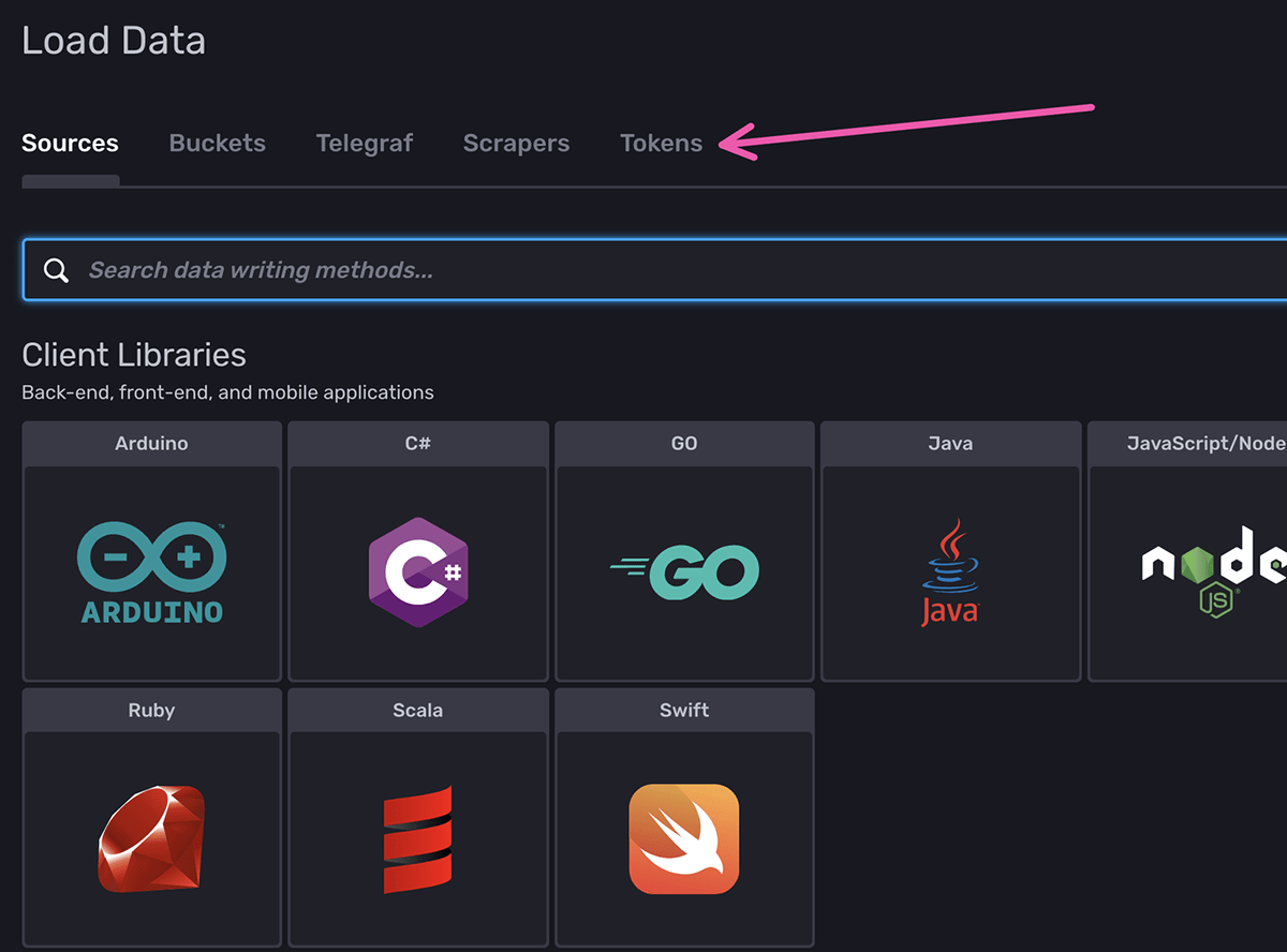

Then, click “Tokens”:
InfluxDB Data screen with Tokens highlighted

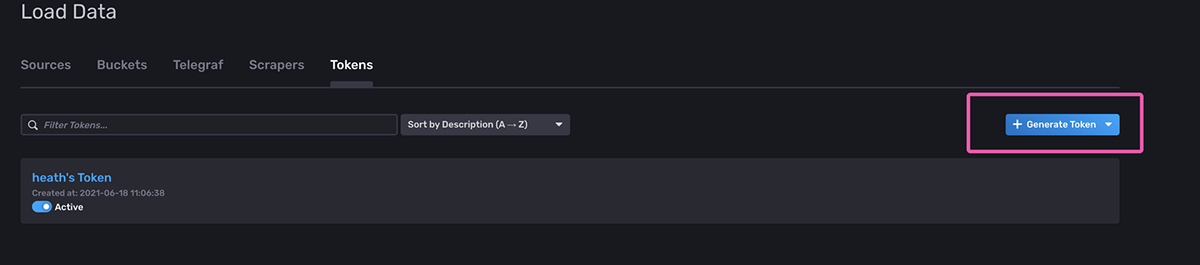

Next, in the top right, click “Generate Token” and click “Read/Write Token”:
InfluxDB Token screen with Generate Token highlighted
Then, we want to scope the token to the bucket we created (it’s also a good idea to add a description for this token):
InfluxDB token generation configuration modal

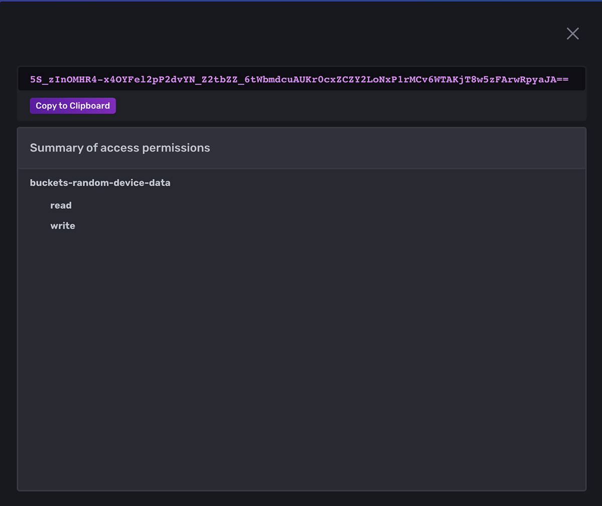

Once you click Save, you will be taken to the main token screen again. Click the token you just created and click “Copy to Clipboard”:
InfluxDB token information modal

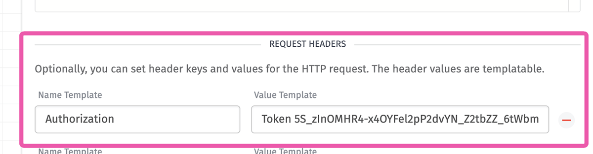

Now that the Authorization token is in your clipboard, go back to the HTTP Node configuration in Losant and paste it with Authorization as the name, and Token YOUR_TOKEN_HERE as the value. Your Authorization Request Header should look like this:
Losant HTTP Node authorization header information
For the body of the request, we are sending those two random values as temperature and humidity to InfluxDB as:
device,id={{deviceId}} temp={{data.temperature}},humidity={{data.humidity}}
This follows InfluxDB’s Line Protocol to insert data into the data store. For this example, device is the name we are giving to the measurement. id is a tag for that measurement. When different device IDs are used, InfluxDB will give you the ability to add dashboard cells for different devices by ID, or add cells that show multiple devices at once. temp and humidity, separated by a comma, are the field set for this reading.
In a case where your gateway is reading values from peripherals, you would add the ID of the peripheral to the payload and instead of referencing {{deviceId}}, you would reference the ID of the peripheral. Further, you could leverage the #each template helper to add multiple lines for multiple different peripheral devices in one request.
This HTTP Node configuration and body syntax are the cornerstones of this workflow. Once you have this working, you can reuse this HTTP Node in multiple workflows to send specific data to an InfluxDB Bucket. You can even create separate buckets in InfluxDB to categorize your data.

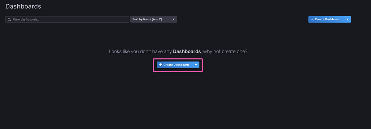

Then, click “Create Dashboard”:
InfluxDB Dashboard page with Create Dashboard highlighted

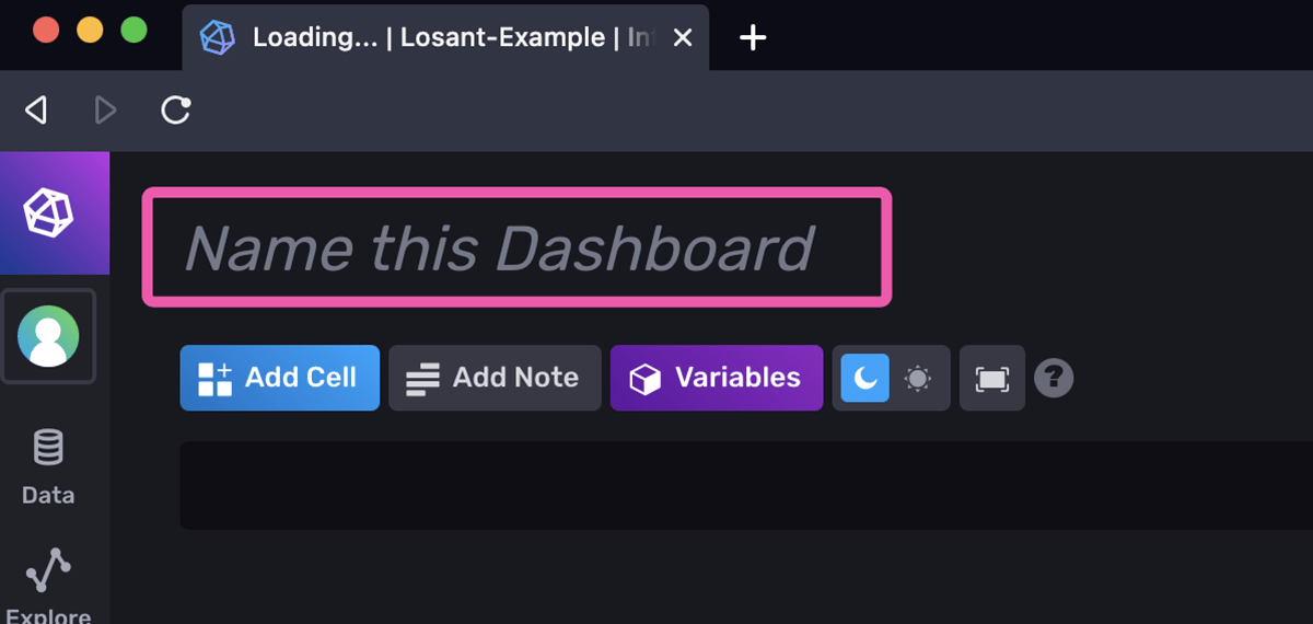

In the top left, where it says “Name this Dashboard”, let’s name it “Temperature & Humidity.” Then, underneath, click “Add Cell”:
InfluxDB dashboard name highlighted

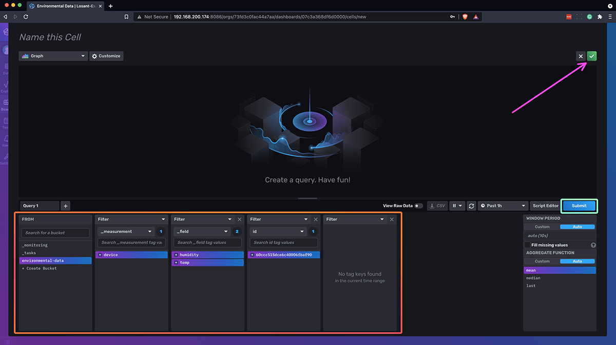

For this example, we’re going to create a Graph cell, making sure that the environmental-data bucket is selected. Then, check the box for device, the boxes for humidity and temperature, the box for the ID of the device reporting its data, choosing the last aggregate function, and finally click submit, which will set the query used for this dashboard cell. Your modal should look something like this:
InfluxDB dashboard cell configuration modal with options highlighted

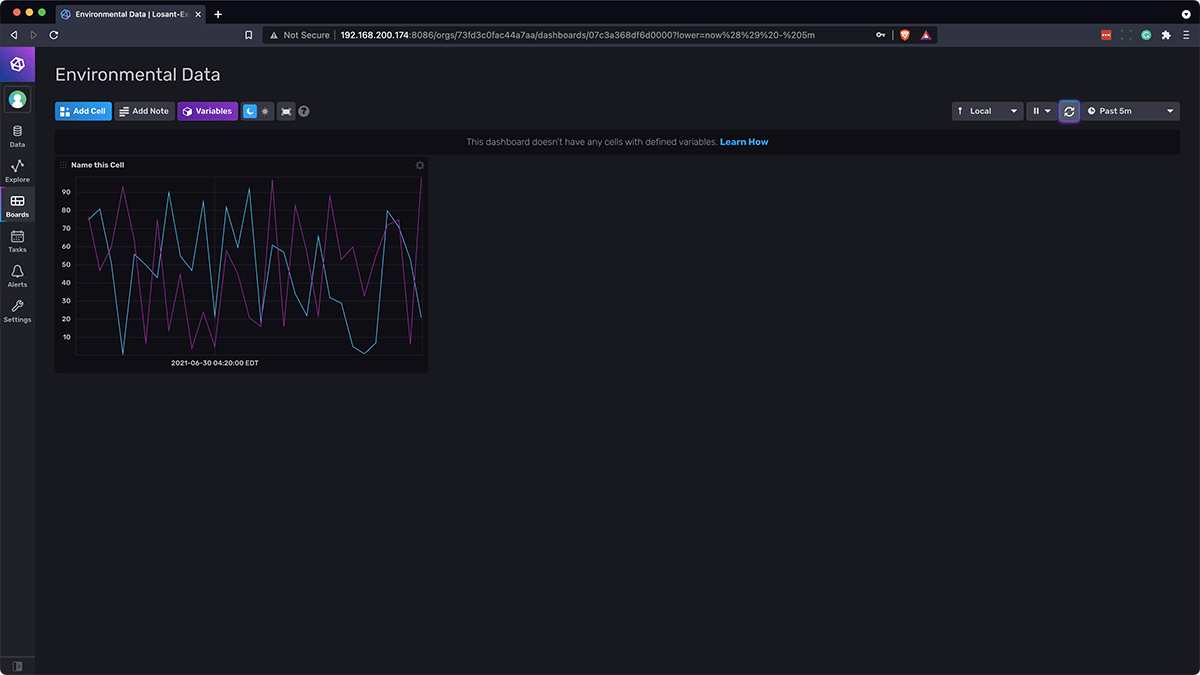

Your dashboard should now look similar to this (you may need to press the Virtual Button a few times in your edge workflow to send data to InfluxDB):
InfluxDB dashboard with data populated in dashboard cell

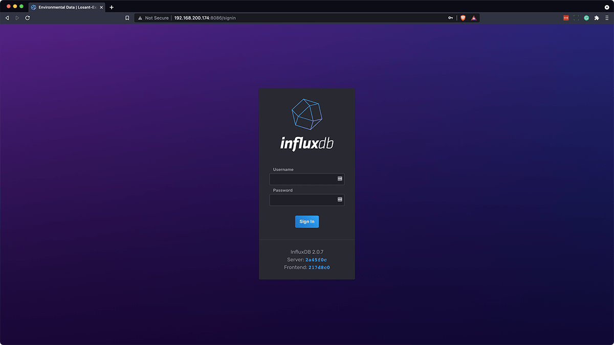

To access the dashboard you just created, while on the same network as the device running InfluxDB go to the URL of the dashboard on a different machine. Once you press enter, you will be taken to this screen:
InfluxDB login page
To sign in, enter the username and password that you used in Part 3. This user is the database admin who has full permission over this database. If you would like to create a new user, you can follow the InfluxDB documentation to create a user with the CLI, so that those who log in to view your dashboard cannot remove resources.

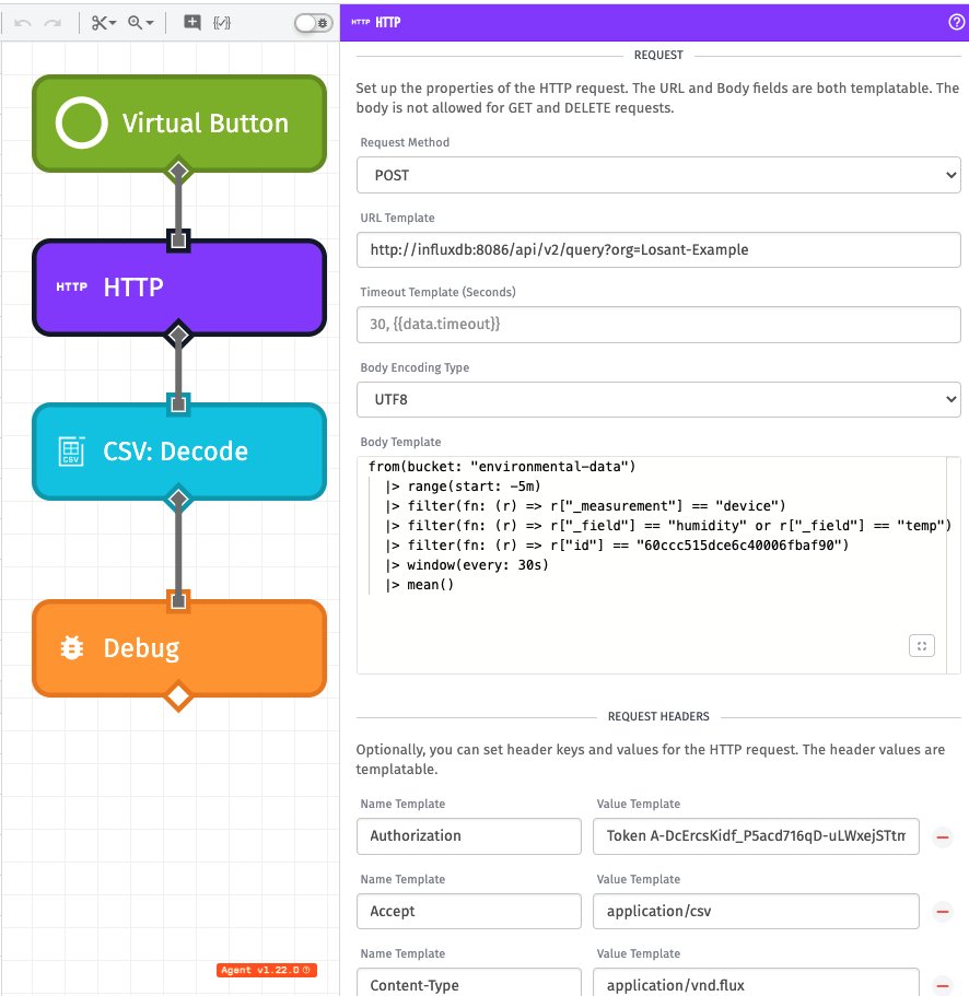

As more and more data is sent to InfluxDB, you may want to query that data for use in a Losant Workflow. Let's query some data that we're sending from the workflow above. To query data from InfluxDB using the GEA, make a new edge workflow that looks like this:
Query InfluxDB Workflow
This workflow is a bit similar to the workflow earlier in this guide and consists of a Virtual Button Node, an HTTP Data Node, a CSV: Decode Node, and a Debug Node.
The HTTP Node, again, requires the most configuration, so let's take a closer look:
Query InfluxDB HTTP Node Configuration
We are making another POST request to http://influxdb:8086/api/v2/query?org=Losant-Example. This URL is a bit different than the one we used in the previous HTTP Node, so let's break it down:
  • The root of the URL is still the same as Part 3; you are still making a request to http://<name-of-influx-container>/api/v2 where <name-of-influx-container> is the name you used with the --name flag in the Docker run command you used to start the InfluxDB container.
  • Instead of the write API endpoint, we are using the query endpoint with a query parameter of our organization name that we set up in Part 3. In this case, we use Losant-Example.
Now, let's take a look at the body we are sending in this POST request:
from(bucket: "environmental-data")
|> range(start: -5m)
|> filter(fn: (r) => r["_measurement"] == "​​device")
|> filter(fn: (r) => r["_field"] == "humidity" or r["_field"] == "temp")
|> filter(fn: (r) => r["id"] == "60ccc515dce6c40006fbaf90")
|> window(every: 30s)
|> mean()
InfluxDB uses its own Flux Querying Language to build queries for data, and it is unique, so let's break it down:
Here we are requesting data from the environmental-data bucket that was set up in Part 3.
range(start: -5m)
range with a start of negative 5 minutes is retrieving the last 5 minutes of data.
|> filter(fn: (r) => r["id"] == "{{deviceId}}")
These filter functions are similar to SQL WHERE statements, which are being used to filter the measurement, field, and id of the data.
|> window(every: 30s)
|> mean()
These two lines are Window and Aggregate methods that, in a way, put the returned data from the range and filters into "buckets" for the mean() aggregate function to run.

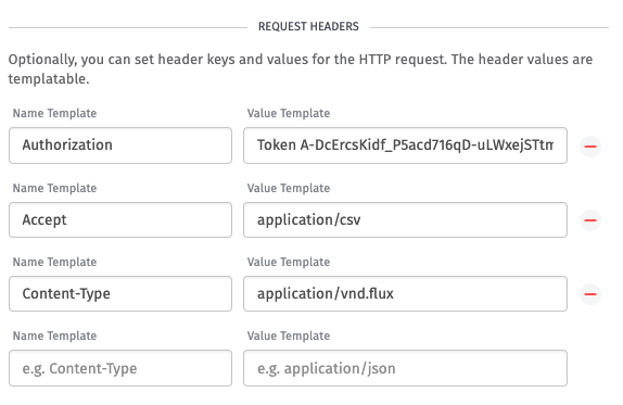

The request headers for this HTTP node are different, as well.
Query InfluxDB HTTP Node Request Headers
We are still using the same Authorization header with a value of Token YOUR_TOKEN_HERE. But this time, we are adding:
  • Accept header with a value of application/csv
  • Content-Type of application/vnd.flux
Note: All of the headers mentioned for this request are required.

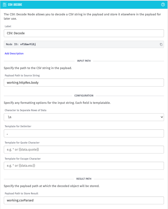

Then, the HTTP response that InfluxDB provides is stored on the payload at the path working.httpRes. With a successful HTTP request, the response data you will receive is encoded CSV data. So, in your workflow, you use a CSV: Decode Node to decode the response data. The CSV: Decode Node is configured as follows:
CSV: Decode Node configuration
The CSV data returned by the query is comma-separated, and separates rows with \n. Then, the parsed CSV data is stored back on the payload at working.csvParsed to then be operated on in subsequent nodes, or in another workflow.

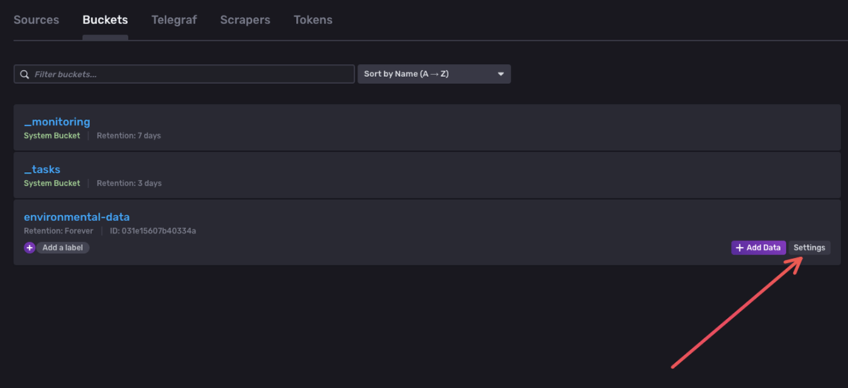

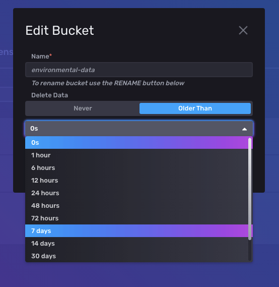

InfluxDB Data Retention Considerations​
InfluxDB does allow you to change the retention policy of each bucket that you create. The way the bucket environmental-data was created in this guide, the retention policy is Forever. This is acceptable for testing purposes, but in a production environment using the Forever retention policy will end up using all of your gateway's storage space.

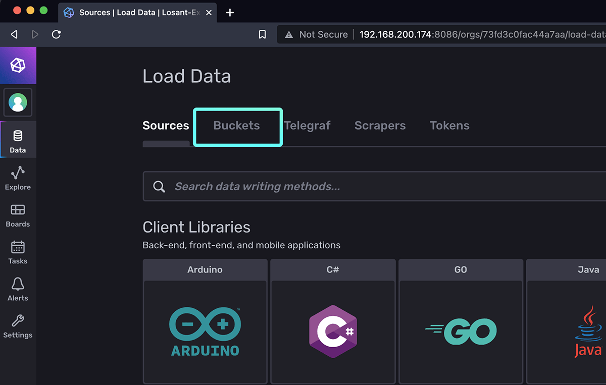

To change this policy, click on Data in the left navigation menu of the InfluxDB UI:
Then, click “Buckets” at the top:
InfluxDB Data page with Buckets highlighted
Then, for the environmental-data bucket, click the “Settings” Icon:
InfluxDB bucket settings icon highlighted
Click where it says “0s” to open the dropdown window, and you can select a data retention policy that fits your use case. For example, 7 days:
InfluxDB bucket retention configuration modal
