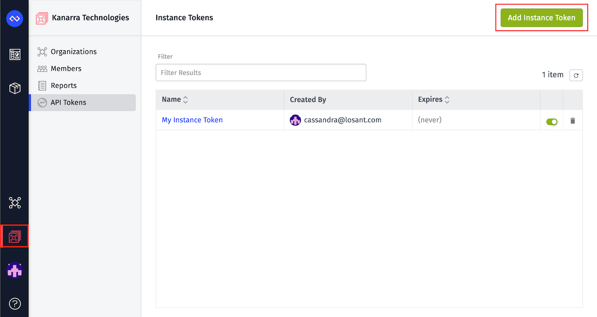

Generating an API Token
Instance API tokens can be added to your instance by using the Add Instance Token button on the API Tokens page. Token setup requires four pieces of information:

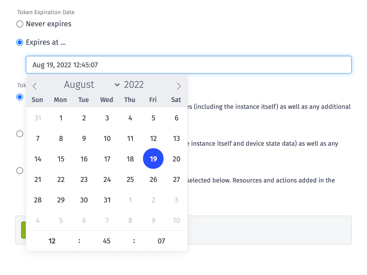

Token Expiration Date
By default, the "Never expires" option is selected. This means that by default the token will never expire. Optionally, if you would like the instance token to expire, choose "Expires at ..." and then set a future date/time after which requests using this token should no longer be accepted. The default expiration date with this option is one year from creation.
Instance Token Expiration
Note: The expiration date cannot be changed after token creation. If the expiration date passes while the token is in use, you will have to generate a new token and replace it within your authentication requests.

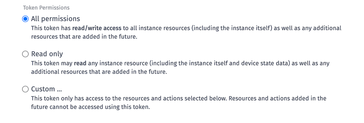

Token Permissions
There are four options for setting the token's scope ...
Instance Token Permissions
Bounded read/write permissions (recommended) allows the token to create, read, update, and delete all instance resources as well as any additional resources that are added in the future. Execeptions include managing API tokens, instance members, organization members and invitations.
All permissions (including token management) allows the token to create, read, update, and delete all instance resources (including the instance itself) as well as any additional resources that are added in the future. Note: This permission level is not recommended, as the token can be used to elevate its own permissions by creating new tokens that give it additional scope.
Read only allows the token to read – but not modify – all instance sub-resources (including the instance itself) as well as any additional resources that are added in the future.

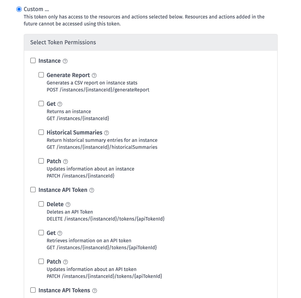

Custom ... allows for selecting specific resource / action combinations from the instance that the token should be allowed to access. Choosing this option reveals a list of all instance-specific API calls in the Losant Platform, each of which may be individually added to the token's scope.
Instance Token Custom Permissions
The checkboxes next to the resource names will automatically check or uncheck all actions under that resource. However, checking such a box does not provide the token access to any new actions that may be added under that resource in the future. If a new action is added under a resource, and you would like your token to have access to that action, you will have to generate a new token.
Note that a token's scope cannot be changed after token creation. If you find you need additional permissions not allowed by the token, you will have to create a new token. Likewise, if you would like to revoke permissions originally supplied to a token, you will have to delete the token and create a new one with the desired scope.

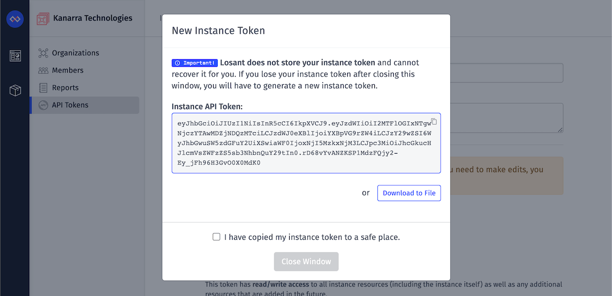

Getting the Token
After clicking Create Instance Token, the newly created token will be displayed. You will either need to copy it to a secure location or download it to a file on your computer.
IMPORTANT: Losant does not store API tokens and they cannot be recovered or regenerated if lost. If you fail to save your token before closing the modal, you will have to generate a new instance API token.
When you're finished, check the I have copied my instance token to a safe place. box and click Close Window.

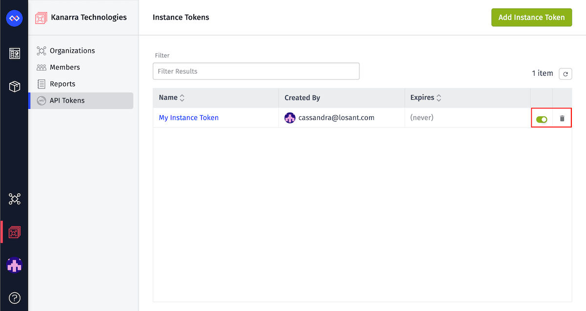

Deleting / Deactivating an API Token
To temporarily deactivate an instance API token ...
  • Toggle the switch in the list view, OR
  • From the token's detail page, select the "Inactive" radio button under the "Status" label and save the token.
Delete Instance Token
If a token has expired, is no longer needed, or is thought to have been compromised, you may permanently delete it by:
  • Clicking on the Delete icon in the token list, OR
  • Clicking the Delete Instance Token button on the token's detail page
