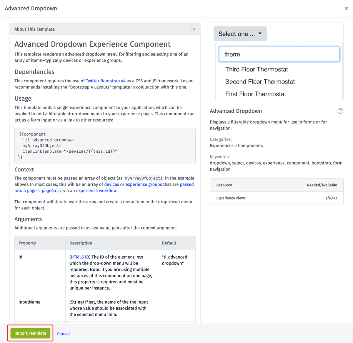

Import Template
When a template is imported, those resources are automatically added to your application. A single template should only be imported once per application. If an import of the same template is attempted multiple times, the import is likely to fail due to conflicting resource names or other identifiers.

The Template Library contains several Experience Components, which provide a wide variety of pre-built functionality. Every component is named with a tl prefix and displays in your experience's "Components" folder after it's imported.
Components can support a wide variety of arguments to change its appearance or behavior. Refer to the component's README for instructions. All components are used with the following syntax:
{{component 'tl-component-name' context arg1=value arg2=value}}
Components in the Template Library are built using Bootstrap v4 and support any theme you apply. Components render their content into the page wherever they are used. The example below uses the Advanced Dropdown component to display a device filter inside the div element with the ID device-filter.
