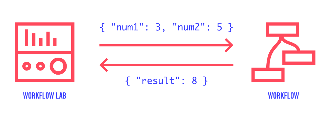

The Workflow Lab is broken into test suites (Math, Array, etc.) which contain individual tests. Each test triggers a workflow with random input and expects a specific output. For each test, your job is to build an Application Workflow that performs the test logic. Here is an example of the test description:
In this test, A JSON object containing two random numbers, "num1" and "num2", will be provided to your webhook. Your workflow should return a JSON object containing a single field, "result", that is the sum of "num1" and "num2".
From these instructions, your workflow is provided num1 and num2. In a workflow, you must add these and return the result.
The Workflow Lab doesn't use any hidden functionality to send data to your workflow. Behind the scenes, it simply uses Webhooks. The test input is sent as JSON in the body of the webhook request, and the Lab parses the response as the test output.

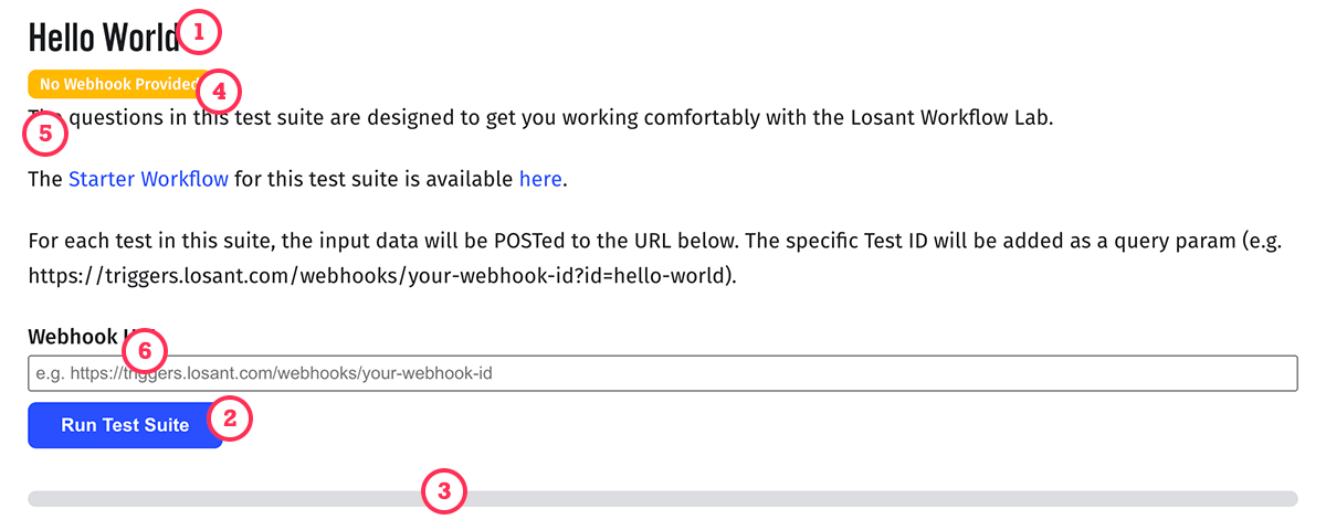

If you click on the suite above, it expands. Let's take a look at the anatomy of a suite, test, and example workflow.
Suite Anatomy
Suite Anatomy
  1. Suite Title - This is simply the title or theme of the suite. Each test within the suite is grouped based on this theme.
  2. Run Test Suite - This is how you run the entire suite of tests. If you press this, the Lab fires test input at the provided webhook URL for each test in the suite.
  3. Suite Status Bar - This updates based on the completion of tests. Blue in the bar color means that tests have not been run. Red means that tests have failed. Green means that tests have passed.
  4. Suite Status - This updates based on the completion of tests, and provides information to how many tests you've passed out of the total number of tests within the suite.
  5. Suite Description - In this description, you'll read about what the suite is, and why it's important.
  6. Webhook URL - Each suite allows you to provide a webhook URL. We recommend a unique webhook and Workflow per suite.

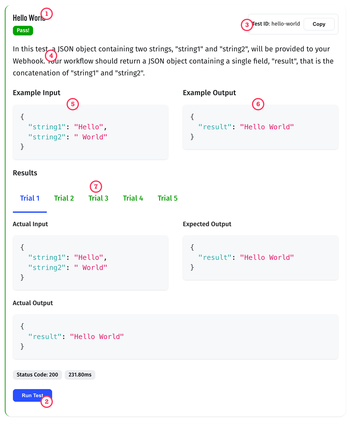

Test Anatomy
Test Anatomy
  1. Test Title - This is simply the title of the test.
  2. Run Test - This is how you run this specific test. If you press this, the Lab fires this test's input at the provided webhook URL configured for the suite.
  3. Test ID - Since we recommend one webhook URL per suite, the Test ID allows you to identify which is being run by the Lab.
  4. Test Description - In this description, you'll read about what the test is, and why it's important.
  5. Example Input - This is an example of the input the Lab sent to your workflow.
  6. Expected Output - This is an example of the output the Lab expects to see from your workflow.
  7. Results - Each time you run your test, the Lab generates random input. Here, you are able to see what was sent by the Lab, what the Lab received, and what the Lab expected. Each test is run multiple times, and you will see the result of each "Trial".

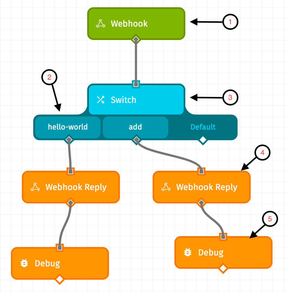

Test Workflow Anatomy
Here is an example test workflow. The beautiful thing is, we provide Starter Workflows for each suite to avoid building all of them from the ground up.
Workflow Anatomy
  1. Webhook Trigger - The Webhook Trigger fires when a run button is pressed. The Lab sends input values in the body (data.body) of the webhook request and places it on the payload.
  2. Test ID - In the Switch Node, branching is done based off of the Test ID. Since the Test ID is human-readable, it allows you to know which tests belong to which path.
  3. Switch Node - The Switch Node allows for workflow paths for each test within the suite. The Switch Template ({{ data.query.id }}) is the location of the Test ID on the payload.
  4. Webhook Reply Node - Sending your test output back to the Lab is done with a Webhook Reply Node. It sends the JSON formatted result as the body of the webhook response.
  5. Debug Node - Adding a Debug Node to the end of a workflow path gives more visibility to which values exist on the payload.

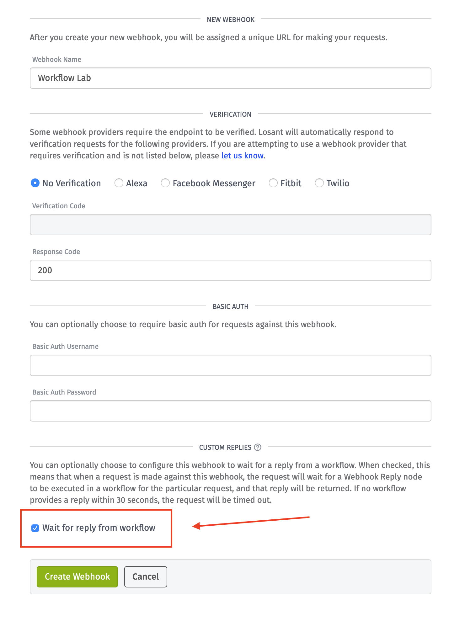

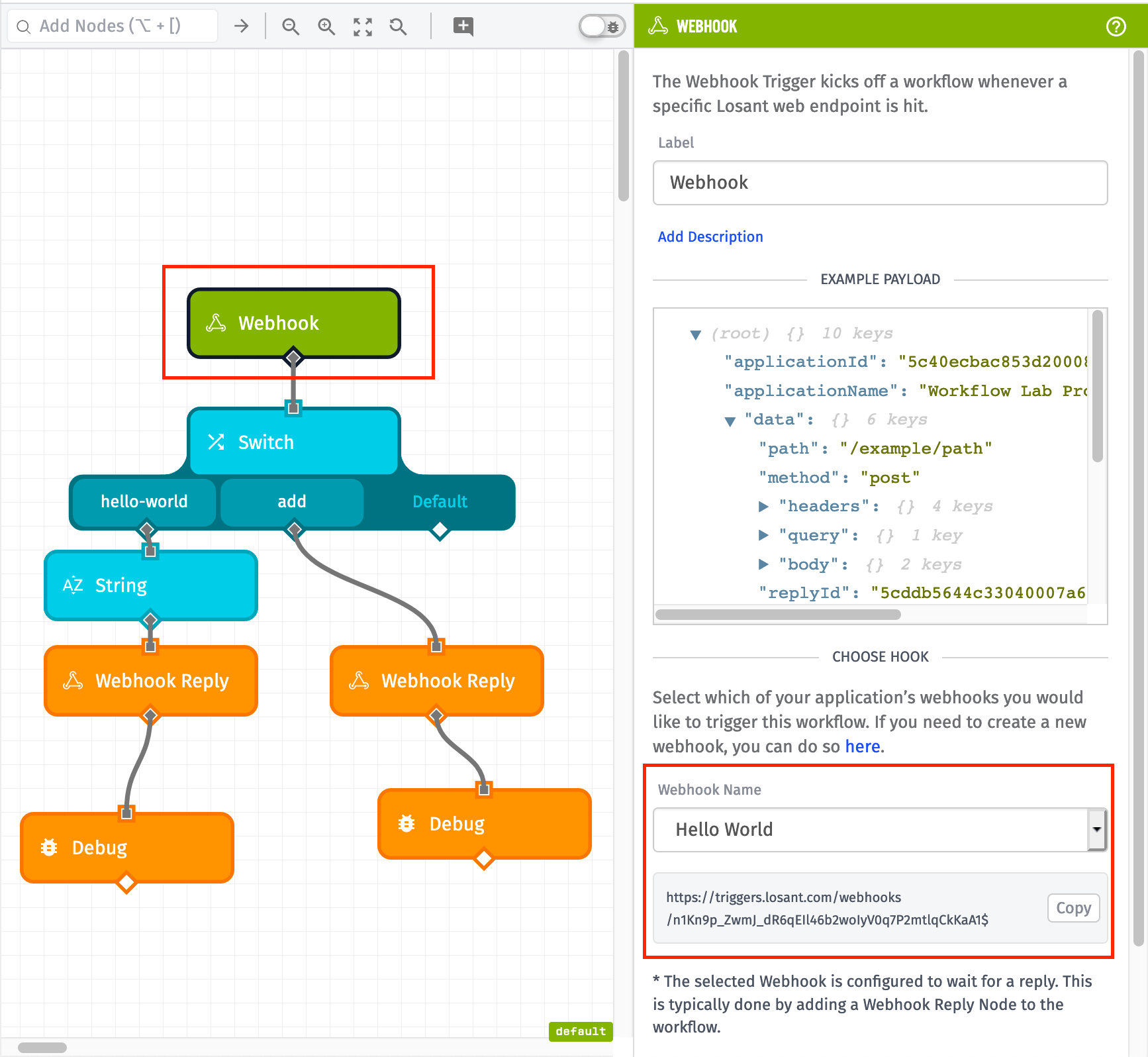

Create a Webhook
Now, let's create a webhook. We mentioned above that the test input is sent as JSON in the body of the webhook request, and the Lab parses the JSON response as the test output.
Create a Webhook with the “Wait for reply from workflow” option checked. This option is critical to ensure that your test workflow replies to the Lab.

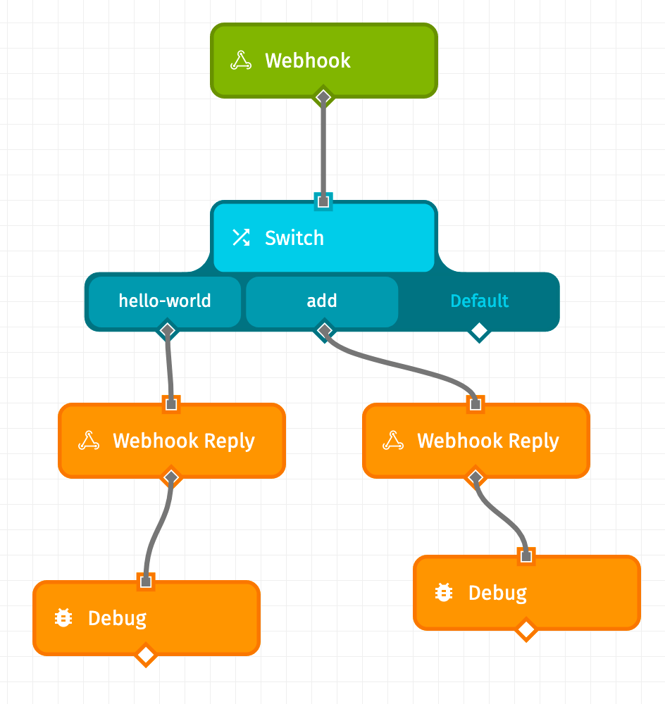

You may build these Workflows yourself, but in the Hello World Suite above, you should see: The Starter Workflow for this test suite is available here.
Let's download and import this workflow into our application. Once done, you should see this workflow:
Test Workflow Example
If you take a look a the Switch Node, you can see the Switch Template ({{ data.query.id }}). This is how the workflow knows what test we are running.
Now that we have our webhook URL, we need to configure your Webhook Trigger with the webhook you created above:
Select Webhook

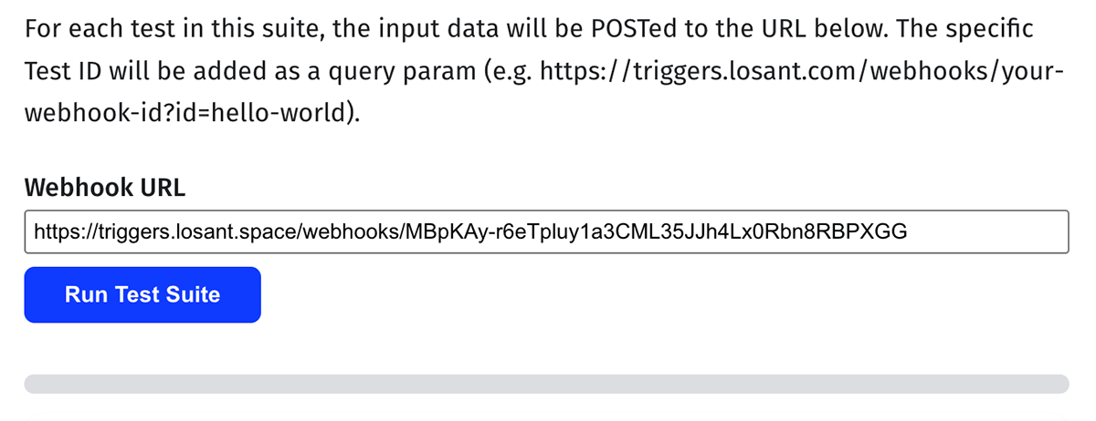

Be sure to paste in your webhook URL:
Workflow Lab URL

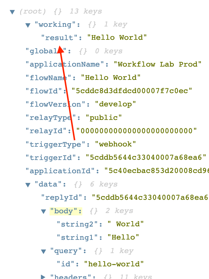

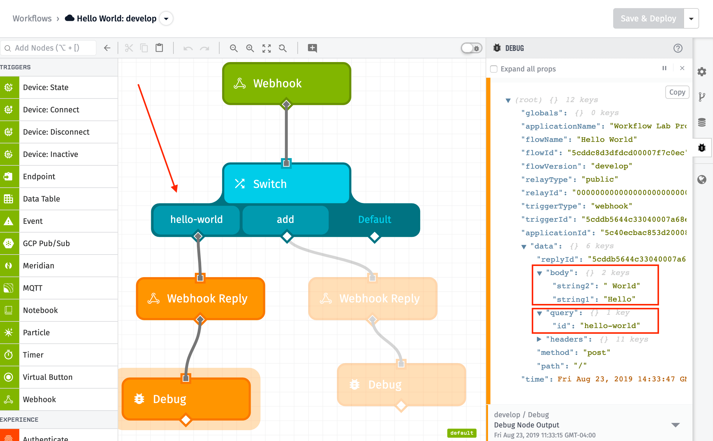

Test Run
Notice a couple of things:
  1. As we hover over the Debug output, the path of the hello-world Test ID is highlighted. This means we triggered the right test.
  2. At data.query.id you can see the Test ID that's used in the Switch Node.
  3. At data.body you should see string1 and string2. Because we are using webhooks, all Lab input will be at data.body.

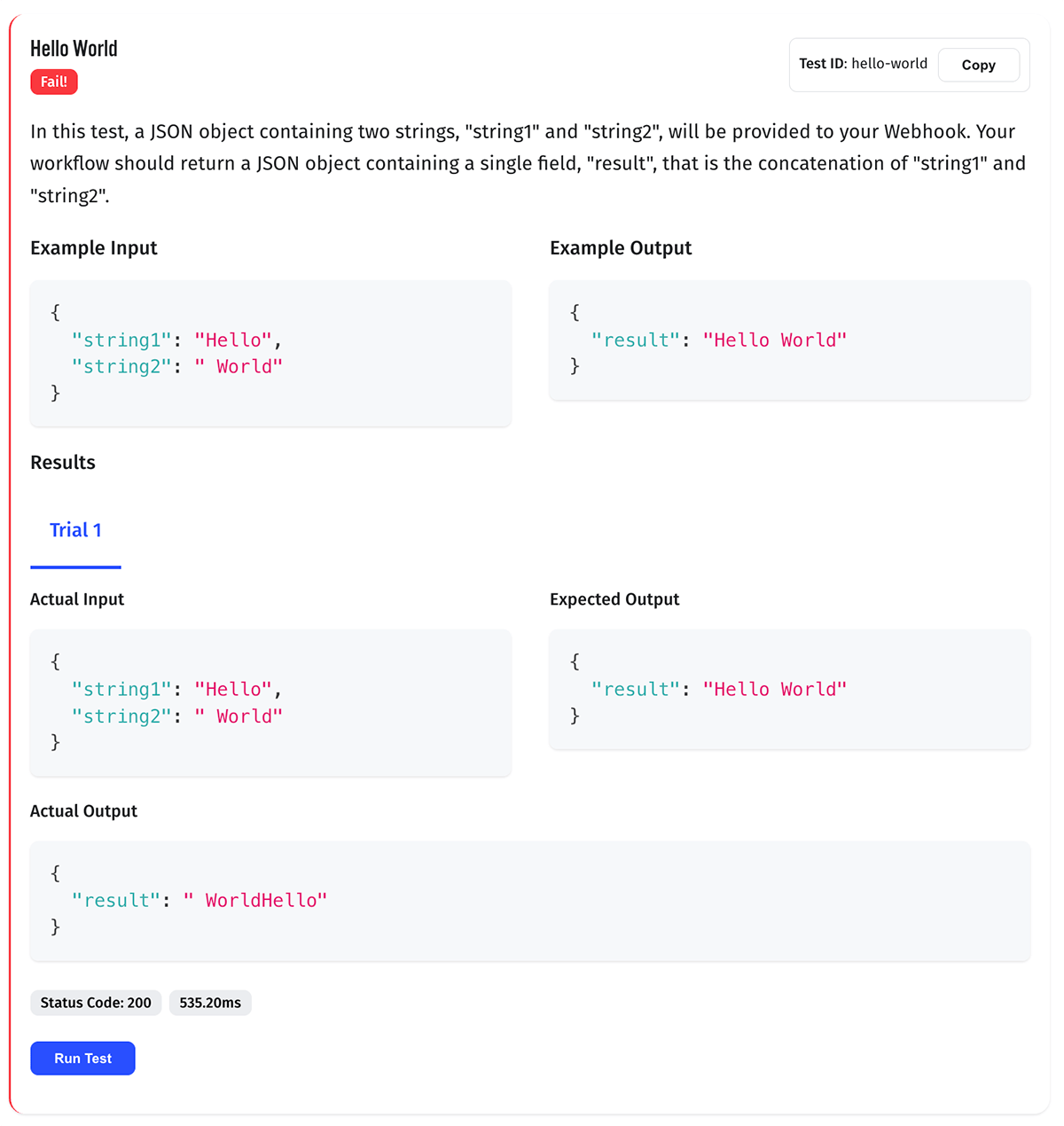

Your test should fail because we didn't actually solve the test:
Test Fail

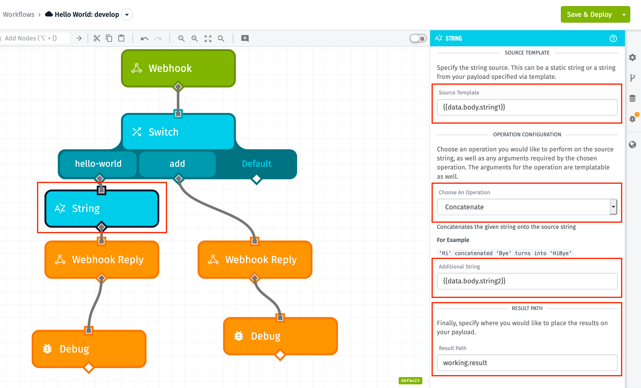

To solve this, let's use the String Node to concatenate string1 and string2:
Test Answer
  1. In our String Node configuration, we used {{data.body.string1}} and {{data.body.string2}} to use the Lab input.
  2. We placed the result of the operation at working.result.
If you rerun the test, you should see working.result with our answer:

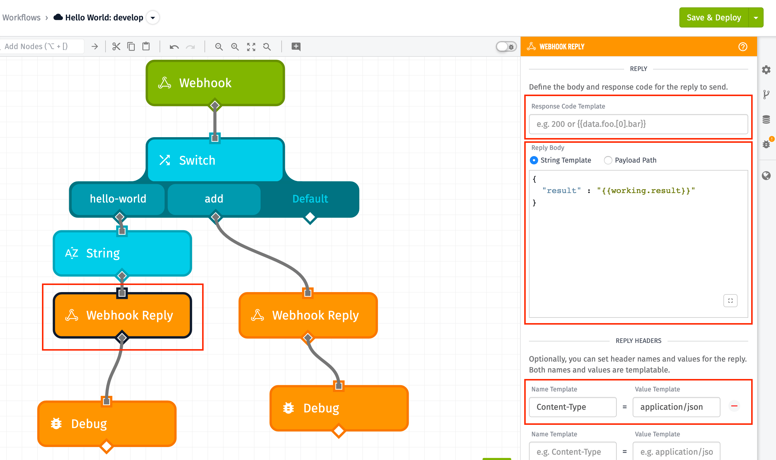

The Webhook Reply Node is how we return our results back to the Lab as output:
Test Reply
  1. In this node, you can configure the Response Code. This is important for some tests in the Lab.
  2. We are building the result object in the body of the response:
"result" : "{{working.result}}"
Since we placed the result at working.result, this body should return the Lab its expected output.
  1. We are setting the Content-Type of the request to be application/json. This is how the Lab knows to interpret your result as JSON (no other format is accepted).

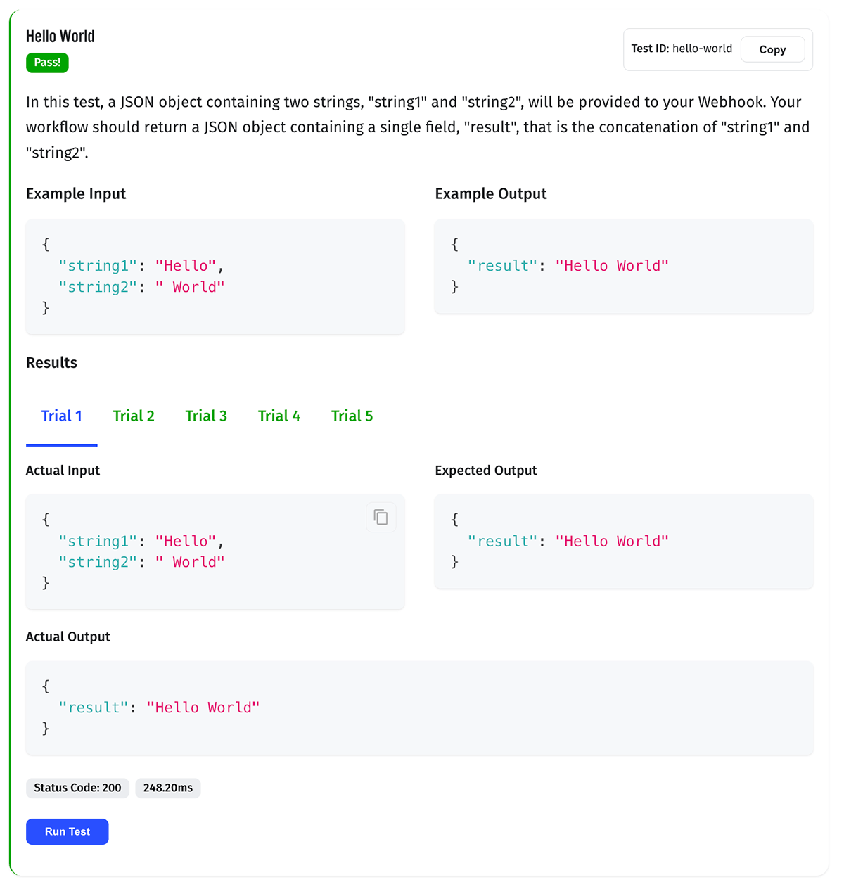

If all went well, your test should pass:
Test Pass
Notice the test trials: you can see the expected input/output and received output for each trial. In this case, it's all the same. But, in the Lab, each of these will be different.
