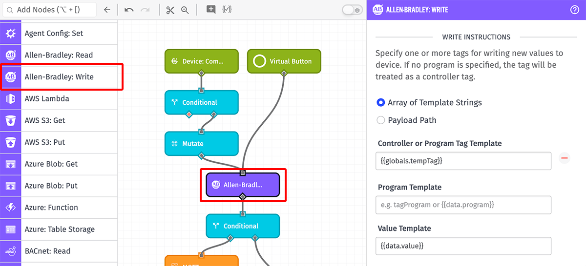

Allen-Bradley: Write Node
The Allen-Bradley: Write Node allows you to write to multiple tags on your Allen-Bradley CompactLogix or ControlLogix programmable logic controller (PLC) through EtherNet/IP. This node is only available in Edge Workflows.
There are three main parts of the configuration for this node ...

Write Instructions
You may define multiple write instructions for the Allen-Bradley: Write Node, and you must define at least one. Instructions may be defined individually as string templates, or as a payload path pointing to an array of instruction objects.
When defining instructions individually, each instruction has the following fields:
- Controller or Program Tag Template: (Required) A string template defining the tag to write a value to.
- Program Template: (Optional) A string template for the program which your program tag is a member of. In case of a controller tag (above) leave this blank.
- Data Type: Atomic (SINT, INT, DINT, REAL, BOOL) or STRING. When giving write instructions via a payload path the only valid data types are 'atomic' or 'string'.
- Note: This option is removed and has no effect in GEA version 1.54.0 or higher.
- Value Template: (Required) A string template of the value to write to the tag.
