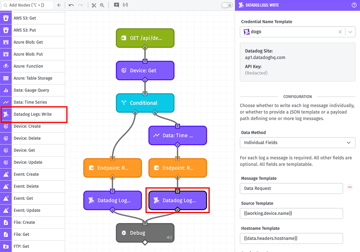

The Datadog Logs: Write Node sends one or more messages to a Datadog Log Management instance.
There are three configuration sections for this node.
Datadog Credentials​
If using the node in an Application Workflow or Experience Workflow, the node requires a Datadog service credential to authenticate the request.
If using the node in an Edge Workflow, you must enter the following properties, each of which supports string templates ...
  • Datadog Site Template: The hostname of where the Datadog instance resides.
  • API Key Template: The API key for authenticating requests to the Datadog instance. These can be created within the Datadog platform.
Next, choose a Data Method for how to define the message(s) to send to Datadog ...
Individual Fields​
When selected, all values to include in each log message are defined separately:
  • Message Template: A string template that resolves to the message to send in the log. This field is required.
  • Source Template: A string template that resolves to a string corresponding with the "ddsource" property in Datadog.
  • Hostname Template: A string template that resolves to the name of the originating host of the log.
  • Service Template: A string template that resolves to the name of the application or service generating the log events (for example, "Losant").
  • Tags Template: A string template that resolves to a string corresponding with the "ddtags" property in Datadog. This should be a comma-separated list of tags, with each tag in the form key:value. Multiple values for the same key are supported. For example:
    keyWithManyValues:Value1,keyWithManyValues:Value2,uniqueKey:Value3
    You may also provide a string template that points to a JSON object on the payload, whose keys represent tag keys and values are strings representing tag values. Multiple values for the same key are supported by providing an array of values. For example:
    "keyWithManyValues": ["Value1", "Value2"],
    "uniqueKey": "Value3"
  • Attribute Template: A JSON template that resolves to an object representing arbitrary key-value pairs to include as additional properties on the log event in Datadog. There are two keys that represent special fields ...
    • date: If provided and is a valid datetime string, this value will be used as the timestamp of the log event in Datadog instead of the time the message was received. The value must be no more than 18 hours in the past.
    • status: If provided, this value will be used as the status of the log event in Datadog. For example, "error", "warning", or "info".
