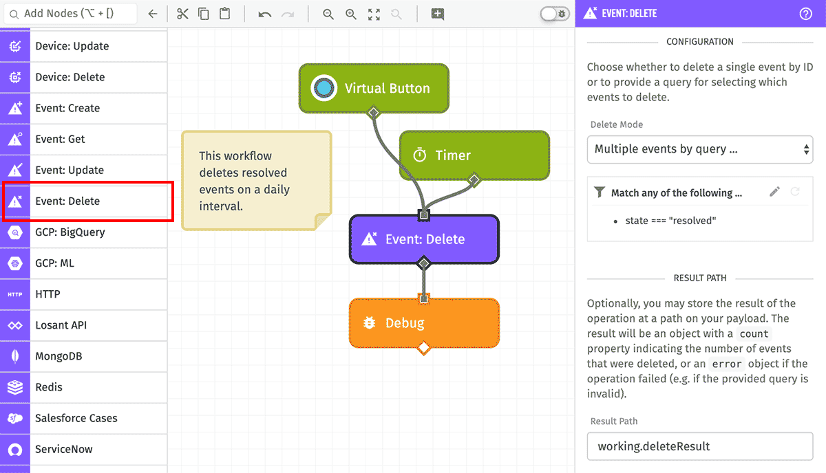

Event: Delete Node
The Event: Delete Node allows a workflow to delete one or more Events from your application.
Event: Delete Node
The configuration for the Event: Delete Node requires a query method and parameters to find the Event(s) to delete. First, choose if you would like to delete one event by ID, or multiple Events by query.
Delete One Event by ID
When choosing "One event by ID ..." as the "Delete Mode", you must provide an ID of one of your application's Events, or more likely, a template that resolves to one of your application's event's IDs.
Delete One Event by Query
When choosing "One event by query..." you must provide a valid event query to select which Event to delete.
By default, this query returns the most recently created event in a "resolved" state.
Delete Multiple Events By Query
When choosing "Multiple events by query ...", you must provide a valid event query for selecting which Events to delete. By default, this query returns all Events in a "resolved" state.
Optionally, you may store the result of the operation at a path on your payload.
