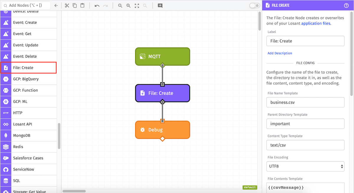

File: Create Node
The File: Create Node allows a workflow to create a file within your Application Files.
File: Create Node
The following sections describe each configuration option for the File: Create Node.

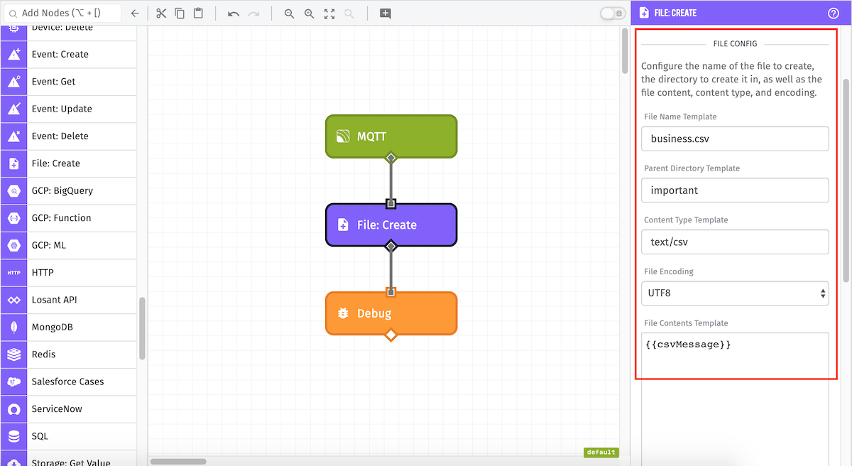

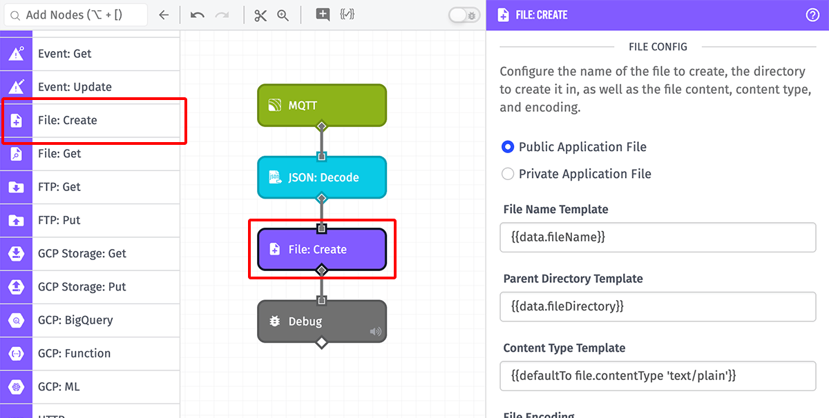

File Configuration​
First is to configure the details of the file to create. All applicable fields are templatable unless otherwise noted:
  • Public vs. Private File: (Required) Choose whether to create a public application file or a private application file. This field is not templatable.
  • File Name Template: (Required) The name of the file to create or update. The file name may not contain a slash (/).
  • Parent Directory Template: (Optional) The full path in which to create the file. If any of the specified directories do not already exist, they will be created.
  • Content Type Template: (Optional) The MIME type of the file to create. If left blank, the MIME type will be guessed based on the file name.
  • File Encoding: (Optional) The encoding of the file contents, by default this is UTF-8. The following are valid encodings: ASCII, UTF-8, UTF-16LE, Base64, Binary, Hex. This field is not templatable.

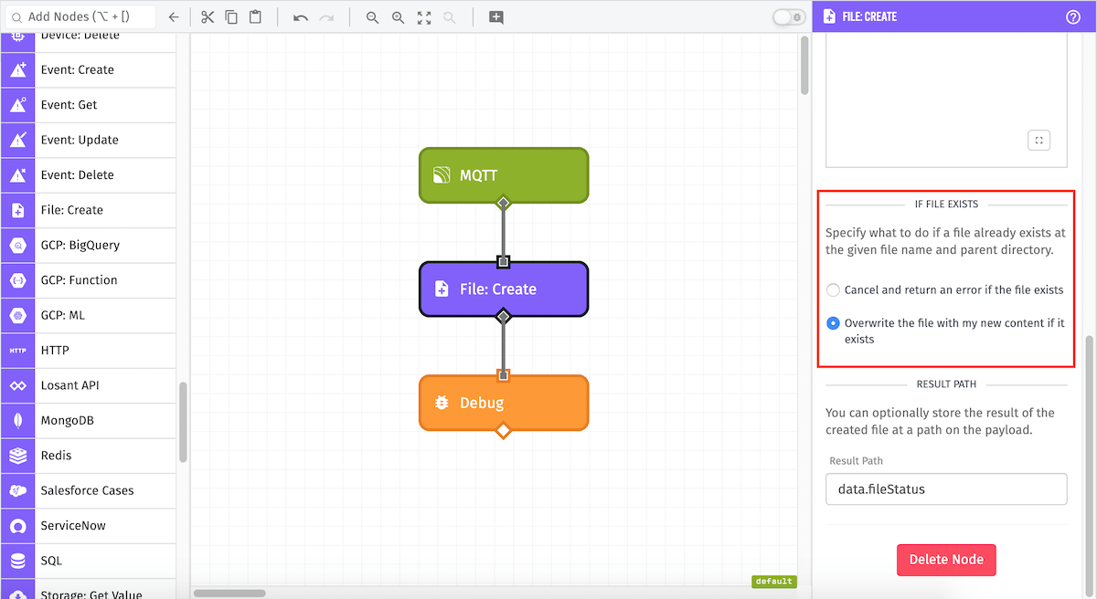

Existing File Behavior​
If your application already contains the file specified above, you can handle that in one of two ways:
  • Cancel and return an error if the file exists: (Default) This option will return an error on the payload and not write any content to the configured file.
  • Overwrite the file with my new content if it exists: This option will completely replace the file with the configured file content.

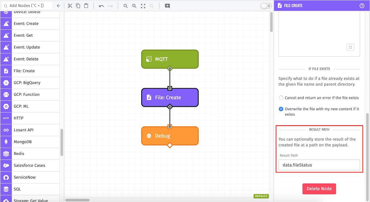

Result Path​
The result of the operation can optionally be placed at the specified payload path. If no Result Path is configured, any errors are silently discarded and the workflow continues. If the operation fails, the result object will contain an error object instead of the normal file metadata.
