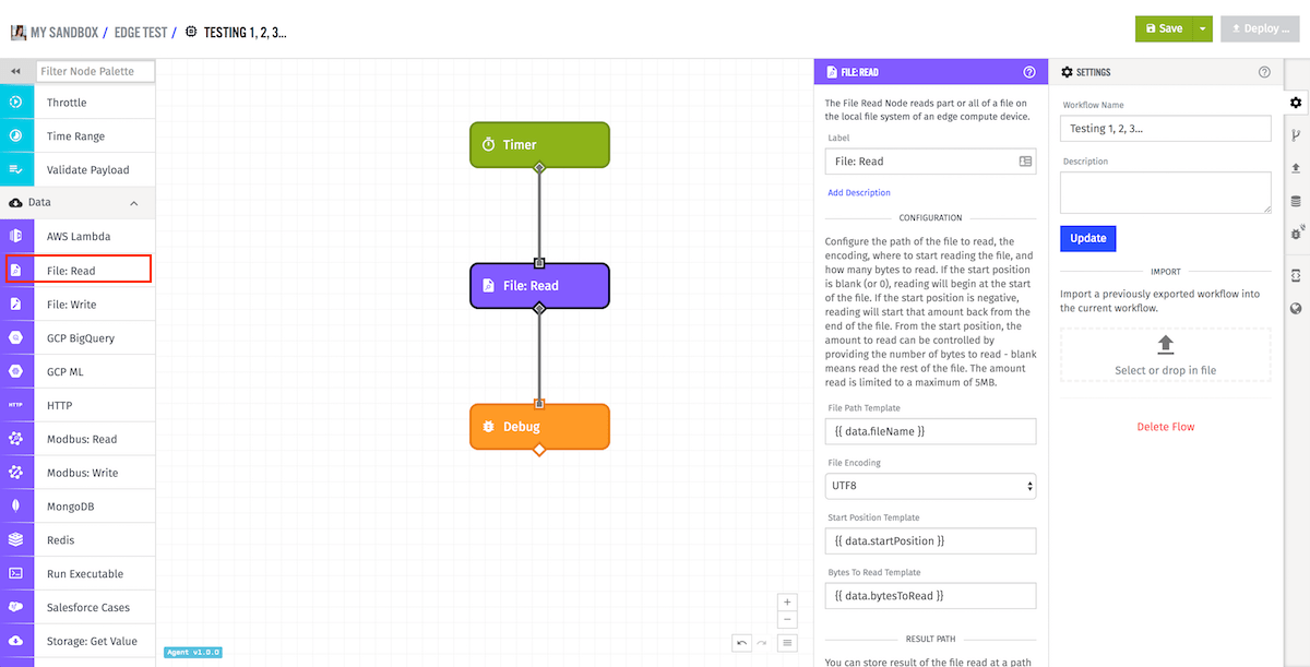

File: Read Node
The File: Read Node allows you to read a file from disk in the device's Gateway Edge Agent. This node is only available in edge workflows.
File Read Node
There are five configuration settings for this node:

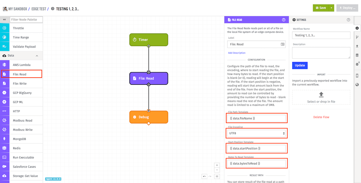

  • File Path Template: (Required) A string template for the location of the file to read within the container. This must resolve to a path that the agent's Docker container has permission to read; in most cases this requires mounting a volume into the container.
  • File Encoding: The file encoding (defaults to UTF-8).
  • Start Position Template: A string template or integer for the byte at which to start reading. Not setting a value defaults to the start of the file. Passing a negative integer will start reading that many bytes from the end of the file.
  • Bytes To Read Template: A string template or integer for the number of bytes to read. Not setting a value reads until the end of the file.
  • Result Path: (Required) A payload path for where to store the result of the operation.
Attempting to read 5MB or more in a single operation will halt the workflow with a validation error.
