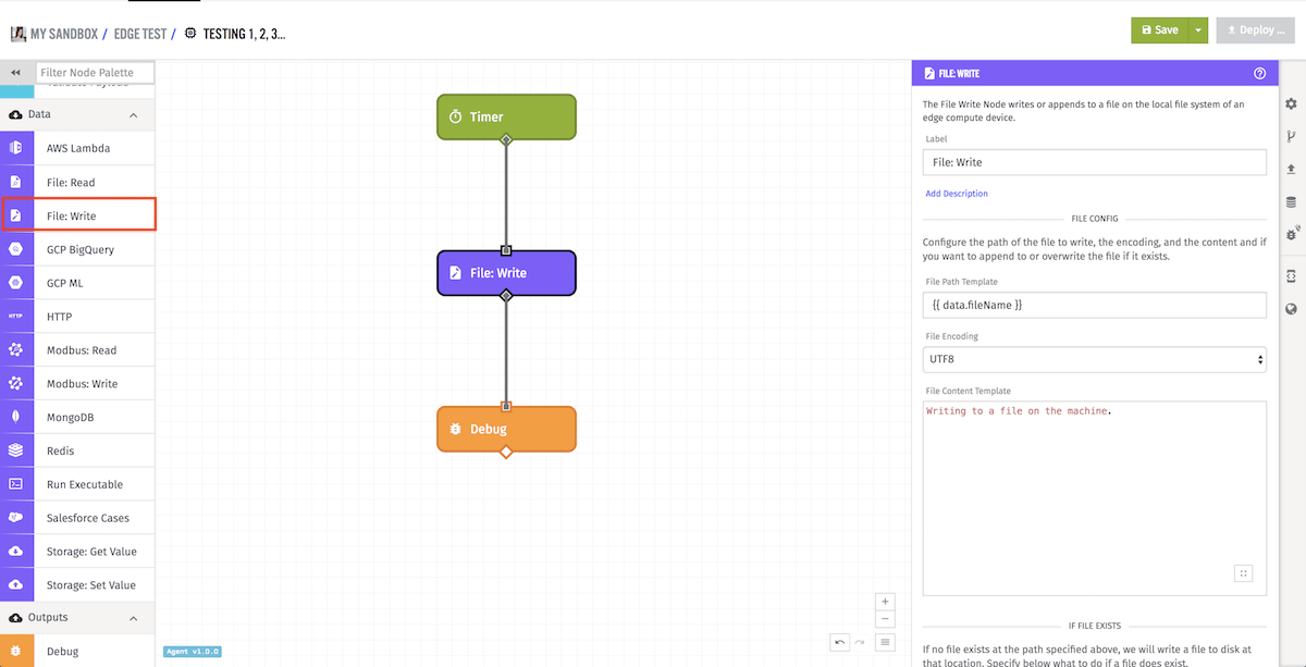

File: Write Node
The File: Write Node allows you to write to a file on your Edge Compute device. This node is only available in edge workflows.
File Write Node

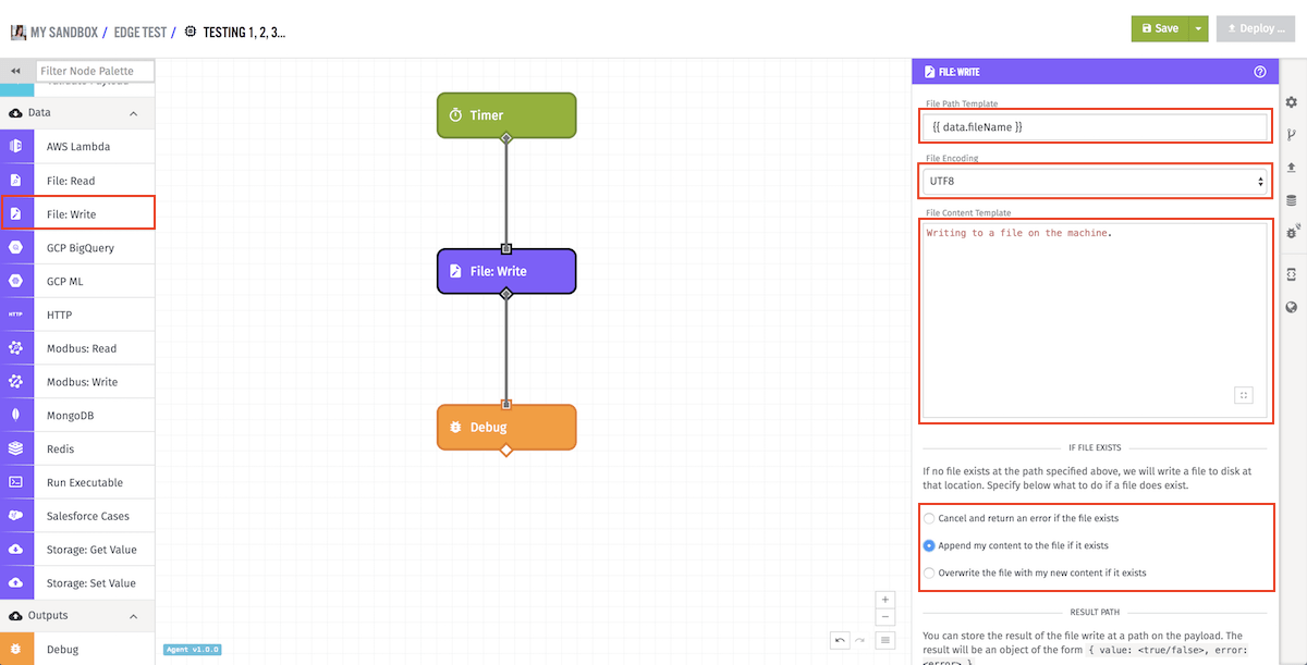

There are a number of configuration options for this node:
  • File Path Template: (Required) A string template for the disk location of where to write the file. Note: This must resolve to a path that the agent's Docker container has permission to write to; in most cases this requires mounting a volume into the container.
  • File Encoding: The content encoding (defaults to UTF-8).
  • File Content Template: (Required) A string template for the content to write to the file.
  • Result Path: A payload path for where to store the result of the operation, if desired.
File Write Node Configuration
If a file does not already exist at the file path defined in your configuration, the node will write a new file to disk at that path.
There are three options for what to do if a file does exist at the specified file path:
  1. Cancel and return an error if the file exists: This will only write to a file that is nonexistent to avoid overwriting the wrong file.
  2. Append my content to the file if it exists: This will cause the content to be appended at the end of the file, so all the content currently in the file will stay, the node will simply add to the content.
  3. Overwrite the file with my new content if it exists: (Default) This allows you to completely replace the file with the content from the node.
