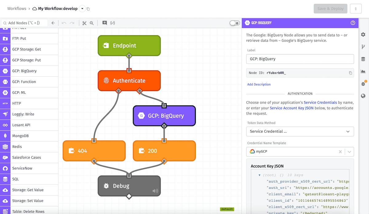

Configuration for the node is broken up into four sections.
Authentication
First, we must enter our Google credentials.
- Token Data Method: A Google service account key is required for the workflow to authenticate with Google BigQuery. This may be supplied as either a Service Credential (Application and Experience workflows only), a JSON template, or a payload path.
The next configuration field will depend on the Token Data Method selected.
If you selected
Service Credentialas your Token Data Method, Credential Name Template can either be a string template that references your Service Credential name or you can select a Service Credential you have created for your application. -
If you selected
Direct input (JSON Template)as your Token Data Method, Account Key (JSON Template) can either be a JSON template that references your Google service account key or you may enter it directly. -
If you selected
Direct input (Payload Path)as your Token Data Method, Account Key Payload Path is a payload path that references your Google service account key.
The third configuration field appears for all Token Data Methods.
- Project ID Template: Can either be a string template that references your project ID, or it can be left blank to use the default project ID associated with your credential. Note: For Edge Workflows, this field is only available in GEA version 1.42.0 or higher.

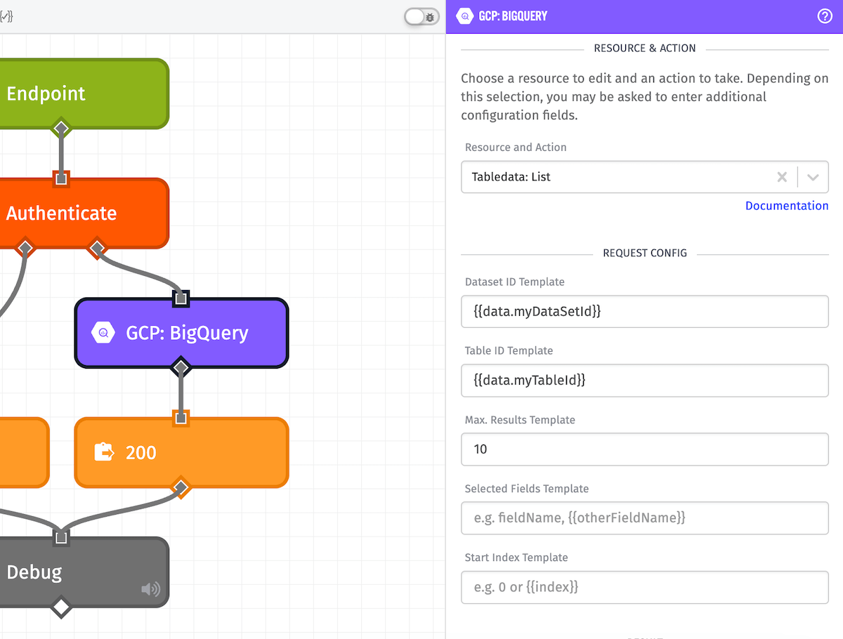

Resource & Action
Choose a resource to edit and an action to take. Currently the node supports the following resources and actions:
Request Config
The available options here will change depending on the selected resource and action. For example, if the selected action creates or updates a resource then a request body is required that contains the new or updated resource. Some actions require a dataset ID, some require both a dataset ID and a table ID, and some require neither. There are also some options that are only relevant to a specific resource and action, such as the "include hidden datasets" option when "Datasets: List" is selected.
In the example above, the selected resource and action value is "Tabledata: List" and the relevant configuration is being shown.
Result
Specify a payload path at which to place the result of the operation. If the request succeeds but no result is returned by BigQuery (for example, when deleting a resource) the result will be { success: true }.
