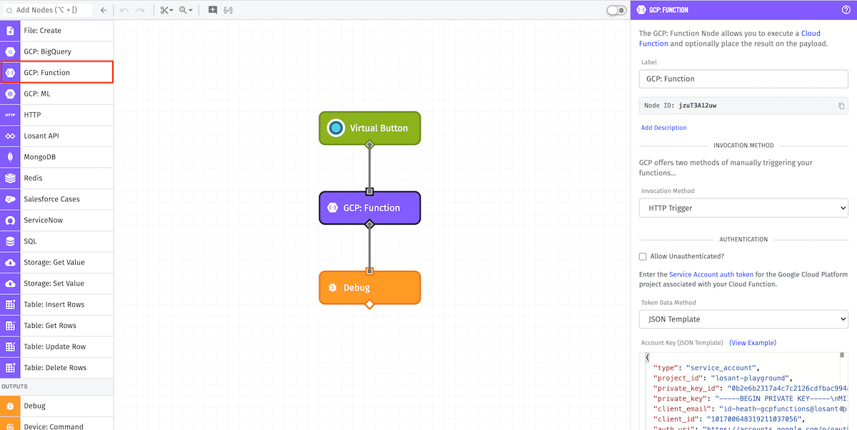

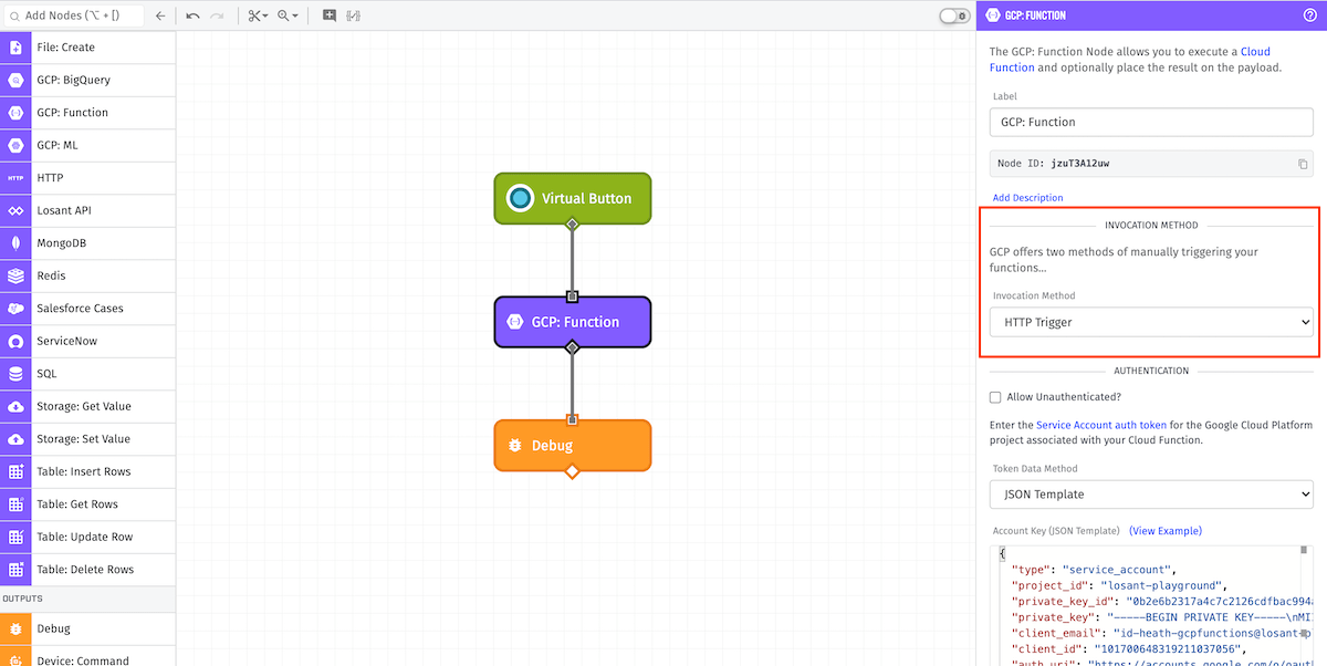

Invocation Method​
GCP: Function Invocation Method
Note: For Edge Workflows, this section is only available in GEA version 1.22.0 or higher.
Google Cloud Functions may be triggered in one of two ways...
HTTP Trigger:​
HTTP triggered functions allow un-throttled and optionally authenticated calls to their trigger URL.
API Trigger:​
Directly calling Cloud Functions via the Google API requires authentication, but allows you to call event-triggered functions manually.

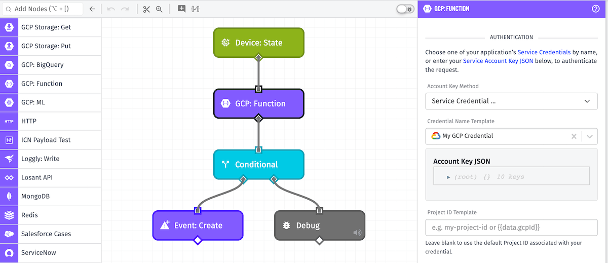

Authentication​
GCP: Function Node Host Config
First, a Service Account auth token is required for the workflow to authenticate with Google Cloud Functions. You may supply this token one of three ways:
  • Service Credential accepts an Application Credential for the token. It is important to note that this configuration option is not available in Edge Workflows.
  • JSON Template accepts a JSON template for the token.
  • Payload Path accepts a payload path for the token.
HTTP Triggered functions have the option of being triggered without authentication. If your function is configured to allow unauthenticated calls, then you may optionally provide a service account key.
Additional Authentication Configuration:​
  • Project ID Template: (Optional) Any project id or template entered into this field will override the project_id property defined in the configured authentication. Note: For Edge Workflows, this field is only available in GEA version 1.42.0 or higher.

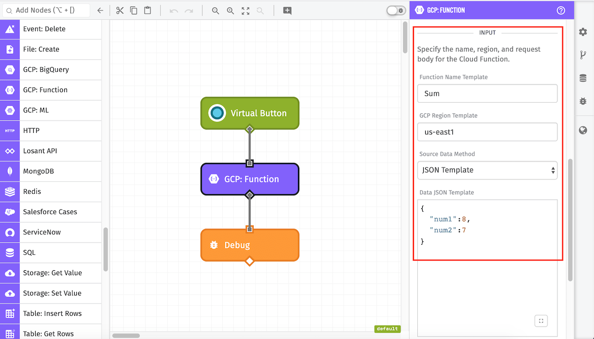

Input​
GCP: Function Node Config
Next, specify the Cloud Function to call, as well as any data to send. All applicable fields are templatable.
API Triggered Configuration:​
  • Function Name Template: (Required) The name of the Cloud Function to be called.
  • GCP Region Template: (Required) The location where the Cloud Function is hosted.
HTTP Triggered Configuration:​
  • Trigger URL Template: (Required) The URL to your Cloud Function, which is provided by GCP when your function is deployed.
  • Source Data Method: The data sent to the Cloud Function can be the entire payload, the value at a payload path, or a JSON template.
    • Workflow Payload: The entire current payload will be sent to the Cloud Function.
    • Payload Path: The value at the given payload path will be sent to the Cloud Function.
    • JSON Template: The value is expected to be a JSON template which will be the object sent to the Cloud Function.

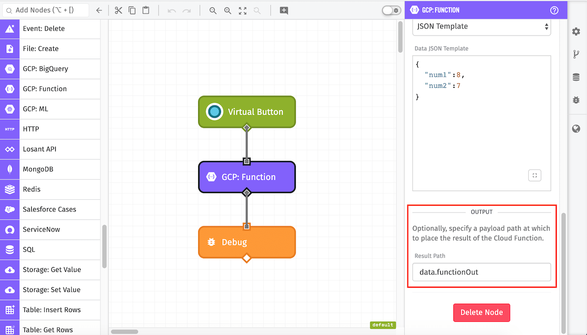

Result Path​
Finally, you may optionally store the result of the Cloud Function on the payload. More information about returning data from Google Cloud Functions can be found in their documentation.
GCP: Function Node Result
If the result path is configured, when a workflow executes a Cloud Function its result will be placed on the payload. For example:
Executing the following GCP Function...
exports.sum = (req, res) => {
const { num1, num2 } = req.body;
const sum = num1+num2
res.status(200).send(sum.toString());
results in the following payload:
"functionOut": {
"result": "15",
"executionId": "lhf3ghvp82u0"

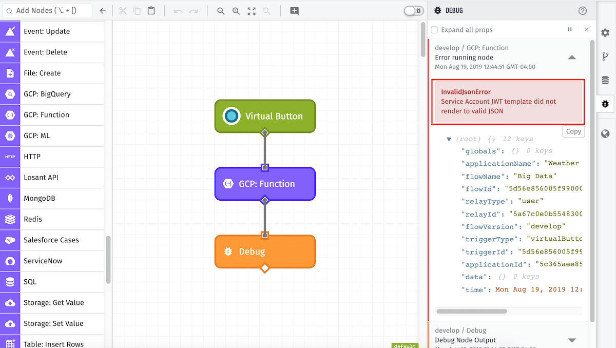

Errors resulting from the configuration of the GCP: Function Node itself will error the workflow like so:
GCP: Function Node Error
If an error is thrown from the Cloud Function, it will appear on the payload. Here's an example of a Cloud Function that tried to parse invalid JSON:
"functionOut": {
"error": "Error: function crashed. Details:\nUnexpected token o in JSON at position 1"
