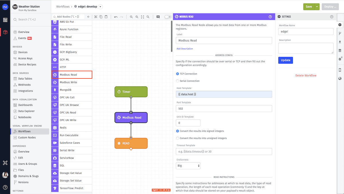

There are three main parts of the configuration for this node.
Modbus Read Node Configuration
Address Configuration​
Address Configuration includes the following fields:
  • Connection Method: This field can be TCP Connection, Serial Connection or ASCII Serial Connection. Depending on which type you select, different connection options will be available. For serial connections, here is more information on the difference between RTU and ASCII.
TCP Connection Configuration​
  • Host Template: (Required) A string template for the IP address at which the register(s) resides.
  • Port Template: (Required) A string template or integer for the Modbus port.
Modbus RTU or ASCII Serial Connection Configuration​
RTU Serial is only available on Gateway Edge Agent v1.10.0 and higher. ASCII Serial is only available on Gateway Edge Agent v1.46.0 and higher.
  • Path Template: (Required) A string template or path that resolves to the serial port at which values will be read.
  • Baud Rate Template: (Required) The baud rate, speed of communication over a data channel, which by default is 9600. This field can either be a integer or a template but it must resolve to a valid rate. For agent versions prior to 1.19.2 the following are the accepted baud rates: 110, 300, 600, 1200, 2400, 4800, 9600, 14400, 19200, 38400, 57600, 115200, 128000, 256000. As of agent version GEA v1.19.2 you may specify any positive integer for this field.
In GEA v1.10.0 the following options are defaulted:
  • Data Bits: 8
  • Stop Bits: 1
  • Parity: none.
However, in GEA v1.11.0 and higher, you may specify these options.
  • Parity Template: The Parity is a method used to detect errors, which by default is none. This field can either be a string or a template but it must resolve to one of the following valid options: none, even, mark, odd, space.
  • Data Bits Template: The Data Bits is the number of bits each character can be, which by default is 8. This field can either be a integer or a template but it must resolve to one of the following valid data bits: 5, 6, 7, 8.
  • Stop Bits Template: The Stop Bits is the bit sent at the end of every character to signify the end of a character, by default this is 1. This field can either be a integer or a template but it must resolve to a valid stop bit. The only valid stop bits are 1 and 2.
ASCII Serial Connection has one additional option.
  • Start of Frame Character Template: The ASCII character that is the starting bit of the frame. This field defaults to :.
Common Configuration​
  • Unit ID Template: (Required) A string template or integer for the Unit ID at the specified host and port. Defaults to 1.
  • Convert to signed or unsigned integers: Select Convert the results into signed integers (default) or Convert the results into unsigned integers.
  • Timeout Template (in milliseconds): A string template or integer for the number of milliseconds to wait before a timeout will occur while waiting for read results. Defaults to 30000 milliseconds.
  • Endianness Template: The endianness, or sequential order of bytes. Defaults to big.

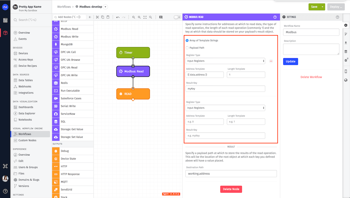

Modbus Read Node Instructions
Read Instructions​
Read Instructions can be specified in one of two ways. At least one is required, but both can't be specified at the same time.
Array of Template Strings​
For each Read Instruction, fill out the following input configuration fields, all of which can utilize templates. You must define at least one instruction:
  • Register Type: (Required) Select one of the following ...
    • Input Registers: Read Input Registers (FC=04)
    • Holding Registers: Read Holding Registers (FC=03)
    • Coils: Read Coil Status (FC=01)
    • Discrete Input: Read Input Status (FC=02)
    • Read Device Identification: Read Device Identification (FC=43/14). This function is only available in GEA v1.16.0 and higher.
  • Result Key: (Required) The key at which to store the result of this read operation. This key exists on the Result Path defined below. This can resolve to any string except "errors," since that key is reserved for any errors that occur during reads. The value at this key is read as an signed integer.
The following inputs are required only for Read Device Identification:
  • Device ID Code Template: (Required) A string template or integer for the identification of the access level for the object ID. This should resolve to an integer between 1 and 4.
  • Object ID Template: (Required) A string template or integer for the starting index of the device identification object. This should resolve to an integer between 0 and 255.
The following inputs are required for all the register types except Read Device Identification:
  • Address Template: (Required) A string template or integer for the address at which to read. This should resolve to an integer between 0 and 65535.
  • Length Template: The length for this read instruction. This field is optional; if set, it should resolve to an integer greater than 0. Otherwise, the length defaults to 1.
