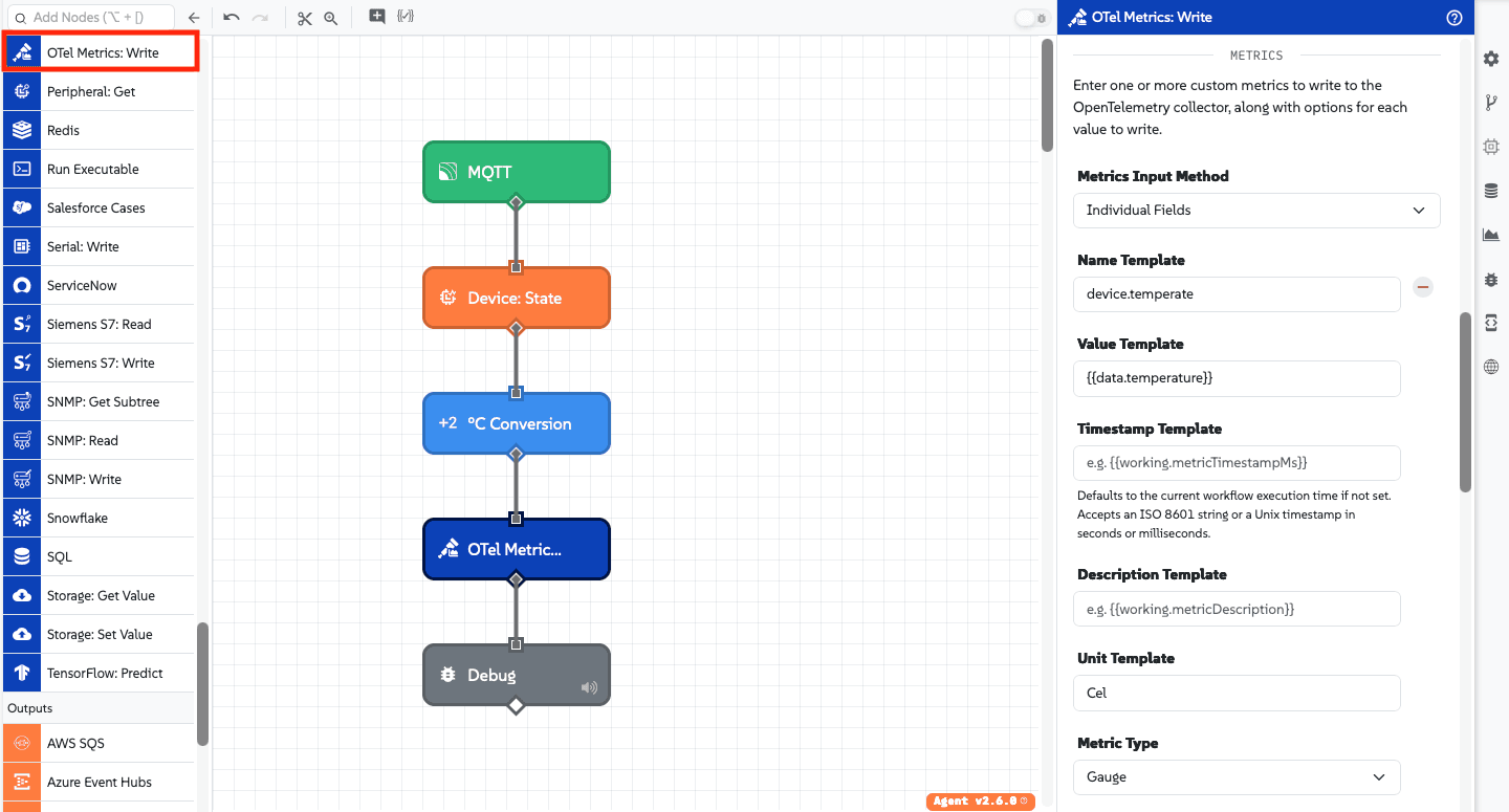

OTel Metrics: Write Node
The OTel Metrics: Write Node writes custom metric values to an OpenTelemetry (OTel) collector running on the same host machine as the Gateway Edge Agent (or accessible over HTTP/HTTPS). This node is only available in Edge Workflows.
Configuration for the OTel Metrics: Write Node is divided into four main sections: Connection, Resource Config, Metrics, and Result.

Metrics​
Define one or more custom metrics to write to the OpenTelemetry collector. First, choose a Metrics Input Method:
Individual Fields​
Define each metric individually. At least one metric is required:
  • Name Template: (Required) A string template resolving to the OTel metric name.
  • Value Template: (Required) A string template resolving to a numeric value for the metric.
  • Timestamp Template: (Optional) A Unix timestamp in milliseconds, Unix timestamp in seconds, or ISO 8601 date string. Defaults to the current workflow execution time if not set.
  • Description Template: (Optional) A string template describing the metric.
  • Unit Template: (Optional) A string template representing the UCUM unit of measurement (for example, Cel, %, or By). Defaults to 1 if omitted.
  • Metric Type: Select either Gauge (default) or Sum:
    • Gauge: Represents a measurement at a given point in time (for example, current temperature).
    • Sum: Represents the sum of values over time. Selecting Sum displays additional fields:
      • Start Timestamp Template: (Optional) An optional start time for the sum metric. Accepts an ISO 8601 string or a Unix timestamp in seconds or milliseconds. Omitted from the data point if left blank.
      • Aggregation Temporality: Choose between Cumulative (default, OTLP temporality 2) or Delta (OTLP temporality 1). Note that Prometheus-compatible collectors do not support delta aggregation temporality for sums and will reject requests containing them.
      • Monotonic: (Checkbox, checked by default) When checked, indicates the sum can only increase. Uncheck if the sum may decrease.
  • Metric Attributes Method: Define attributes specific to this metric:
    • Individual Fields: (Default) Define key-value rows using string templates. Values render typed per OTLP attribute rules.
    • JSON Template: A JSON template resolving to a flat JSON object of attribute keys and values:
      "sensor.id": "{{working.sensorId}}",
      "location": "facility-a"
    • Payload Path: A payload path pointing to a flat object of attribute key-value pairs on the payload.
