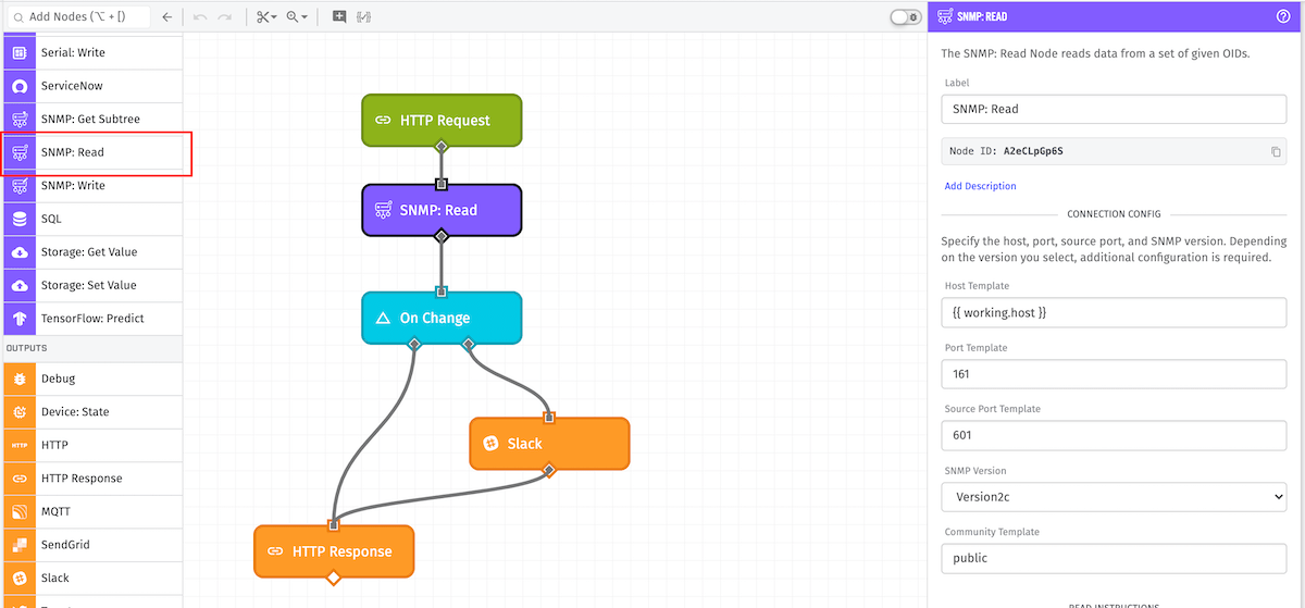

SNMP: Read Node
The SNMP: Read Node allows you to read values from multiple OIDs on your SNMP device. This node is available in edge workflows.
SNMP: Read Node Configuration
There are three categories to the configuration for the SNMP: Read Node: the connection, the read instructions, and the result.

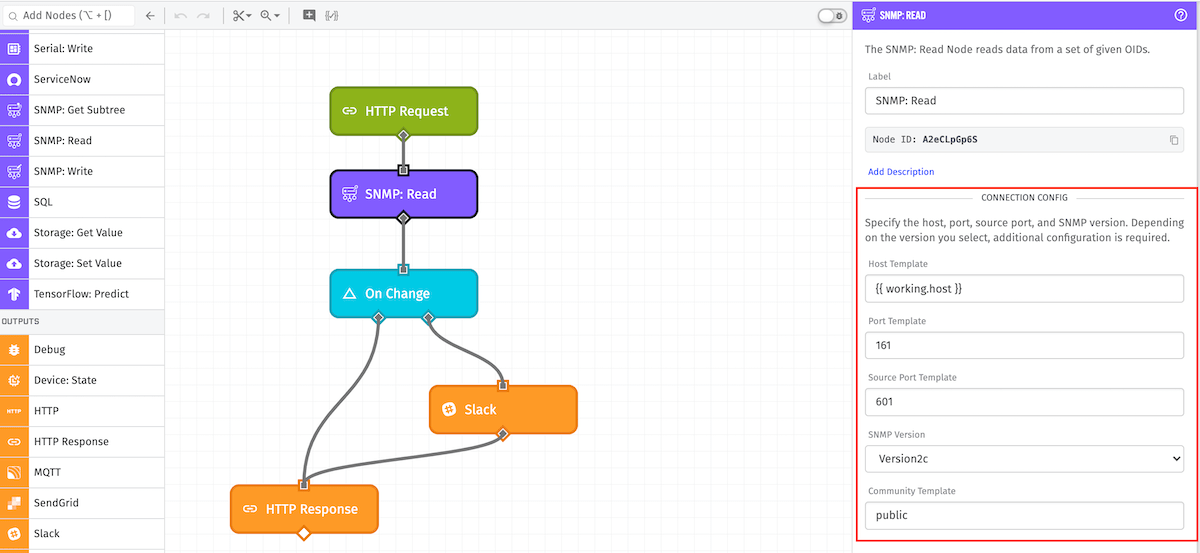

Connection Configuration​
SNMP: Read Node Connection Configuration
First, configure the information to establish a connection to the device.
  • Host Template: (Required) A string template for the destination address. This can be either an IPv4 or IPv6 address, or a hostname that resolves to an address.
  • Port Template: (Optional) A string template or integer for the UDP port at the target address. Default is port 161.
  • Source Port Template: (Optional) A string template or integer for the UDP port from which the message should be sent on the edge device. If not provided, a random port is selected at runtime.
  • SNMP Version: (Required) The version of SNMP with which to establish a connection. Options are Version1, Version2c, or Version3. Defaults to Version2c.
Depending on the version selected, additional input is required.
Version1 and Version2c Configuration​
  • Community Template: (Required) A string template for the community credential delivered with the request. Defaults to public.

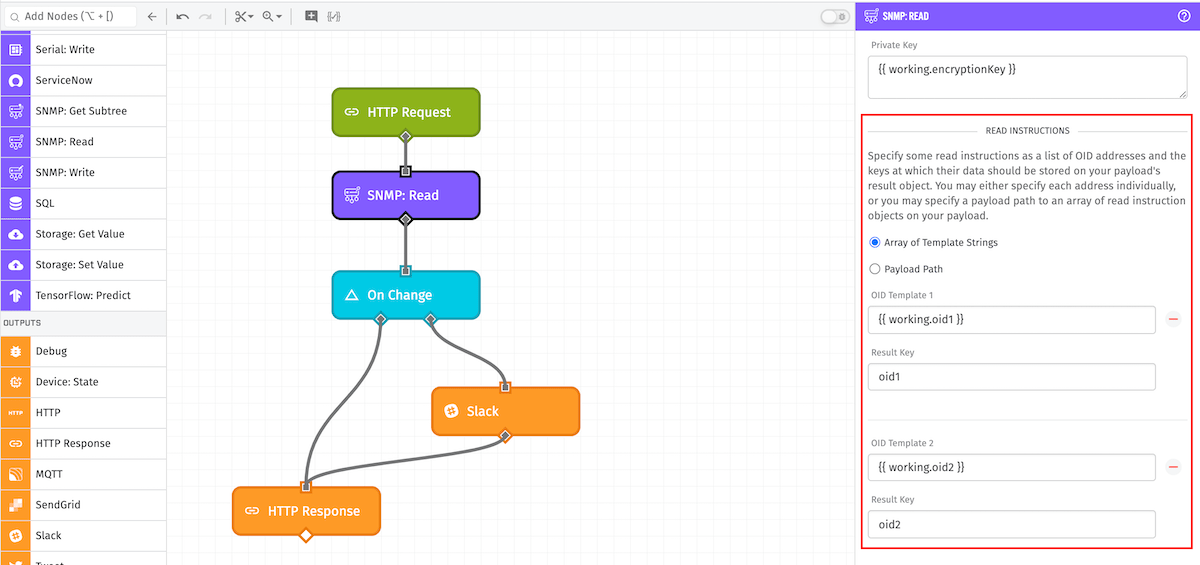

Read Instructions​
SNMP: Read Node Instructions
Next, indicate the instructions to read values. Read Instructions can either be specified with an array of template strings or by pointing to a payload path with the required instructions. At least one instruction is required.
  • Array of Template Strings: For each instruction, the following configuration fields are required:
    • OID Template: (Required) Template for the OID from which to read.
    • Result Key: (Required) The key at which to store the result of the read operation. This key and its corresponding value will be placed on the Result Path.
  • Payload Path: Enter a payload path that resolves to an array of Read Instructions to be run on this node. The following are the object properties that each object in the array should contain for successful reads:
    • oid: (Required) Template for the OID from which to read.
    • resultKey: (Required) The key at which to store the result of the read operation. This key and its corresponding value will be placed on the Result Path.

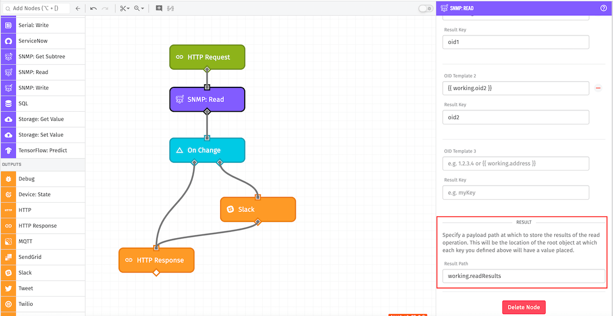

Result​
SNMP: Read Node Results Configuration
Finally, indicate the payload path at which the result should be placed. The result path defines where on the payload to store the result of the read(s). If values are successfully read, this represents an object with values at the given keys for each read. If there are any errors, the result includes an errors array with details about each error.
The following is an example of data from a successful read:
"result": {
"first": "Value Name",
"second": 76
The following is an example of a failed read due to timeout:
"result": {
"errors": [
"type": "SNMP_READ_ERROR",
"message": "Request timed out"
