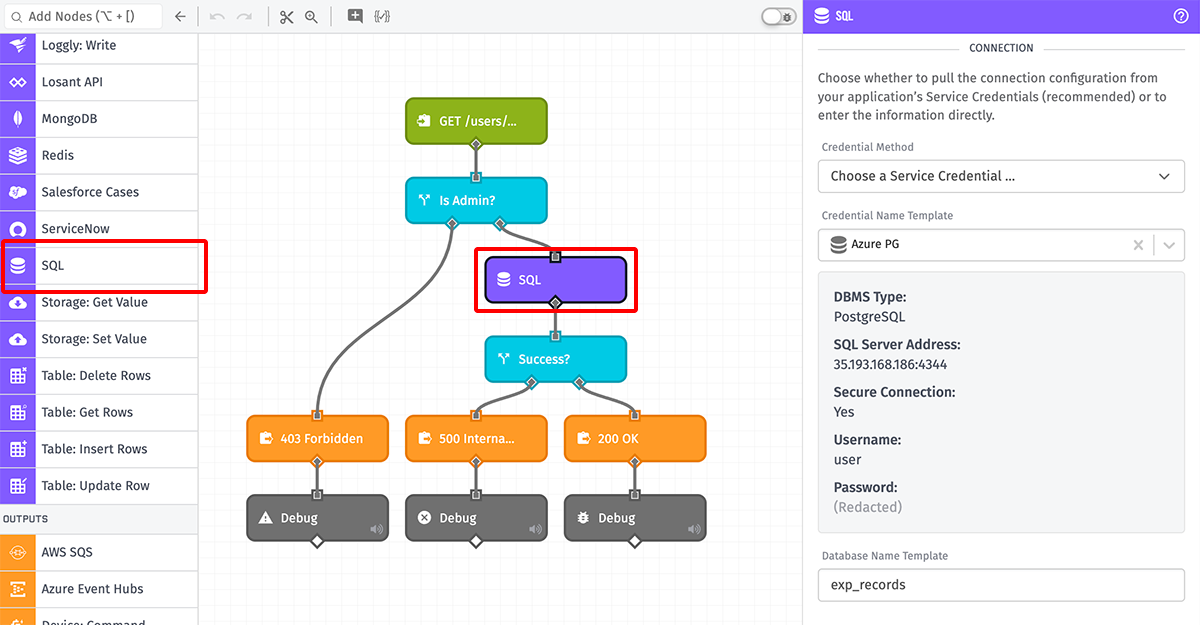

SQL Node
The SQL Node allows a workflow to query or update values in a SQL database and optionally store the result on the workflow payload.

SQL Connection
Connection configuration can be provided one of two ways ...
Choose a Service Credential
This is the recommended method for providing SQL connection information for both security and usability purposes. When selected, you must provide the following ...
