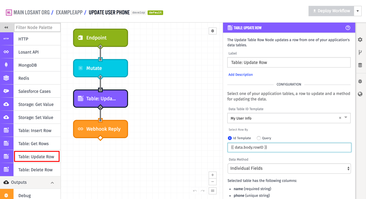

Table Update Row Node

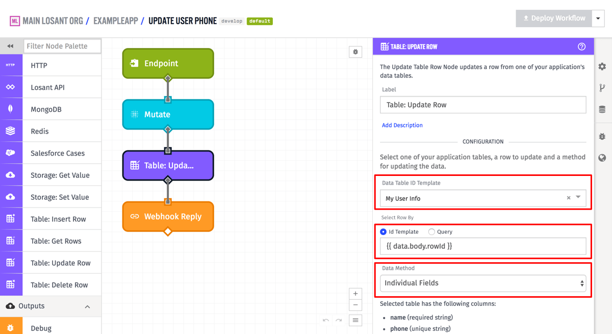

To find the row to update, the node requires both a data table to be selected, and by default the ID of the row to update. Both fields are templatable, and so supports finding a row based on the current workflow payload. The example below is doing exactly that, and is referencing the field data.body.rowId on the workflow payload.
Table Update Row Node Configuration

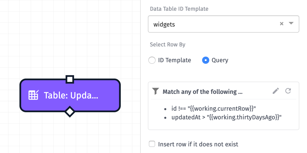

As well as looking up the row to be updated by the ID template there is also the option, "Select Row By... Query", to search for the row. Building your query within the node is nearly identical to building a query within the table browsing interface. The only difference is, when building a query within the node, you may use string templates for each property and value – or, if building in Advanced Mode, you may use a JSON template.
Note: Only the first row returned by the query will be updated.
Table Update Row Node Query

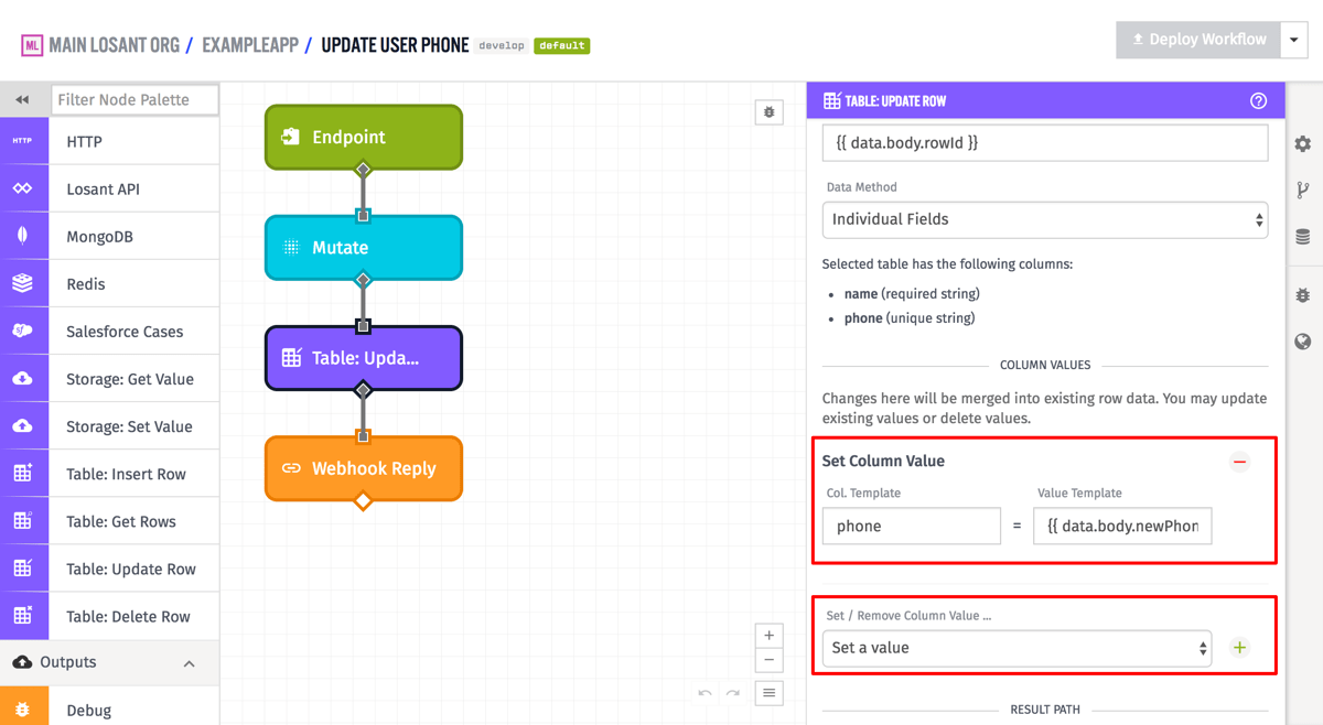

Table Update Row Node Individual Fields
For "Individual Fields", the most common method to use and the one shown in the example above, the row is broken into multiple fields that can be filled in using individual string templates. In this case, no columns are required - not doing anything with a column will just not update that column on the row. You can choose to set a value for a column, or to clear the value for a column. In the example above, the node is just setting a new value for the phone number column on the row and leaving the other columns alone.

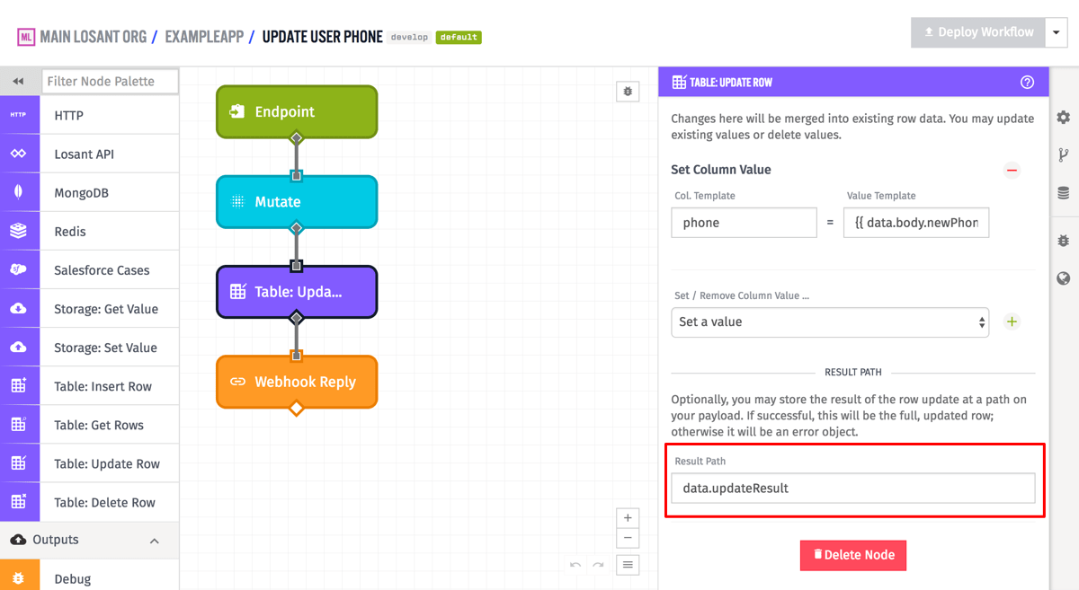

Table Update Row Node Result
Optionally you can provide a payload path in the "Result Path" field so that the updated row can be placed at that path on the current workflow payload. In the case of a successful row update operation, this will be the updated row object. In the case of a failed row update, this will be an object of the errors that occurred trying to update the row. Note: Errors detected during row update (such as missing required columns or row not found) are placed in the Result Path. However, if the data table being updated is the same table that triggered the current workflow (reentrant loop), the workflow will halt and error at this node instead of placing an error in the Result Path.
For instance, given the example node configuration in the screenshots above, this is a possible result for a successful row update:
