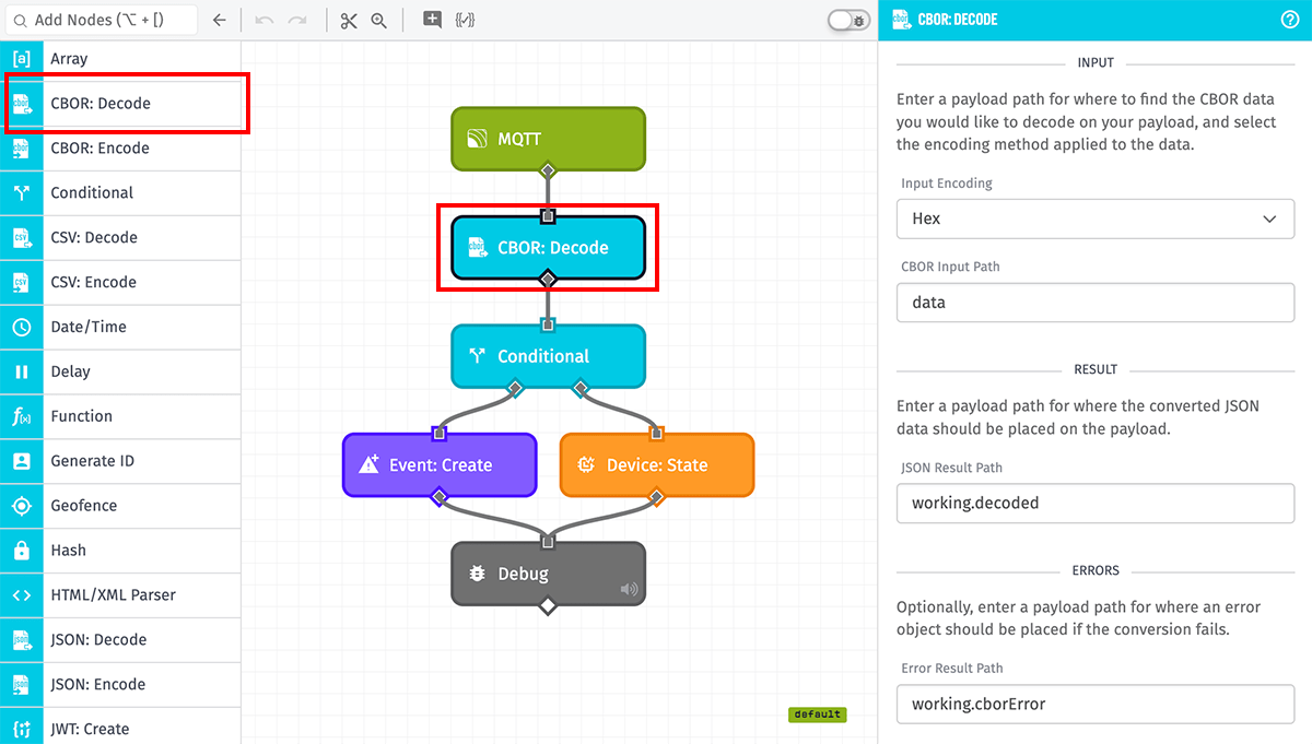

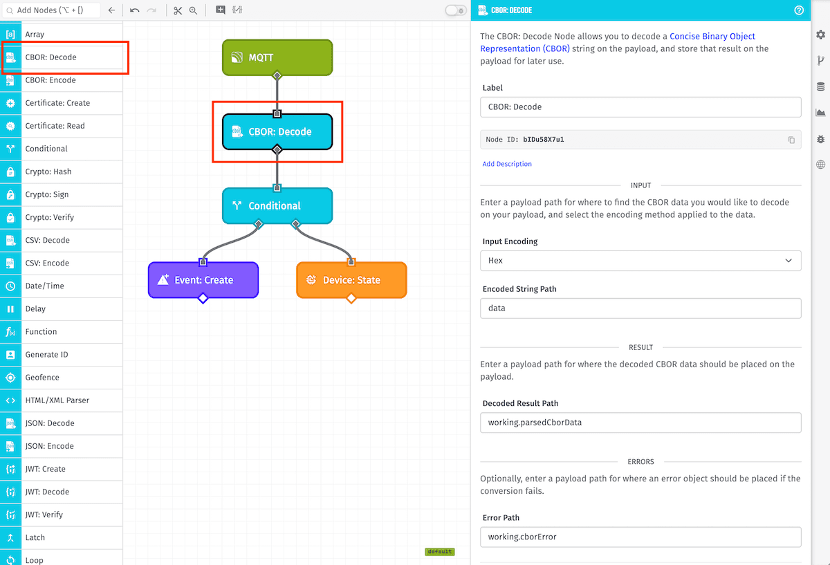

The CBOR: Decode Node's configuration is broken up into the following sections:
Input​
  • Input Encoding: The encoding method applied to the data you wish to decode. Options are:
    • Base64
    • Binary
    • Hex (default)
  • Encoded String Path: The payload path to the string to decode.
Result​
  • Decoded Result Path: The payload path at which to store the result.
Errors​
Read more about handling errors from this node below.
Given the following payload ...
"data": "a26568656c6c6f65776f726c6466706c65617365a366656e636f6465626d656261738461436142614f61526574696d657301"
... and a CBOR: Decode Node with the following configuration ...
  • Input Encoding: Hex
  • Encoded String Path: data
  • Decoded Result Path: working.parsedCborData
The payload after execution of the CBOR: Decode Node would look like:
"data": "a26568656c6c6f65776f726c6466706c65617365a366656e636f6465626d656261738461436142614f61526574696d657301",
"parsedCborData": {
"hello": "world",
"please": {
"encode": "me",
"as": ["C","B","O","R"],
"times": 1
