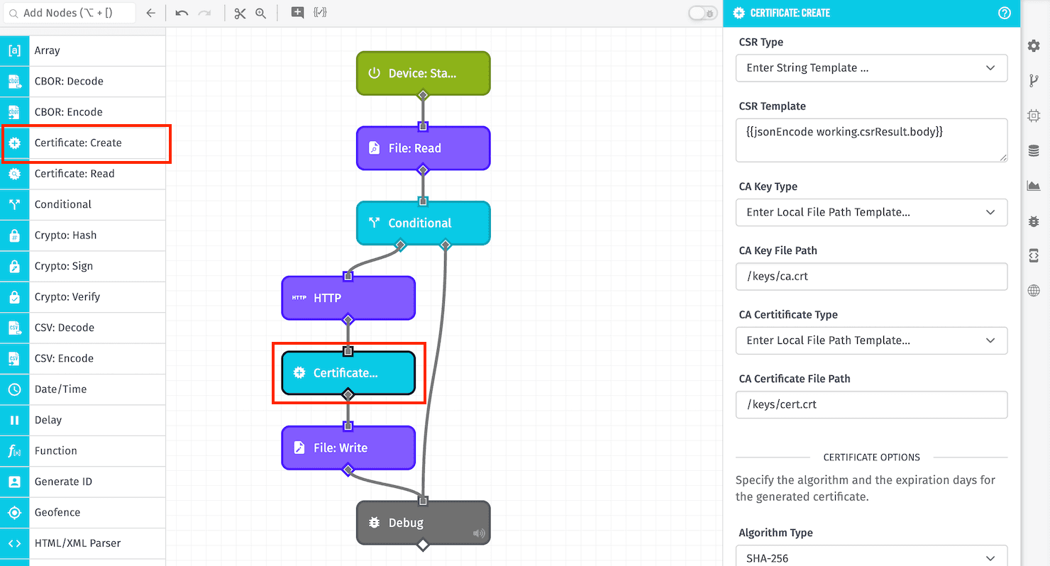

First, choose how to provide the Certificate Signing Request (CSR) for the new certificate. Options are:
  • Enter Local File Path Template: In Edge Workflows only, you may provide a file path to where the CSR is stored in a volume mounted within the agent's container.
  • Enter String Template: If selected, provide a string template resolving to the PEM encoded CSR on the payload.
  • Enter Payload Path: If selected, provide a payload path pointing to the PEM encoded CSR on the workflow payload.

In Edge Workflows, the CA Key and CA Certificate are each provided by first choosing an input type:
  • Enter Local File Path Template: If selected, provide a file path to where the CA Key or CA Certificate is stored in a volume mounted within the agent's container.
  • Enter String Template: If selected, provide a string template resolving to the value.
  • Enter Payload Path: If selected, provide a payload path pointing to the value on the workflow payload.
