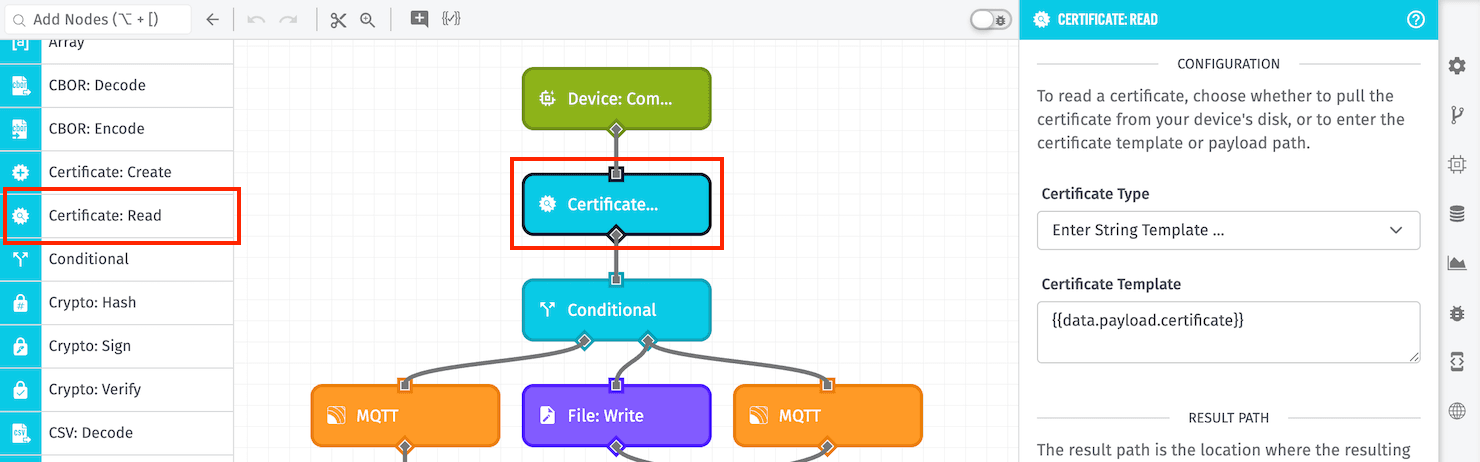

The Certificate: Read Node returns a given certificate's public key and metadata information.
The Certificate: Read Node's configuration is split into two sections ...
First, choose a Certificate Type, which determines from where to read the certificate. Options are:
  • Enter Local File Path Template: In Edge Workflows only, you may provide a file path to where the certificate is stored in a volume mounted within the agent's container.
  • Enter String Template: If selected, provide a string template resolving to a certificate.
  • Enter Payload Path: If selected, provide a payload path pointing to the certificate on the workflow payload.
In all cases, the input must be one or more PEM-encoded X.509 certificates (-----BEGIN CERTIFICATE----- blocks). A single block is treated as a single certificate; multiple blocks are treated as a bundle.
Next, define a Result Path, which is a payload path defining where to place the certificate's public key and metadata on the payload. This field is required.
If the node is successful and is reading a single certificate, the result will be an object with a publicKey property and an info property with details about the certificate. If the certificate is invalid, an error object will be put on the payload with a message property giving a reason for the failure.
When reading a certificate bundle, the result will be an array of objects, with one entry for each certificate in the bundle following the format described above. For example, if there are three certificates in the provided bundle and the second certificate is invalid, items 0 and 2 will be objects of the form { info, publicKey } and item 1 will be an object of the form { error: { message } }.
