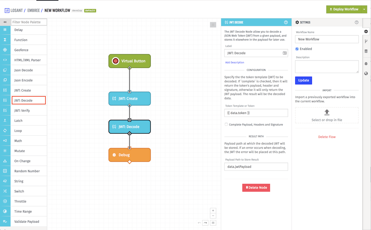

The JWT: Decode Node allows a workflow to decode a JSON Web Token on the payload.
JWT Decode Node
Configuration for the JWT: Decode Node is split into the following sections.

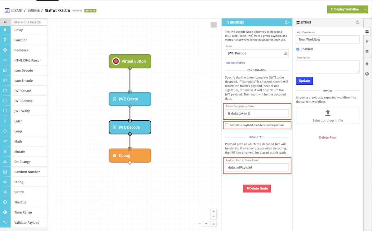

The node requires a Token Template (a string template resolving to the JWT to decode) and a Decoded Result Path for where to place the decoded result. An optional Complete Payload, Headers and Signature checkbox allows you to include the token's header and signature in the result; when unchecked, only the payload is returned.
JWT Decode Configuration

Decoded Result Path
Enter a Decoded Result Path, which is a payload path where the decoded JWT will be stored. If the JWT decodes successfully, the result will contain the payload (and header/signature if Complete Payload, Headers and Signature is enabled). If decoding fails, the value null will be placed at this path.
