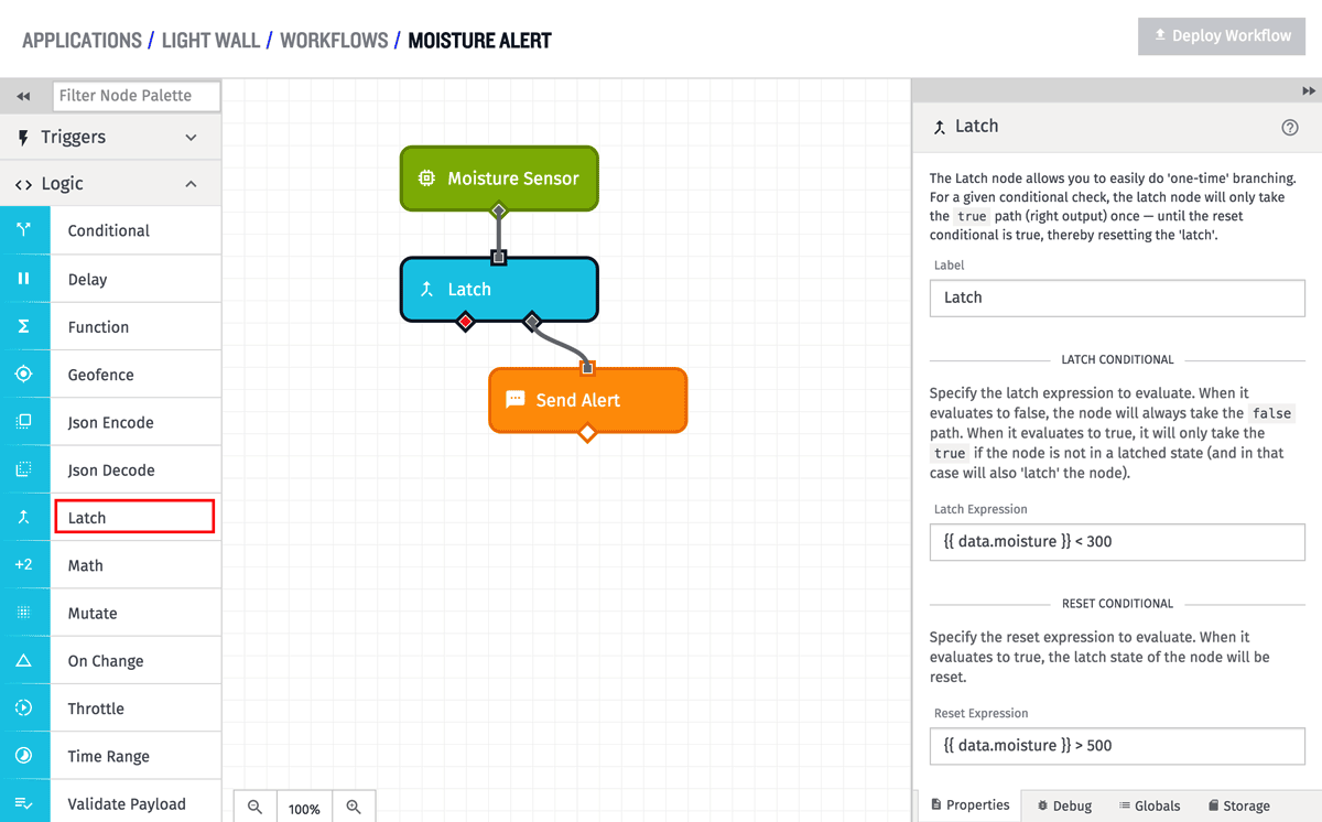

The Latch Node allows a workflow to easily do "one-time" branching, with a reset.
Latch Node

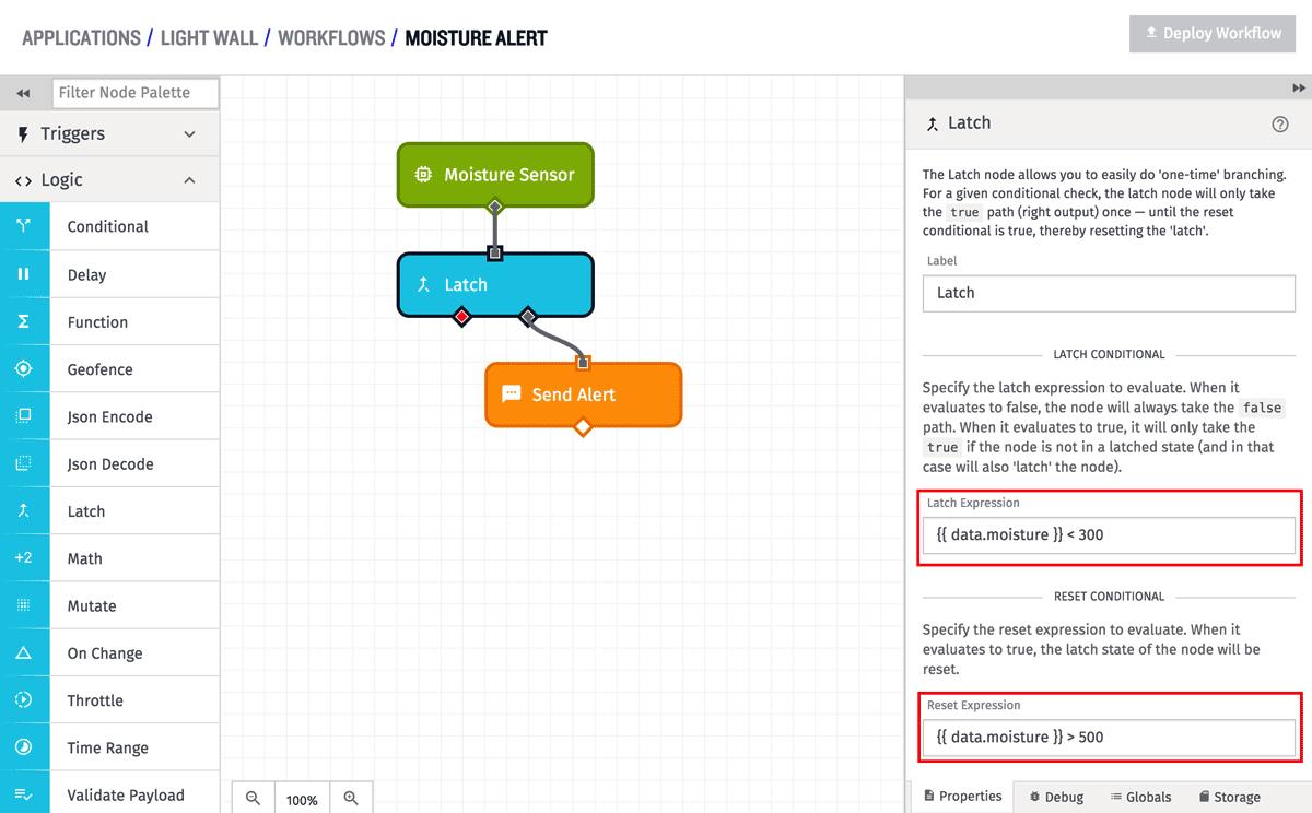

The Latch Node has two main configuration properties: the Latch Expression and the Reset Expression. These two expressions work in concert to give the behavior of a "latch". When the latch expression evaluates to true AND the node is not in the latched state, the true route on the right out of the node is taken, and the node is placed into the latched state. When the reset expression evaluates to true, if the node is in the latched state, the node is placed into the unlatched state.
Latch Node Config
In the above example, if moisture is reported as below 300 (the latch expression), the alert will be sent. Once the alert is sent once, however, no more alerts will be sent while moisture remains below 500 (the reset expression). Once moisture goes back up above 500, the Latch Node resets, and the next time moisture goes below 300, another alert will be sent.

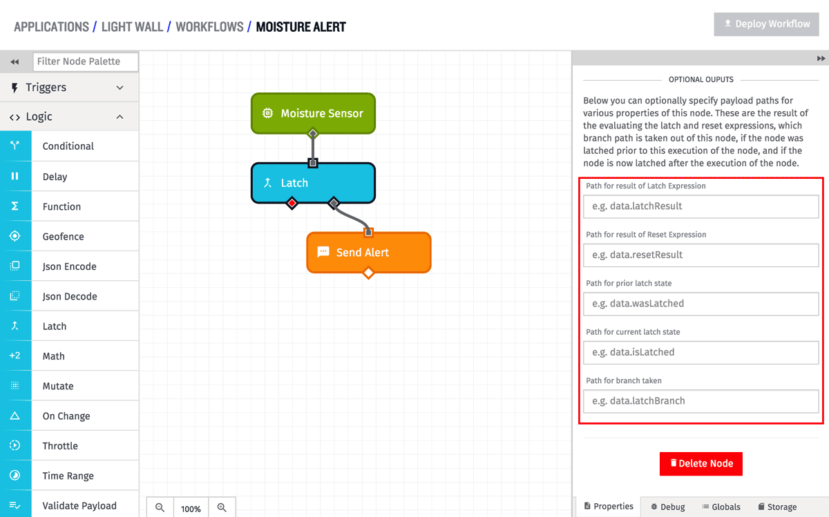

There are a number of outputs that can optionally be configured on the Latch Node, which add various information about the state of the Latch Node to the payload.
Latch Node Outputs
  • Path for result of Latch Expression takes a payload path and will place the result of evaluating the latch expression at that path on the payload.
  • Path for result of Reset Expression takes a payload path and will place the result of evaluating the reset expression at that path on the payload.
  • Path for prior latch state takes a payload path and will place true or false at that path on the payload depending on if the Latch Node was latched when entering the Latch Node.
  • Path for current latch state takes a payload path and will place true or false at that path on the payload depending on if the Latch Node is now latched upon exiting the node.
  • Path for branch taken takes a payload path and will place true or false at that path on the payload depending on which branch out of the Latch Node was taken.
