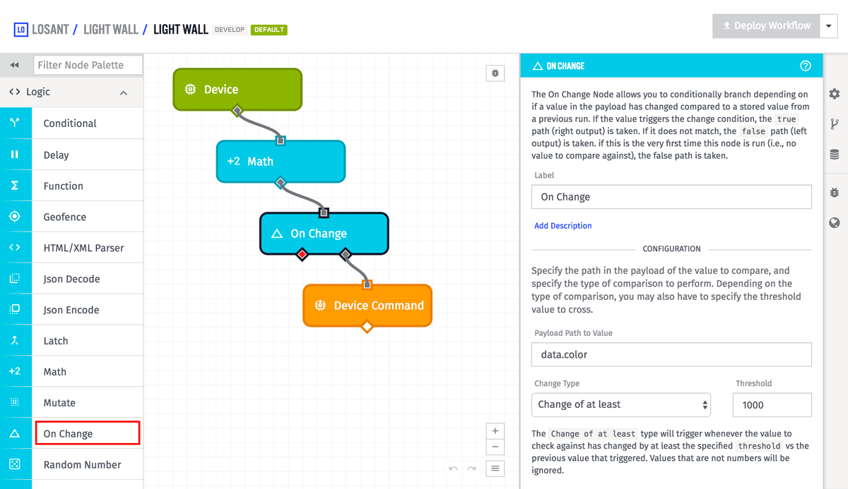

There are three configuration parts for the On Change Node - defining what payload field to monitor for changes, defining what constitutes a change, and optionally defining where to store the value compared against.

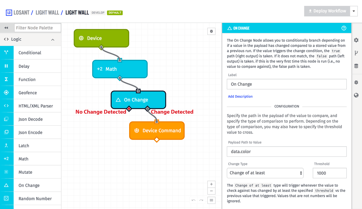

If the payload field being monitored for changes does in fact change between workflow runs, the route on the right out of the On Change Node is taken. If the payload field has not changed, the route on the left out of the On Change Node is taken. In addition, if this is first time that the field is being monitored (i.e., there is not a previous value to compare against), the route on the left out of the On Change Node is taken.

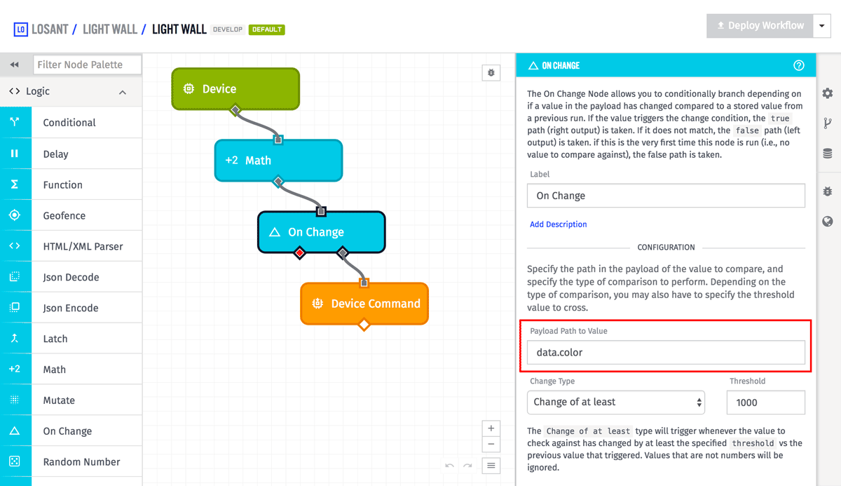

Field to monitor
On Change Node Field To Monitor
The field to monitor is a payload path to a value in the payload. In the above example, the value of the field data.color in the payload is what will be compared across workflow runs. If the field does not exist, the value that will be compared against will be undefined.

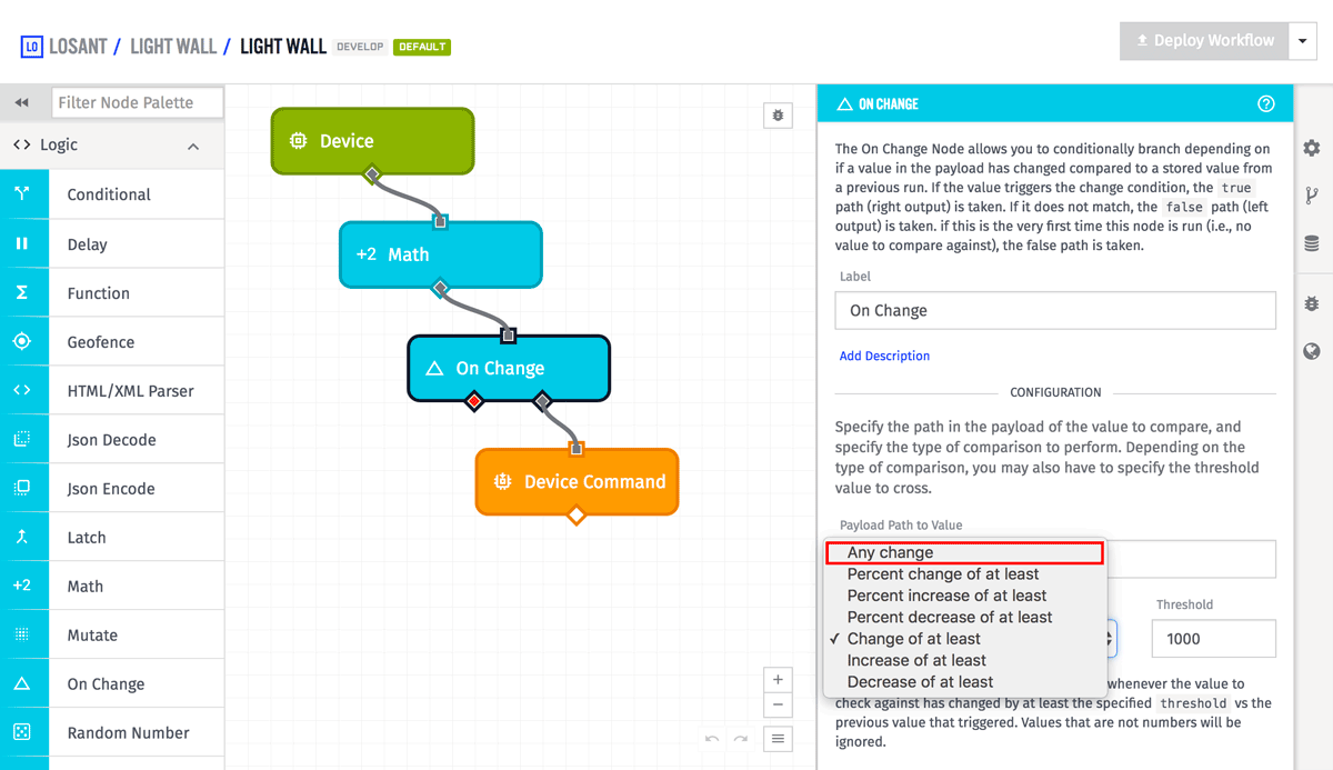

The Type of Change
There are seven different ways that a "change" can be defined, and those can be broken into the following 3 groups.
Equality Comparison
On Change Node Any Change
Any change
The Any Change type is the most commonly used. It can be used with any data type, or even across data types if the type of data in the field being monitored sometimes changes. If the value in the field is different in any way from the previous workflow run, it counts as a change.

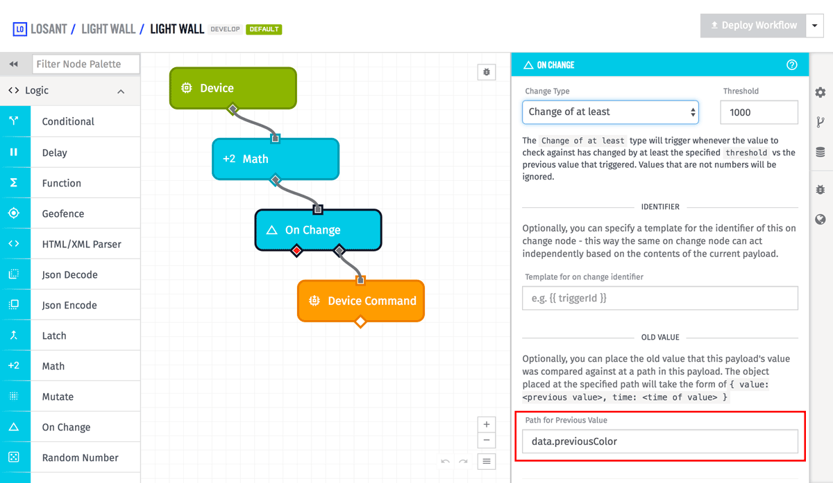

The On Change Node has the ability to optionally add information about the previous value being compared against to the payload at a defined payload path. If a path is defined, the previous value and time at which that value ran through the workflow will be placed at that path no matter which branch out of the On Change Node is taken. If there is no previous value that was compared against (i.e., this is the first time this field is being checked), then nothing will be added to the payload. In the above example, the previous value information will be placed at the data.previousColor path. So, for example, given the following payload:
"voltage": 1.7,
"color": 1393,
The payload after execution of the On Change Node might look like:
"voltage": 1.7,
"color": 1393,
"previousColor": {
"value": 1475,
"time": 1455838590449
Advanced Options
