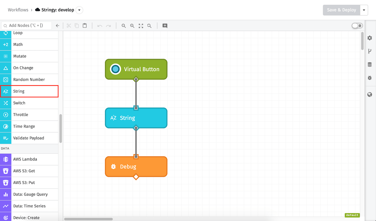

String Node
The String Node allows for manipulating string values on your workflow payloads.
String Node
The String Node takes three required values...

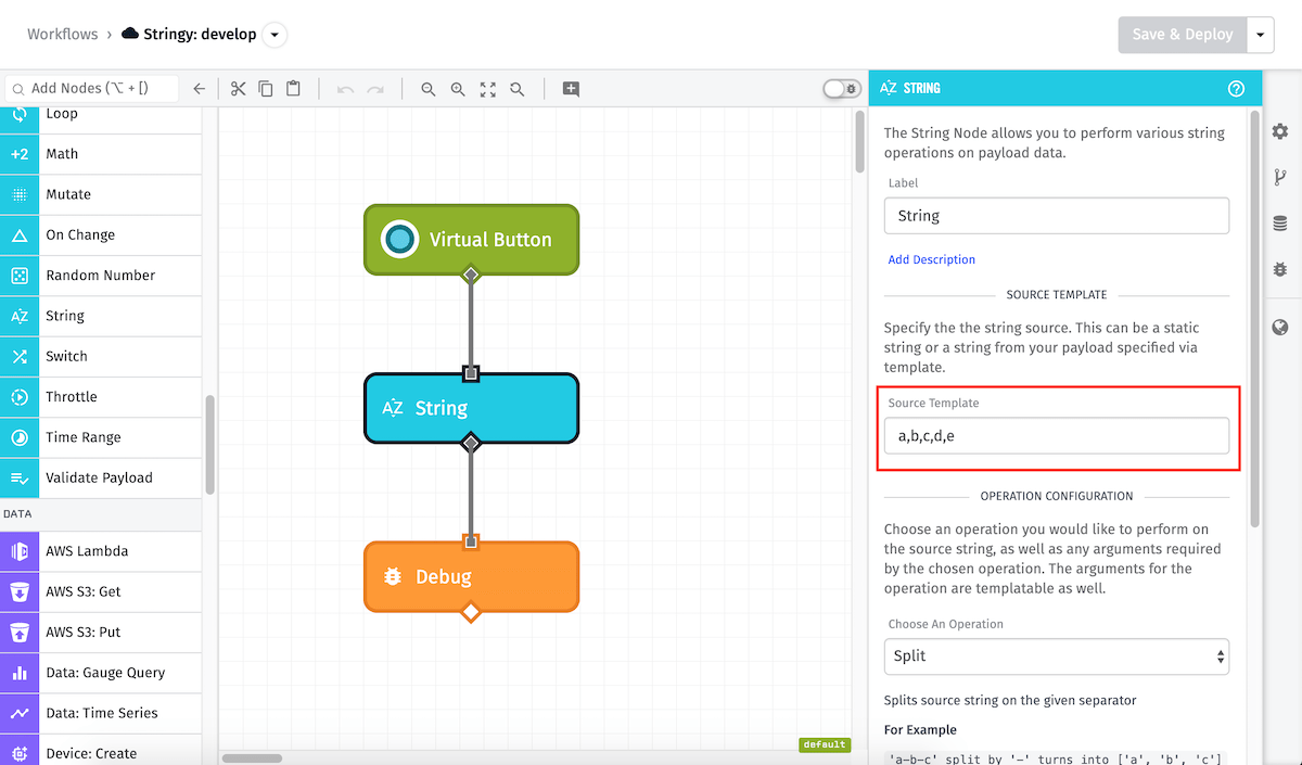

Source Template
String Node Source
A string template resolving to a string value on your payload.

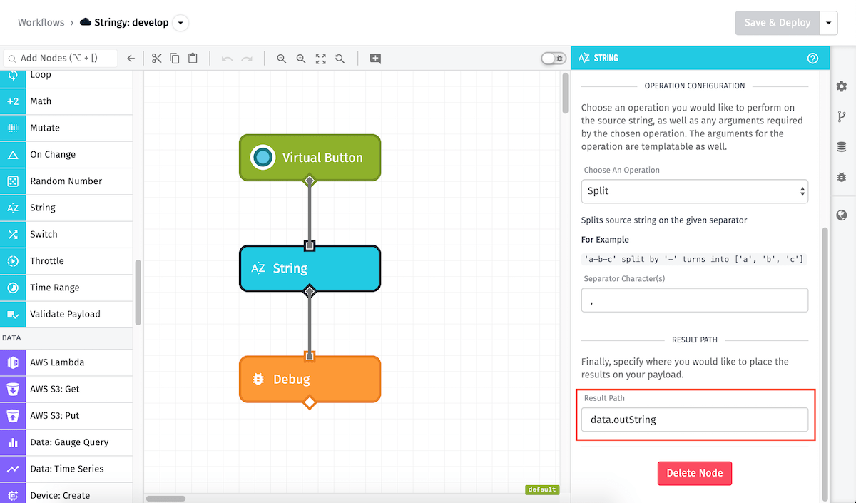

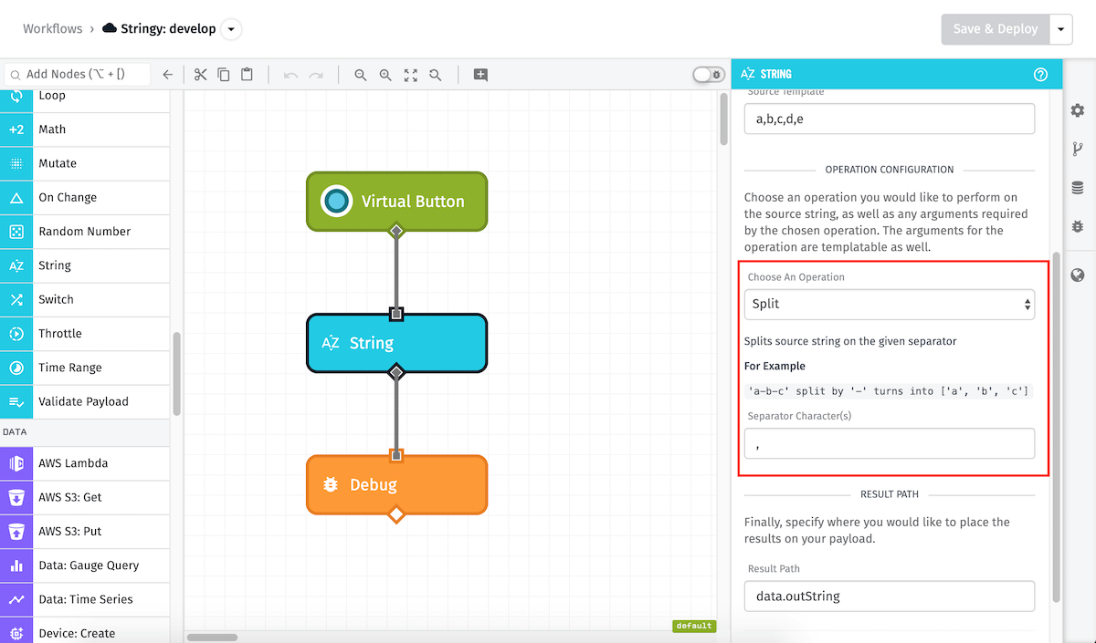

Operation Configuration
String Node Config
The operation to perform on the string. Depending on the value selected here, additional configuration may be required. (See below.)

Split
Split the source string into an array of strings, breaking on a character(s) of your choosing. The value placed at the Result Path will be an array when using this operation. Extra configuration:
  • Separator Character(s) - The delimiter on which the string should be split. This is commonly a pipe |, comma , or semicolon ; but it can be anything you choose.

String Node Result
A payload path for where the result of the string operation should be stored on your payload. This value will also be a string unless noted per operation.
Here's an example of the String Node's output using the above configuration:
"outString": ["a", "b", "c", "d", "e"]
