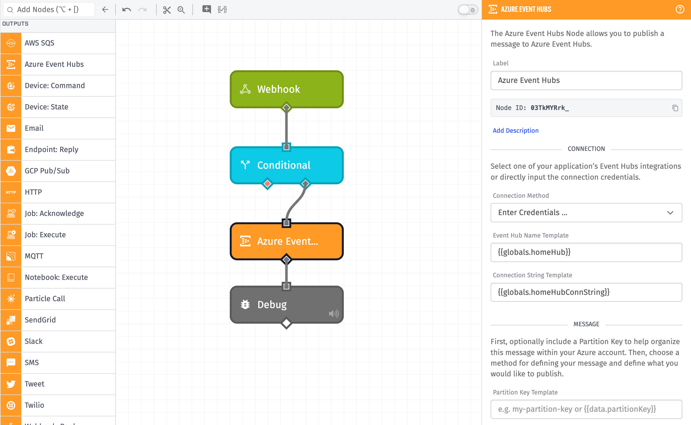

Azure Event Hubs Node
The Azure Event Hubs Node allows a workflow to publish a message to an Azure Event Hub.
Configuration for the node is broken up into four sections.
Connection
First, choose where to send your message.
Choose an Integration: Retrieves your Azure Event Hubs configuration from the selected Integration.
- Integration: Choose which of your application's Azure Event Hubs integrations you would like to publish the message on. The ID is templatable.
Choose a Service Credential: Configure the Azure Event Hubs connection with an Azure service credential previously saved in Losant.
- Credential Name Template: The name of the Azure service credential. This field is templatable.
- Host Name Template: The host name of the Azure Event Hub Namespace to which messages should be sent. This field is templatable.
- Event Hub Name Template: The name of the event hub to send messages to. This field is templatable.
Enter Connection String: Enter the credentials directly into the node fields. Both of these fields are templatable.
- Connection String Template: The connection string scoped to either an event hub namespace, or to a specific event hub. In order to properly connect with Losant, the access policy associated with the connection string must have
Sendpermission. - Event Hub Name Template: The name of the event hub to send messages to.
Note: Integrations and service credentials are not accessible from Edge Workflows, so only direct configuration is available to them.
