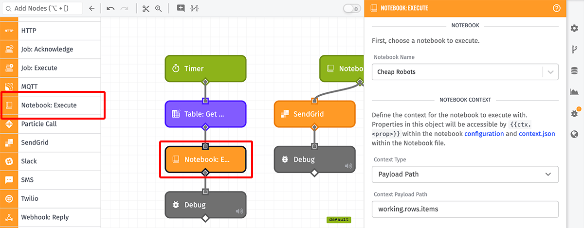

The Notebook: Execute Node allows a workflow to request an execution of one of your Losant Notebooks.
This node does not wait for a notebook execution to complete; it only requests the execution of a notebook. If you want to react to the completion of a notebook in a workflow, use the Notebook Trigger.
There are four main properties to set for this node ...
Notebook
First, choose which of your application's notebooks you would like to execute. You may also provide a string template that resolves to a notebook ID to dynamically choose which notebook to execute.
Notebook Context
Next, define the context to pass to the notebook execution. Context may be provided one of four ways ...
  • None: Provide no additional context to the execution.
  • JSON Template: Define the execution context inline as a JSON template.
  • Payload Path: Provide a payload path to an object that will serve as the execution context.
  • Full Payload: Provide the full workflow payload as context to the execution.
