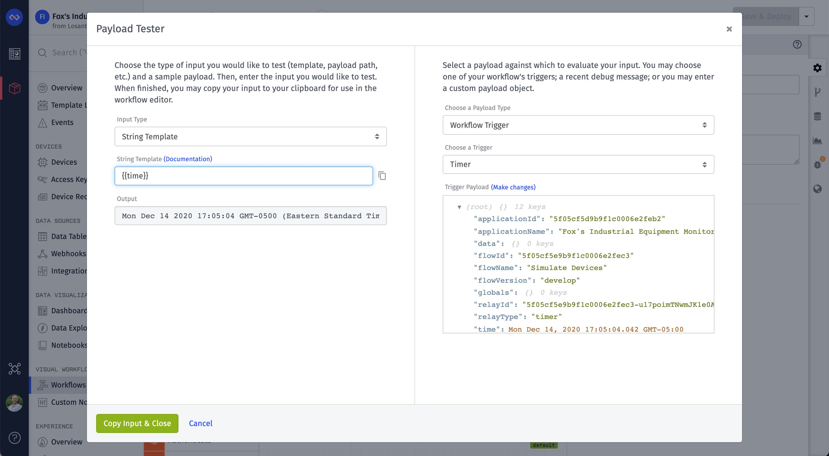

The Platform Template Tester is an interactive tool that provides a way to easily debug and test Losant's Template Engine while building workflows.
Platform Template Tester Preview

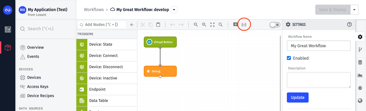

Workflow Editor Toolbar​
Select the Template Tester Icon that is located in the Workflow Engine toolbar:
Workflow Editor Toolbar Template Tester Button

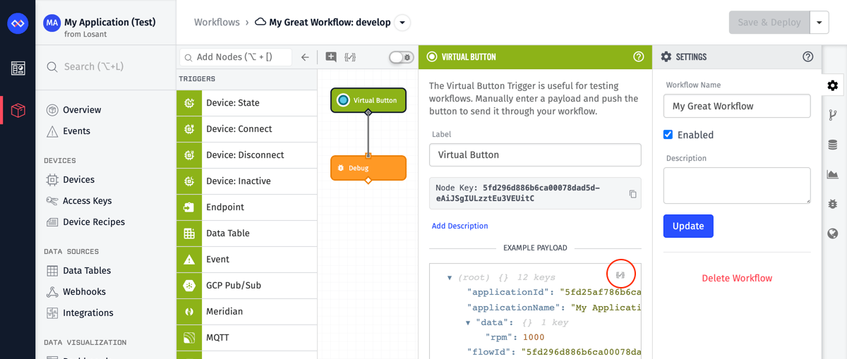

Workflow Trigger Editor​
Select a Trigger in your Workflow to open the Trigger Editor Panel and select the Template Tester Icon in the Example Payload configuration:

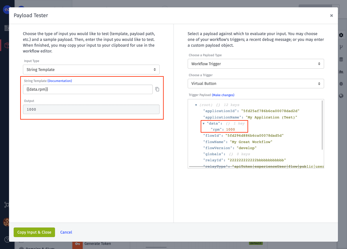

String Template​
Choose “String Template” from the “Input Type” select menu. Enter your string template into the "String Template" field. Observe the results located in the "Output" field.
String Template

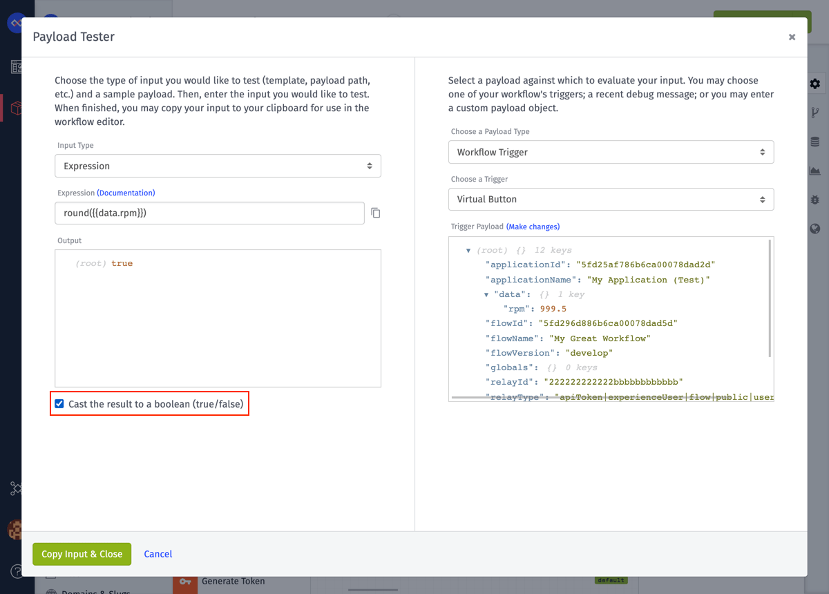

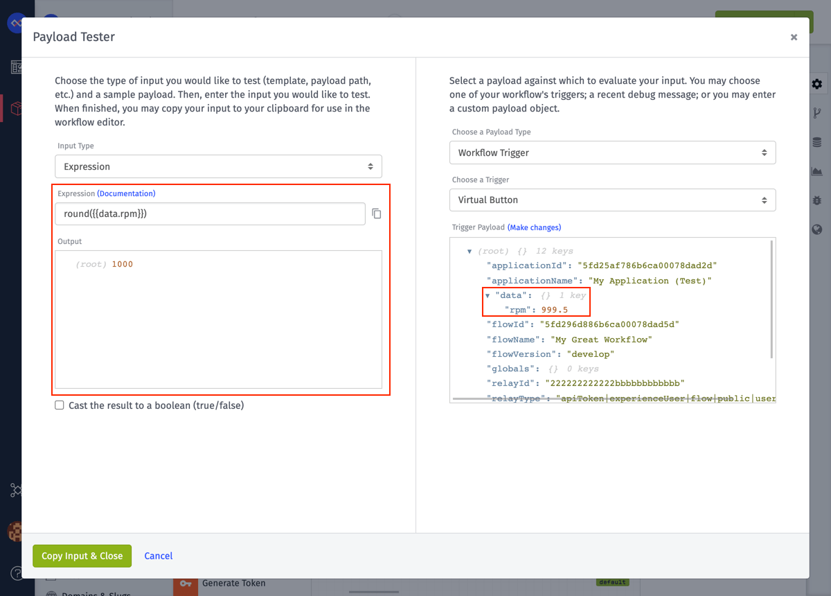

Expression​
Choose "Expression" from the "Input Type" select menu. Enter your expression into the "Expression" field. Observe the results located in the "Output" field.
Expression
You may cast your result to a boolean value by clicking on the "Cast the result to a boolean (true/false)" checkbox.
Expression Cast to Boolean

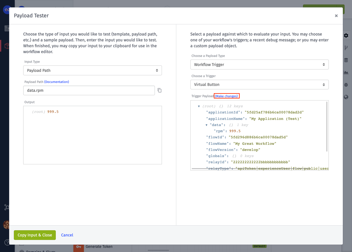

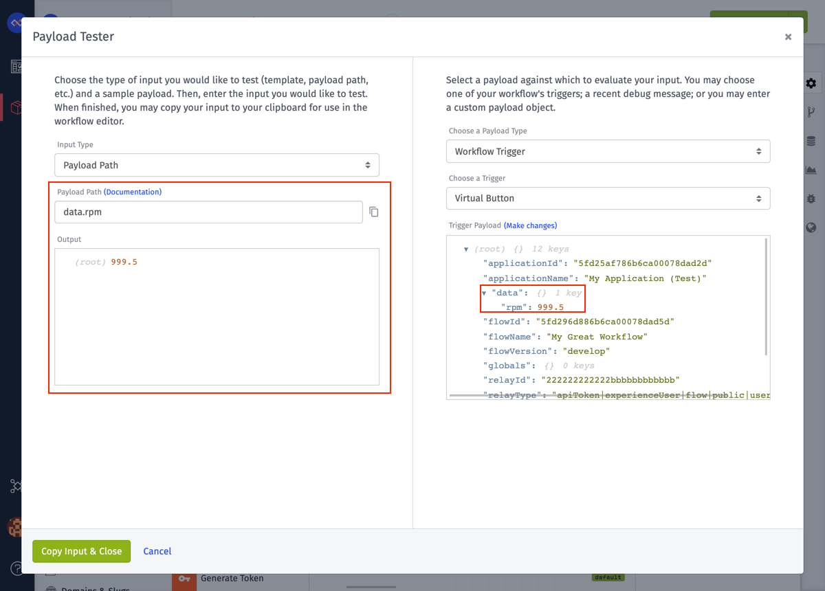

Payload Path​
Choose "Payload Path" from the "Input Type" select menu. Enter your payload path into the "Payload Path" field. Observe the results located in the "Output" field.
Payload Path

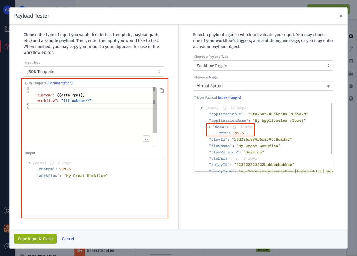

JSON Template​
Choose "JSON Template" from the "Input Type" select menu. Enter your JSON Template into the "JSON Template" field. Observe the results located in the "Output" field.

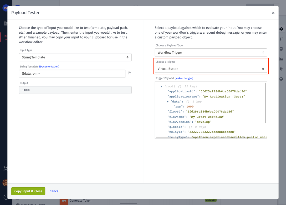

Workflow Trigger​
You must have one or more Trigger in your workflow. Access the Platform Template Tester with either of the following methods:
Select "Workflow Trigger" from the "Choose a Payload Type" select menu if it is not already selected.
When you have more than one Trigger in your workflow you may select the Trigger's payload from the "Choose a Trigger" select menu.
Choose Trigger
You can now test against the Trigger Payload using any of the following methods:

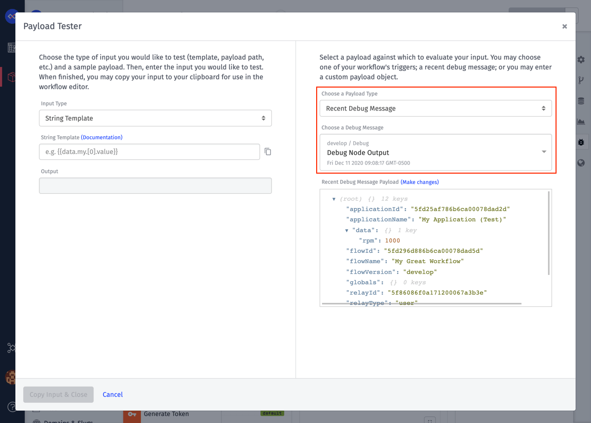

Recent Debug Messages​
You must have one or more Debug Message in your workflow. Access the Platform Template Tester with either of the following methods:
Select "Recent Debug Message" from the "Choose a Payload Type" select menu if it is not already selected.
Select your debug message from the "Choose a Debug Message" select menu.
Debug Message Payload Type
You can now test against the Debug Message Payload using any of the following methods:

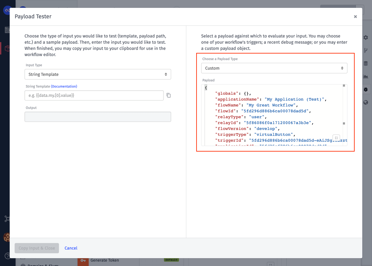

Custom Payloads​
It is not required to have any Triggers or Debug Messages in your workflow. However, it certainly helps create a "Starting Point" for your Custom Payload if any of them exist in your workflow. Access the Platform Template Tester with either of the following methods:
You can either select "Custom" from the "Choose a Payload Type" select menu or you can click on the "Make changes" link in the Payload section.
Custom Payload Type
Custom Payload Make Changes
Create or edit your payload within the "Payload" field.
You can now test against the Custom Payload using any of the following methods:
