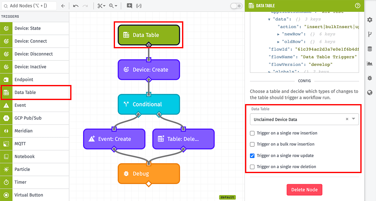

Data Table Trigger
The Data Table Trigger fires a workflow whenever a row is added, updated, or removed from a given Data Table.
Data Table Trigger
There are two configurable properties for the Data Table Trigger ...
Data Table​
First, select which Data Table the trigger should fire on when one or more of the selected actions is applied to the table.
Trigger Actions​
Next, choose one or more actions applied to the Data Table that should fire the trigger. At least one action is required. You may fire the trigger on the following actions:
