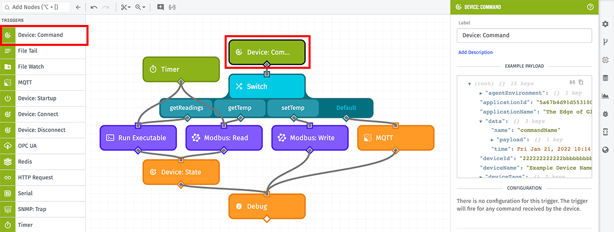

Device: Command Trigger
The Device: Command Trigger fires a workflow whenever the Edge Compute or Embedded Device executing the workflow receives a command.
The Device: Command Trigger has no configuration. When a workflow with this trigger is deployed to a device, the workflow will fire on receipt of any command sent to the device.
Payload​
The payload for the Device: Command Trigger differs slightly between Edge Workflows and Embedded Workflows. For both workflow types, the payload's data object contains the following properties:
  • name: The name of the command that was sent to the device. Since the trigger fires for all commands, most users follow up the trigger with a Switch Node or a Conditional Node to take different actions based on this value.
  • payload: An optional value sent in the command. This can take a number of shapes: a JSON object, an array, a string, a number, or a boolean. This often includes additional information needed to execute the command. For example, if a command with a name of "setTemp" is sent, the payload may include the numerical value of what the temperature should be set to.
  • time: The time at which the command was sent. For Edge Workflows, this is in the form of a Date object; for Embedded Workflows, the value is a number representing the time (in milliseconds) in Unix time.
