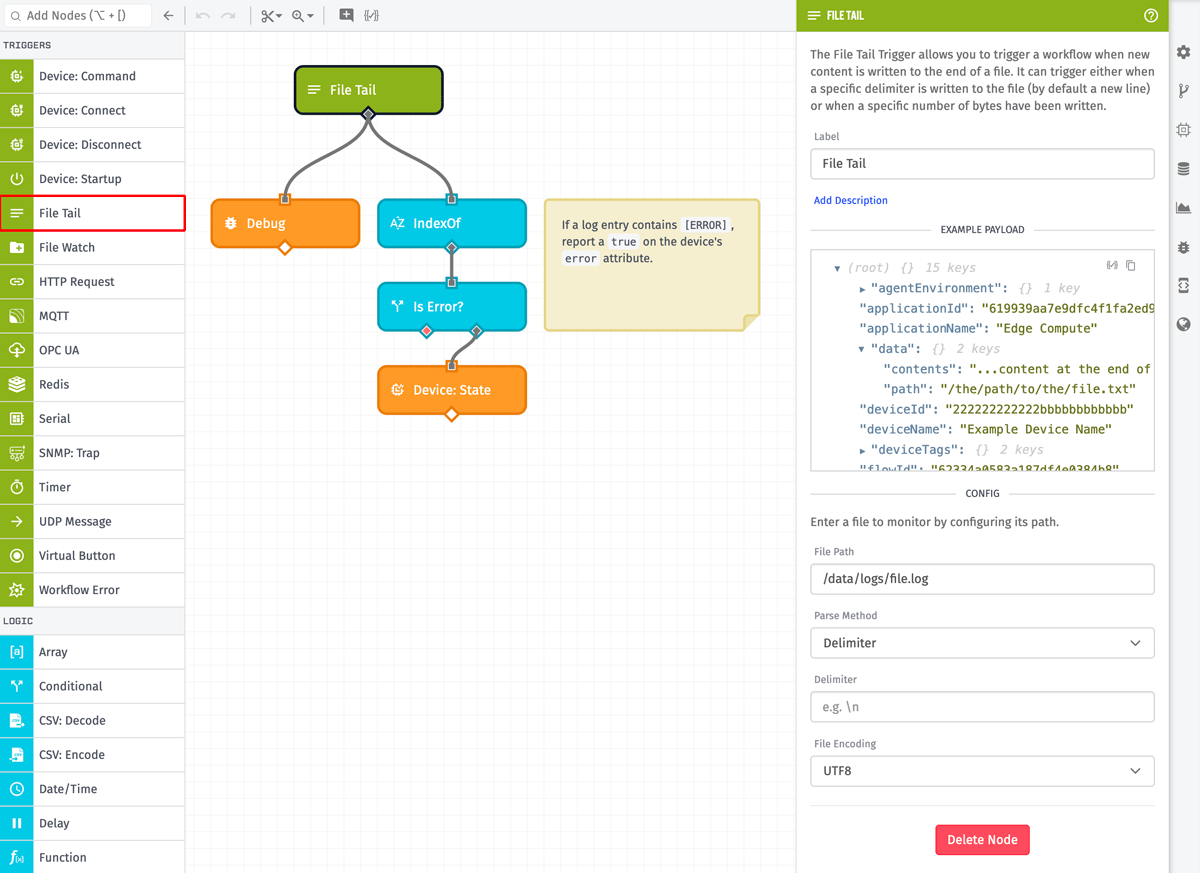

File Tail Trigger
The File Tail Trigger allows you to monitor and analyze logs and other files on the Gateway Edge Agent's (GEA) container or host file system. This trigger monitors new data being written to a file and fires a workflow whenever a configured delimiter or byte length has been reached.
In most use cases, this node works similarly to the Linux tail command when using the -f (follow) option.
