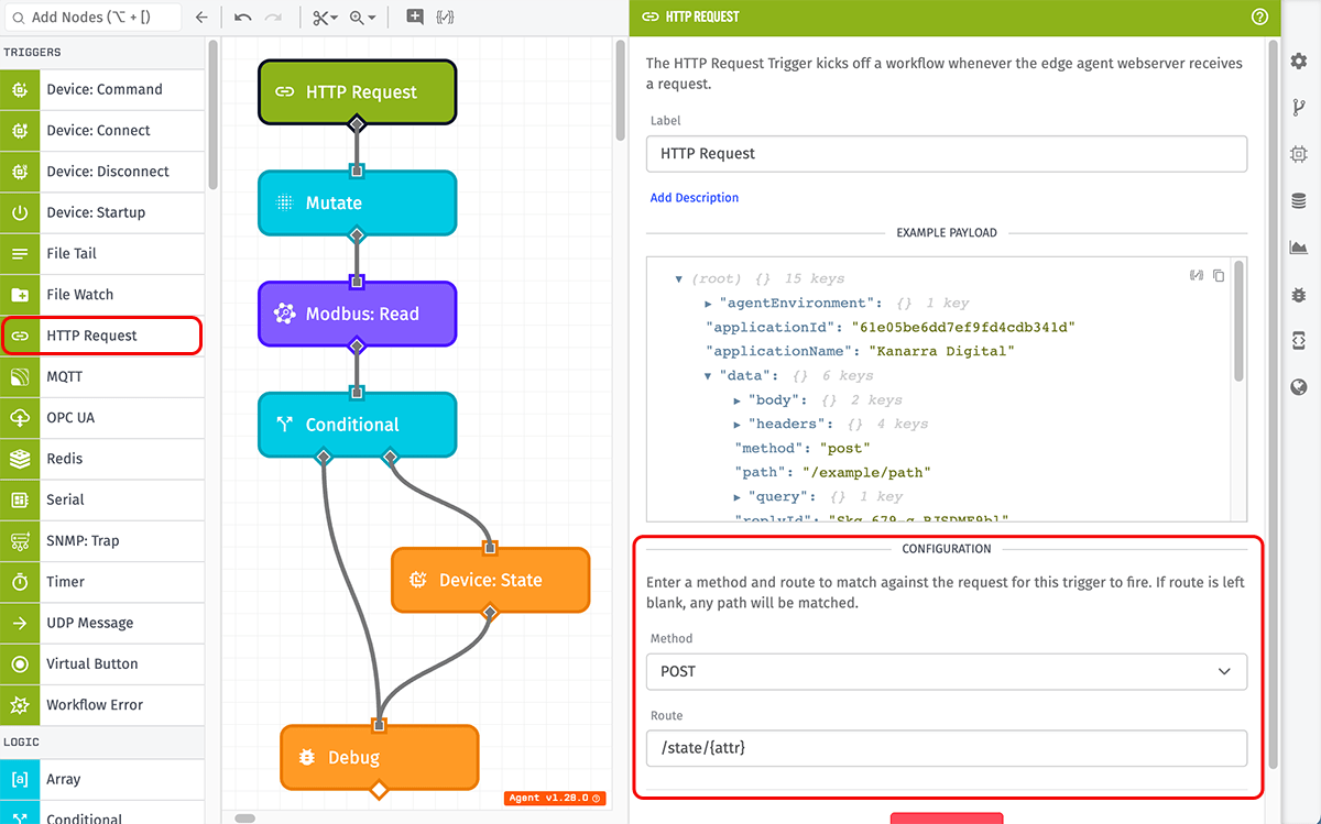

There are two configuration settings for the HTTP Request Trigger: Method and Route.
NOTE: Prior to Gateway Edge Agent v1.24.0, this trigger had no configuration. For those agents, this trigger always matches any incoming request on the local web server.
Method​
This is the HTTP method the request should match. Currently, we support these methods: GET, POST, PUT, PATCH, DELETE, OPTIONS. To have the trigger match any request method, choose Any Method (this is the default behavior).
Route​
The route is the URL path, or the part after your local server's domain. If your local server's domain is http://localhost, the route is everything after that. It always starts with a slash / and may contain a series of static and parameter segments separated by more slashes.

The payload for a workflow triggered by the HTTP Request Trigger will include all of the information about the triggering request in the data field. This includes the request path, the request method, any request headers, any request query parameters, any parsed path parameters (based off the route definition for the trigger), any cookies, and the request body. If there is no body present, the value for the body field will be null. Otherwise, if the content type is multipart/form-data, application/x-www-form-urlencoded, or application/json and the request body is valid for that content type, it will automatically be parsed into an object. For other content types, such as text/plain, the body will be left as a string.
Below is an example payload with a request of POST /foo/bar?bat=baz and a body value of {"answer": 42}. The HTTP Request Node is configured with the "Any Method" option selected and Route set to /foo/{endpoint}:
